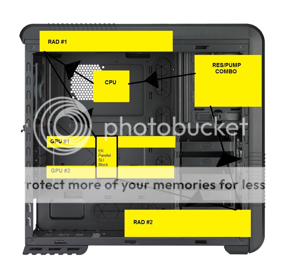

Just drawn up my loop order and wondered if you could give it the once over and advise on any changes required....
RAD #1 Hardware Labs Black ICE Radiator GT Stealth 240 http://www.overclockers.co.uk/showproduct.php?prodid=WC-004-BX
RAD #2 EK Coolstream RAD XTX 240 http://www.overclockers.co.uk/showproduct.php?prodid=WC-160-EK&groupid=962&catid=1523
These rads are cooling the following;
2 x Gigabyte GTX670 Windforce 2048mb cards fitted with Ek 680 reference blocks and backplates
1 x 3770k CPU clocked at 4.5gh
I'm using a XSPC 5.25 res with a XSPC Laing D5 pump http://www.overclockers.co.uk/showproduct.php?prodid=WC-061-XS&groupid=962&catid=2133
Heres the loop and thanks for your time....
I would swap the ends on both rad #1 & rad #2 to make the tubing routes shorter. (you don't need to have radiators inbetween blocks as it's an equilibrium) That would mean the order would become:
Res > Pump > Rad#1 > CPU > GPU#1 > GPU#2 > Rad#2
Otherwise, I can't really see anything wrong with it.

While you're exactly right there, Spooks. The best option from what I've heard is whatever gives you the shortest tubing routes. Less tube = Less distance for the loop to travel. It can be difficult sometimes to get the shortest routes but I've found that the right fittings (90/45 degree rotary's and whatnot) can help you shave off a a LOT of tubing because you don't have to curl it around just to get it to fit right.
This is the mistake I made and now I'm completely replanning my loop for when my GPU blocks get here and ordering more rotary fittings.
The reason people like to keep the loop as short as possible is to keep pressure drop to a minimum.
But bear in mind that (1/2 " tube) you'll get roughly as much pressure drop with one 90 deg fitting as you will with ~1 foot of tube.
So you need to be losing well over a foot of tube to benefit from replacing it with a 90deg bend.
The pressure drop per 90 deg bend or ~foot of 1/2" tube is 0.02 psi
In my opinion the amount of gain or loss either way is just not worth the effort. Unless of course you have a seriously weak pump.
Just plumb it so there are no kinks and its neat.
