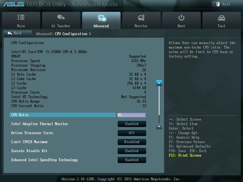

Had to reinstall Windows recently and lost my overclock settings. I managed to get my overclock back after some googling but I've lost the correct Intel Speedstep functions in the Bios. I've tried enabling Speedstep but I must be missing somethnig because my i5200k is not ramping down when idle. It's just stuck at 4.5GHz all the time. System is stable but I don't want my CPU maxed all the time.
What settings do I need to tweak in my BIOS to get Speedstep working again? My hardware is in my sig but if you need more info I can post it up. I have the ASUS UEFI Bios on my Mobo.
It's enabled but still not working:

Ok, tried the above and still not working. Here's what settings I have now:

Sorry I uploaded the wrong Screenshot. I've edited above post to show my current offset settings.

Wazza, look again at Post8 as I have edited it, the first image, It shows the offset I have just added. Is this right?
ahh yeah that's right,is it downclocking now?
