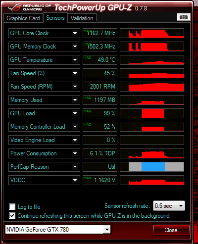

Hi all
Can someone tell me what is happening here.
My card only uses about 30% of its memory when benchmarking/gaming. My card is slower in all benchmark scores than other makes of GTX780's. is there something I need to do to get it to run at full capacity? I have tried changing settings in NVidia control panel and change windows power management to performance mode but to no avail. Here is a ss of the max readings while running heaven 4.0 benchmark it shows the maximum usage on the card. It clearly shows memory usage as only 1200mb, what is causing this.
Is this normal?
Yes it is normal, the amount of memory used is what heaven used only and that 1200mb is all it needs, If your worried about the card under performing it would help if you post in the benchmark threads, As a lot of 780's in those benchmarks are overclocked.

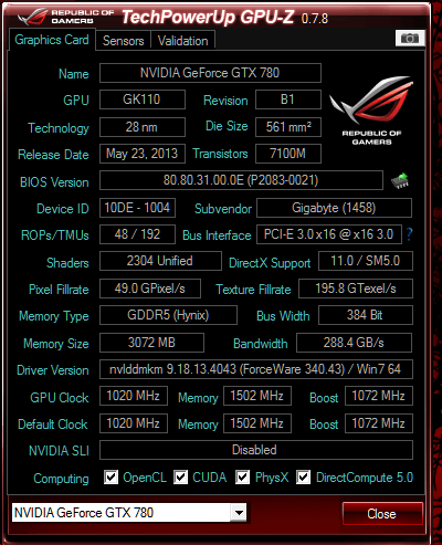

Hmm that fan speed seems a bit high for a 780 GHZ - whats the temperatures hitting middle of heavy benchmark? though judging from the core speed graph its not overheating and thermal throttling which would have explained the poor scores.
Most of the Heaven 4 benchmark results will have been done on older drivers so its possible 340.xx are poor performance drivers for Heaven maybe.

Yea and ofcourse overheating
Was wondering about it but there is no sign of the boost dropping out in the core speed bit of the graph. Would be interesting to know the GPU temp mid benchmark though as those numbers seem a bit high compared to my experience.
Also PerfCap shows no throttling due to temperatures only the normal voltage limit to the boost.
Looks like I underestimated the affects of the current weather - mines getting upto almost those levels (a lot higher than usual) with the current ambient temps. (Peaked at 70C mid run instead of the normal 66C).

hi all....the card is not overheating, max temps running heaven 4.0 was 49 degrees. Fan speed was high because I set it high in my fan profile I do not have an unstable overclock as I get similar results even when not overclocking. For some reason my card only uses a third of its memory when gaming or benchmarking

Also @ rangerjr1 are you saying all gtx780's are the same and so perform the same? Mine is the gtx780ghz edition which comes pre overclocked in other words it cant be the same core as all other cards as it is different from a gtx that is not oc from the start....I have overclocked a bit more on top of the factory oc and when I benchmark it, in no matter which benchmark I use...it performs well below other cards owned by people in these forums hence my comment that my card is maybe a poor performer.

A program will only use the amount of VRAM it needs to store the data in its using to render from. The percentage of VRAM used on its own doesn't have any implications on performance (unless you hit the max VRAM available). Its like the storage on a HDD just much quicker for the GPU to access data it needs to read frequently from the VRAM rather than HDD - most of the level load time in a game is just uploading files from HDD to VRAM.
i.e. a mesh is just a collection of x,y,z coordinates (and some other information in regards to what textures to use, etc.) and this is what is being stored in the VRAM.
A program will only use the amount of VRAM it needs to store the data in its using to render from. The percentage of VRAM used on its own doesn't have any implications on performance.
