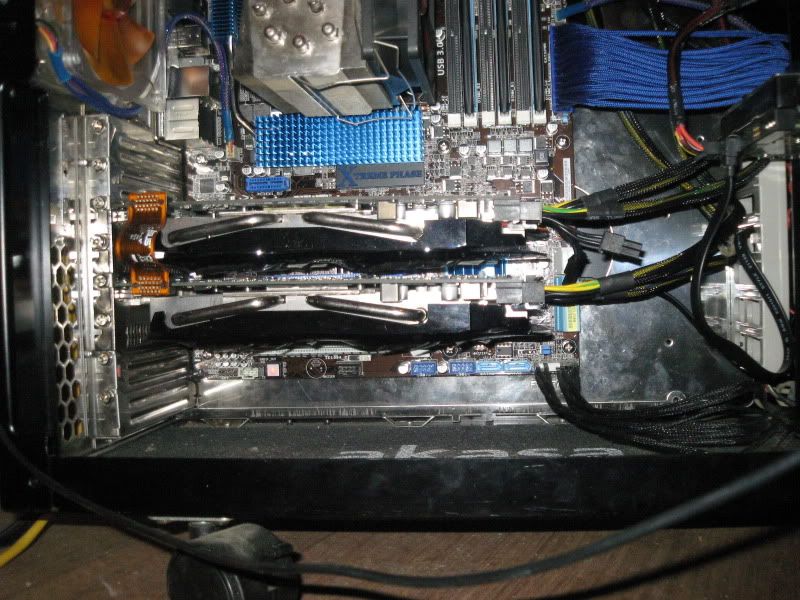

The spotcool works well with multi gpu setups. But, due to running dual monitors your still gonna get high idle temps. Im on a single screen. Due to board spacing, the topmost card will run higher because the airflow is impeded by the bottom card.
Gtx 470's with spotcool.
Running gtx 460 sli in another machine, very closely spaced, therefore a lot warmer than the 470's. Which have a reputation for being notoriously hot.
460 sli
That is what I found with adding the full size GTX285 into the mix.....the top card was still suffering high idle temps...but the load temps increased as well.
I have an added 1200rpm 120mm fan blowing cool air directly onto the GPU already.....with a reduction of around 5c-8c on the idle temps, but they are still 10c-15c above the downclocked idle....
I am hoping a low profile card driving the second monitor will negate both issues.
