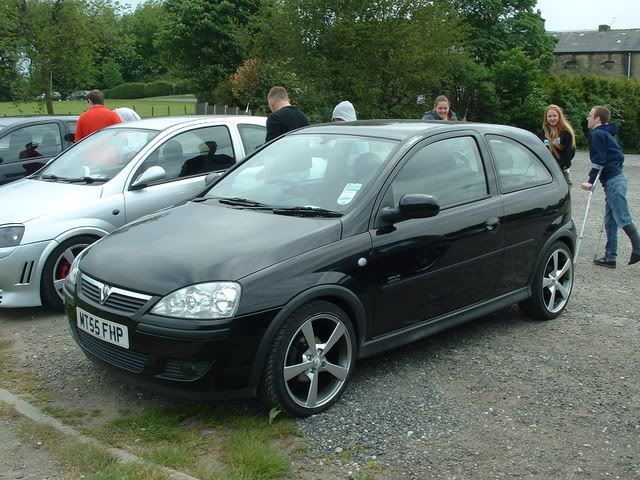

In all honesty i can see what you mean by it not looking any different from the stock springs!
Hopefully it'll settle. It's quite low to begin with. Certainly not as bad as stock Ford cars.
The lights are standard on some corsas, just the way the pitcure has been taken.
Looks a decent ride height. £177 is steep though. Can get a set of Ebiach springs for the Astra for £140.
Should see Rover 200/400s with stock suspension!!
:eek: :D is all I can say.
