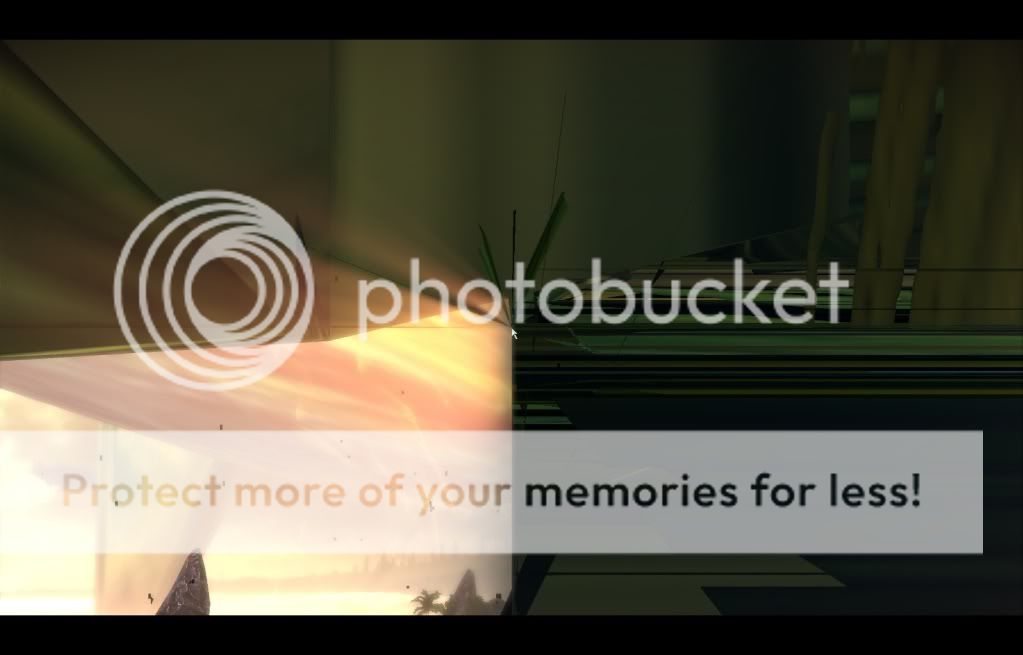

Only recently this has been happening, but on every game it would load fine for a moment, looking nice, then bam the screen goes mental, all games glitch like the picture below, before freezing then it's alt + f4 time. I returned my GPU and CPU back to stock speeds...still not working, I did update the nvidia driver recently, re-downloaded it as I thought it was bugged. Didnt help. Please advise!

This is a sign of core failure, but at the same time, this can also often be seen in DirectX problems/Driver problems/Game incompatibility. Make sure to rule those out.
I would personally start off by running the error check function of OCCT, if nothing shows it's probably not the card.
If it helps, I've seen the same artifacts alt tabbing Far Cry 2, on two different cards. :)

Bulletstorm, before main menu loaded, artifacts on the right then it completely froze.
This happened after VT4 froze, happens after EVERY game is loaded...
This is the worst I've seen, VT4 Main menu before crash.
