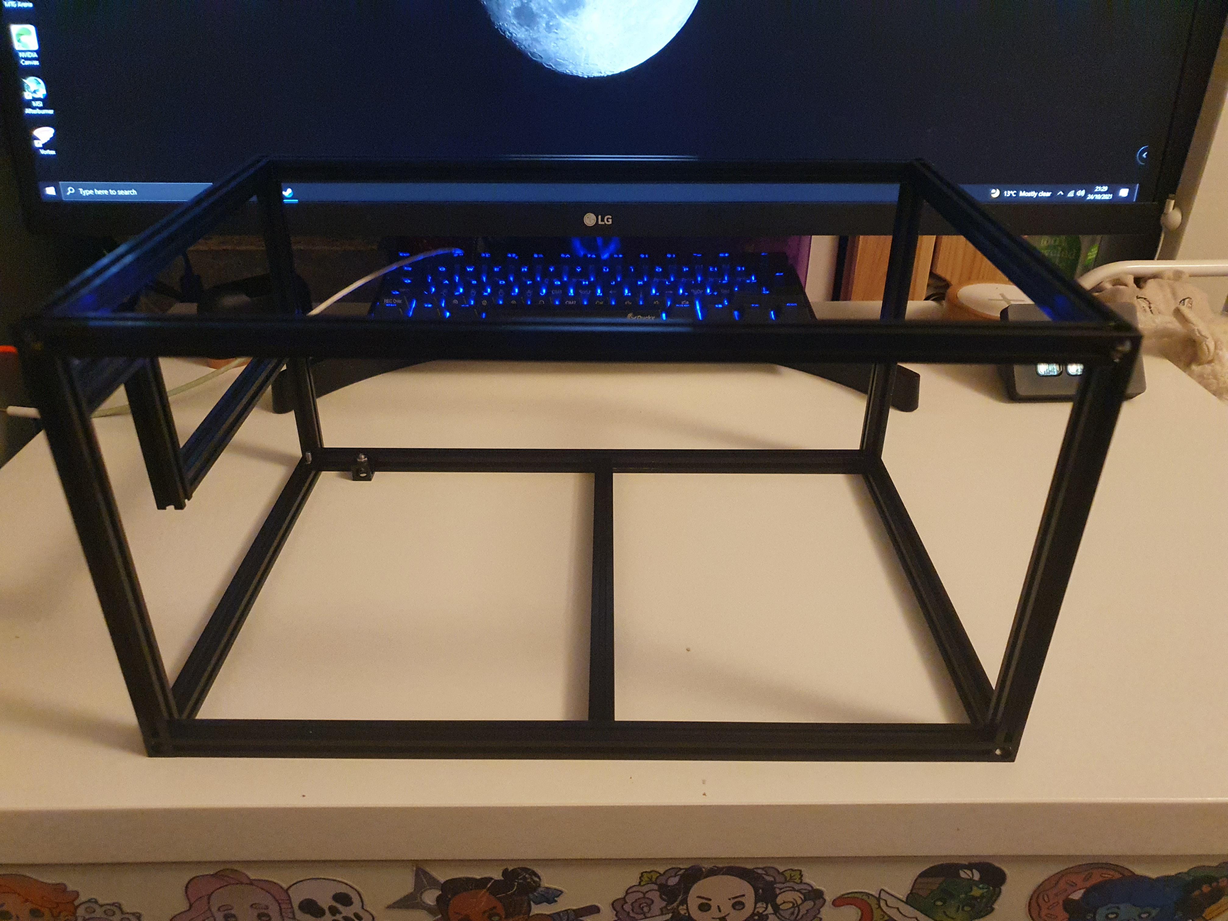

First little play last night.
Can you guess what it is yet?
I made a case out of generic t-slot extrusions, which is basically the same stuff. It's absolutely great for putting together boxy things with very little effort required.
30mm. Strong enough that it's safe to stand on. Well, safe for the case, not for me given the wheels on the bottom.
How light is it? Are they aluminium?
Might try something like this for my next proper case, be good designing your own case using these + acrylic panels.
It's 14.7kg for the case alone. I thought that was pretty heavy when I built it, but modern commercial full-tower steel cases can be even heavier. The extrusions are aluminium. I have an article about it on my website if you want to read more.
Nice will have a read up on it on your website tonight. That's surprisingly heavy! I would've though it would have been much much lighter than that.
A lot of the weight is from the 30mm extrusions, which are much stronger than they need to be. I would have used 20mm but the choice of connectors was better at 30mm. The 10mm that Makerbeam uses is probably more appropriate for a PC case, though it doesn't look strong enough to be able to sit on the case.
