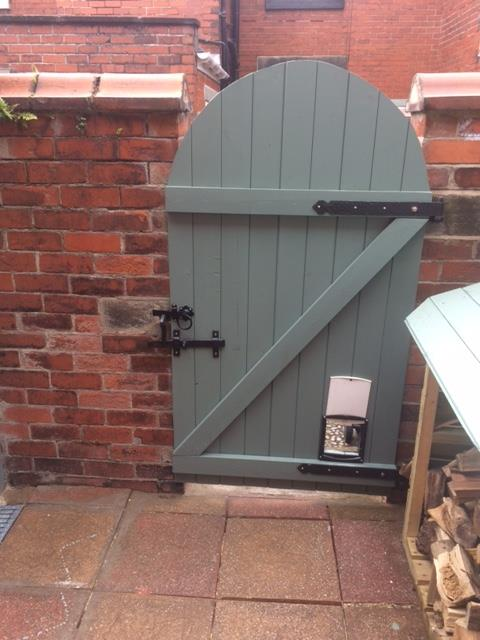

The photo above is of a very nice looking gate. The once criticism would be that the brace should start at the bottom hinge and go up and out to the latch side. That way the natural sag places the brace in compression and reduces the droop over time. On such a small gate it’s less of an issue the bigger and heavier the gate the more important this becomes.
Ah interesting, i didn't know that.
I think the previous gate was as you mention but i had already cut the cat flap i think so my hand was forced!
