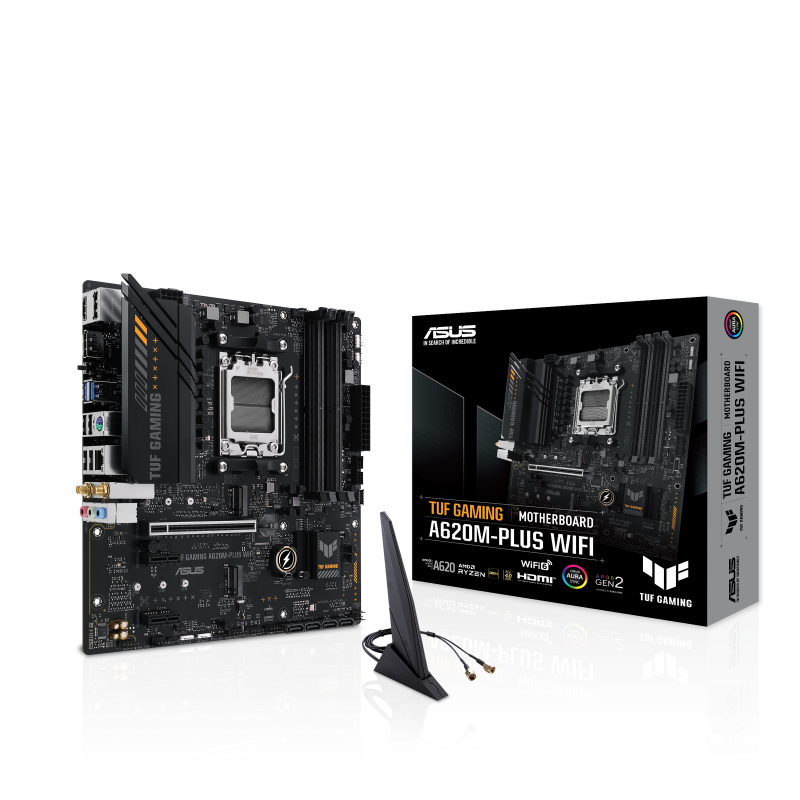

Hi.
What case Do you have and do you need a matx motherboard , WiFi needed ?
Assuming the above here's some options on the budget side , I've also put the 7600 in there to show the price difference dropping to it will save £50.
My basket at OcUK:
Total: £807.94 (includes delivery: £0.00)​
This would be my go to. Just prefer the b650 chipset and for the little extra go for the cas 30 ram while saving the money on the older and barely slower 7600.
