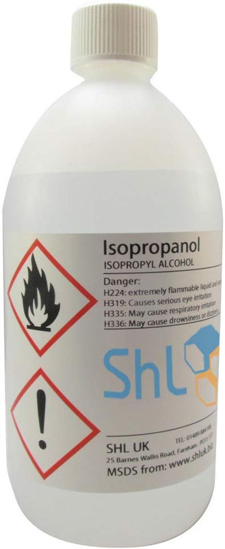

usually it says what the purity is , last one I bought did, but since it doesn't say it's rubbing alcohol, or diluted, must be high 90s
1 x SHL 1 Litre (1000ml) Isopropanol Isopropyl Alcohol 99.9% (IPA) CHILD PROOF CAP £6.69
don't know where these folks are picking it up for peanuts
I also have 4 litres of 99% IPA. Have it for cleaning electronics and computer parts. Always wondered if this was possible. How did you get glycerol?
I got a litre of glycerine a month or so back before everyone went nuts you can still get it on the rain forest.

Seem no longer in stock, I got 1L left.
SHL BRAND ISOPROPANOL IPA Isopropyl Alcohol 99.9% Pure (1 Litre) 1000 ml
