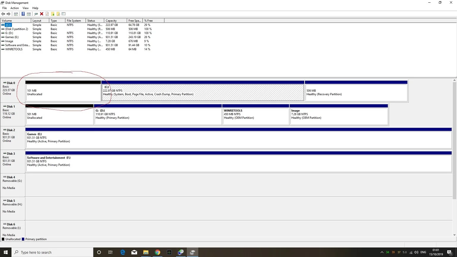

So i was trying to clear and format an old drive however i mistakenly selected the wrong disk and set my EFI system partition as a data partition...
It now says 101mb unallocated... i haven't restarted my machine yet so i dont know what affect it will have... but judging with what i've read, it will probably not boot.
Is there anyway i can recover this?
Disk 0 is what i accidentally deleted, circled. Ignore Disk 1.. that's what i was trying to format.

Hmm odd one this, so i restarted my pc expecting it not to boot but low and behold it booted straight back into windows... no problems... but i still have a 100mb of unallocated space?

I had 2 other drives connected at the time, i have disconnected those to try this theory but it still boots just fine... Still can't explain why i have a 100mb unallocated space that was supposed to be my EFI partition.
Weird ey.
