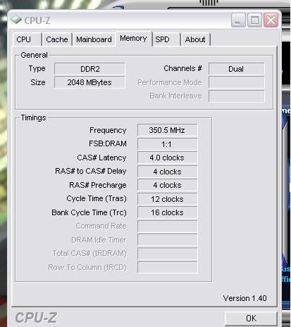

hey i have this memory
http://www.overclockers.co.uk/showproduct.php?prodid=MY-124-CS
any1 no what the stock volts are or how i would find out? currently in bios its set to auto, and if i change it, it wants me to set the volts.
this what its at at the mo
but running at ddr2 750, instead of 800.
it lets me set the speed to 850 but fails on orthos blend after 2 seconds.
so im thinking it needs more volts to run at that speed.
mobo is p5w dh deluxe.
I run mine@486Mhz 4-4-4-12 using 2.2v .24/7. Although they will do over 500Mhz at the same timings no problems ;)
Rob
2.3v is the most I would put through it. You may need active cooling at that voltage.
