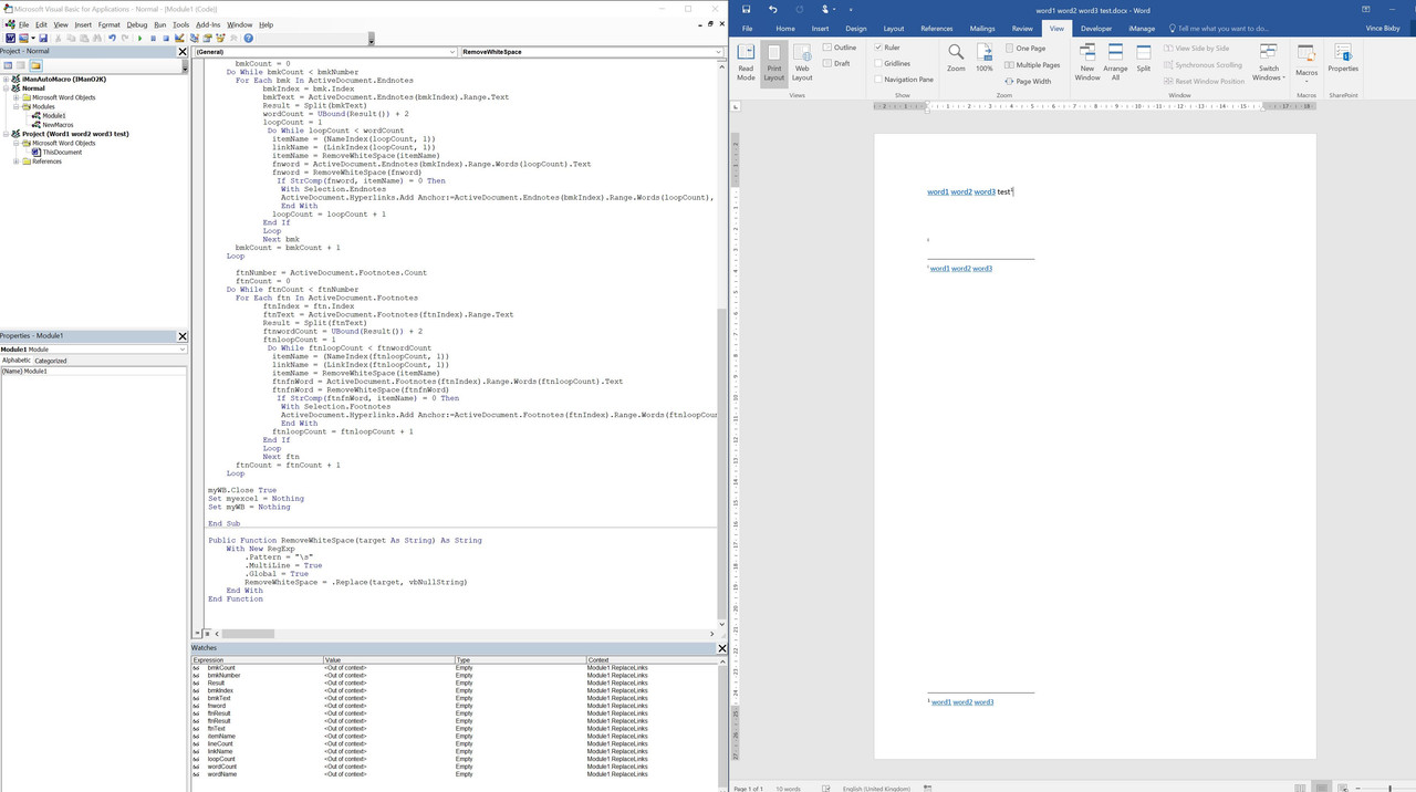

Got a bit carried away doing other stuff but this works:

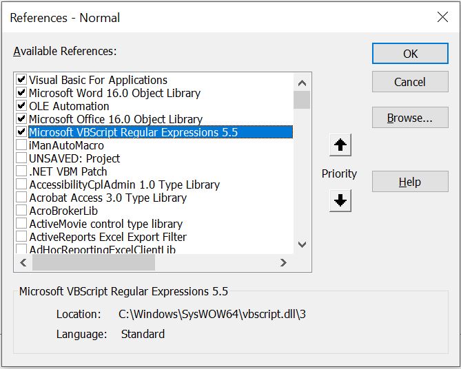

There are a few things you will need to do, first add the reference to regular expression 5.5:
Then you will need to set the two ranges in the code in the spreadsheet. Finally set the value at the number of lines in your excel spreadsheet. (you could just check the size of the range here but its late and im being lazy). Oh and also save that as an xlsx.
I tested it using your spreadsheet and a document with a few words in it:
You could also slim out the multiple increments as they are not nessesary and declare the variant i forgot to but to be honest it works so just have a play with it. If you want the test files let me know.
Oh and I know I said just loop through once and compare to the whole array would be more efficient but I couldn't get my head around it quite as easily so this is what you get :cool:

Call me sad but I enjoyed spending 45 mins confusing myself :) If I wasn't as tired as I was I probably would have noticed much sooner that the word object model loves to put white space before and after the words so my vbcompare wasn't working as it should, hence the regular expression to trim white space.
Hey, got it working for body text (inc replacing the row count with some code check the last cell in range), but it doesn't change footnotes i'm afraid. If it helps, 99% of the links i need to add are actually in footnotes, so it wouldn't be the end of the world if this ONLY looked at footnotes (and would probably make it more efficient?).
Let me add the foot notes into the code. Might need a little bit as I have a dude just arrived to sort out some of my AV.

Whilst doing this, I started thinking it might actually be way better if this was structured exactly the opposite way...rather than having a macro inside a word file that calls a list from excel, how much work would it be to do the exact opposite, IE have the code inside an excel file that you then point at the word document?
Would this need a complete re-write, or could it be switched around reasonably easily? Sorry for ridiculous scope change, I don't know why I hadn't thought of it this way around as it's the excel file that needs to be specific format where as you should be able to offer this up to any word doc and it should work!
I'll have a look, shouldn't be much different to be honest. Just as you say the other way around. Not sure on the functionality referencing word from excel but I guess we both might find out. When this engineer leaves I'll have a little look.
Cheers! Getting it working on footnotes is a higher priority for me, and I'm not really getting anywhere with it :(
I made it work on the train on the way home :) I do need to add it into the code properly though. Ill have a little play! Also doing it the other way is also viable.
Right so that was much harder than I anticipated. But I managed to make it all work, only downside is that it is an extension of my original code. This code will work on footnotes, endnotes and main body text. it's not uber efficient and needs some tweaking in a few places but i've done pretty much all the major bug finding, there are a couple of cheeky ones left in there I am sure. I noticed for example that occasionally if you leave your cursor focus in the endnote or footnote while running the code that it can throw a bit of a wobblie so setting cursor focus in code might be a plan, also if you run the code twice on the same document it seems to somehow double up on hyperlinks? Might need to build a quick check in there to see if a link already exists... There are also some efficiency gains to be had / Mistakes to be corrected in this I am sure! It works though.
Remember yesterday when I said there were better ways? I think the method used for footnotes and endnotes might be a little bit closer to that much better way. you can also port the majority of the code to vba in excel if you fancy a bit of a challenge. In terms of practical use you can port this code into visual studio as a package alongside ribbon changes and force deployment every time somebody starts word, we deploy packages in this way to outlook and word all the time to deploy similar functionality to this to our userbase :) end result the people that write the documents finish, click the button, give it a quick check, save it into the dms and away they go. Mind you I do see how doing it the other way could mean you could just potentially be equally or even more beneficial. Anyway ill stop waffling:
Code:
Sub ReplaceLinks()
Dim myexcel As Object
Dim myWB As Object
Set myexcel = CreateObject("Excel.Application")
Set myWB = myexcel.Workbooks.Open("C:\users\vince\desktop\WordHyperLinkTest2.xlsx")
Dim NameIndex As Variant
NameIndex = myWB.Sheets("Data").Range("Names").Value
LinkIndex = myWB.Sheets("Data").Range("Links").Value
Dim wd As Range
Dim itemName As String
Dim wordName As String
Dim linkName As String
Dim bmkNumber As Integer
Dim bmkCount As Integer
Dim lineCount As Integer
Dim bmkIndex As Integer
Dim ftnIndex As Integer
Dim ftnNumber As Integer
Dim ftnCount As Integer
Dim loopCount As Integer
Dim ftnloopCount As Integer
Dim wordCount As Integer
Dim ftnwordCount As Integer
Dim bmkText As String
Dim ftnText As String
Dim fnword As String
Dim ftnfnWord As String
Dim Result() As String
indexCount = 1
lineCount = 1
' Loop through the main body
 Do While lineCount < 4  'Set as number of lines in excel spreadsheet.
      For Each wd In ActiveDocument.Words
            wordName = wd
            itemName = (NameIndex(indexCount, 1))
            linkName = (LinkIndex(indexCount, 1))
            itemName = RemoveWhiteSpace(itemName)
            wordName = RemoveWhiteSpace(wordName)
            If StrComp(wordName, itemName) = 0 Then
            With Selection.Words
              ActiveDocument.Hyperlinks.Add Anchor:=wd, Address:=linkName
            End With
            End If
            Next wd
      lineCount = lineCount + 1
      indexCount = indexCount + 1
    Loop
      bmkNumber = ActiveDocument.Endnotes.Count
      bmkCount = 0
    Do While bmkCount < bmkNumber
      For Each bmk In ActiveDocument.Endnotes
            bmkIndex = bmk.Index
            bmkText = ActiveDocument.Endnotes(bmkIndex).Range.Text
            Result = Split(bmkText)
            wordCount = UBound(Result()) + 2
            loopCount = 1
             Do While loopCount < wordCount
              itemName = (NameIndex(loopCount, 1))
              linkName = (LinkIndex(loopCount, 1))
              fnword = ActiveDocument.Endnotes(bmkIndex).Range.Words(loopCount).Text
              fnword = RemoveWhiteSpace(fnword)
               If StrComp(fnword, itemName) = 0 Then
                With Selection.Endnotes
                ActiveDocument.Hyperlinks.Add Anchor:=ActiveDocument.Endnotes(bmkIndex).Range.Words(loopCount), Address:=linkName
                End With
              loopCount = loopCount + 1
            End If
            Loop
            Next bmk
      bmkCount = bmkCount + 1
    Loop
      ftnNumber = ActiveDocument.Footnotes.Count
      ftnCount = 0
    Do While ftnCount < ftnNumber
      For Each ftn In ActiveDocument.Footnotes
            ftnIndex = ftn.Index
            ftnText = ActiveDocument.Footnotes(ftnIndex).Range.Text
            Result = Split(ftnText)
            ftnwordCount = UBound(Result()) + 2
            ftnloopCount = 1
             Do While ftnloopCount < ftnwordCount
              itemName = (NameIndex(ftnloopCount, 1))
              linkName = (LinkIndex(ftnloopCount, 1))
              ftnfnWord = ActiveDocument.Footnotes(ftnIndex).Range.Words(ftnloopCount).Text
              ftnfnWord = RemoveWhiteSpace(ftnfnWord)
               If StrComp(ftnfnWord, itemName) = 0 Then
                With Selection.Footnotes
                ActiveDocument.Hyperlinks.Add Anchor:=ActiveDocument.Footnotes(ftnIndex).Range.Words(ftnloopCount), Address:=linkName
                End With
              ftnloopCount = ftnloopCount + 1
            End If
            Loop
            Next ftn
      ftnCount = ftnCount + 1
    Loop
myWB.Close True
Set myexcel = Nothing
Set myWB = Nothing
End Sub
Public Function RemoveWhiteSpace(target As String) As String
    With New RegExp
        .Pattern = "\s"
        .MultiLine = True
        .Global = True
        RemoveWhiteSpace = .Replace(target, vbNullString)
    End With
End Function
