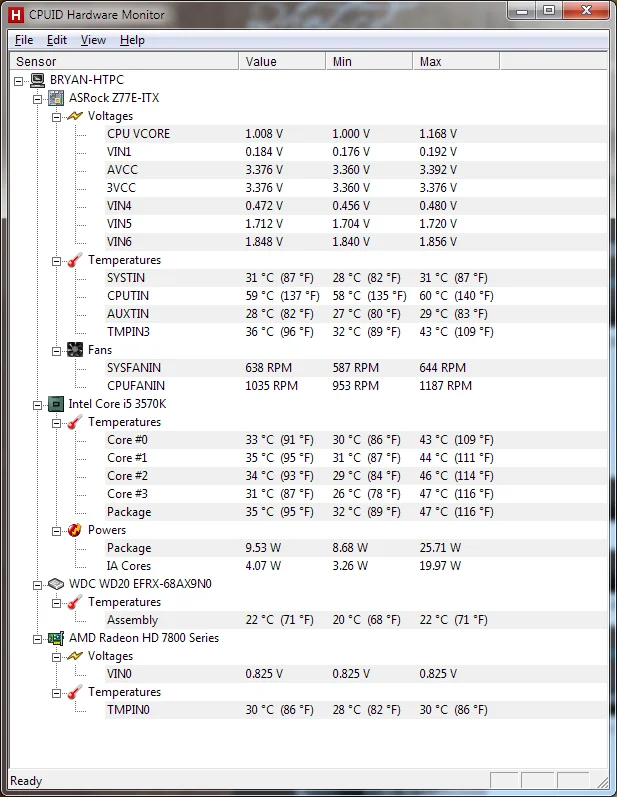

It's not the best, system temps are about 8C above ambient temp, it's aided by lots of ventilation at the rear however I wouldn't think about overclocking on air in this case. The Corsair H60 did fit but I did run out of patience with it and sold it on.

Temps after about 30 mins of general use, room is about 20C ATM.
I've found HW monitor reliable for all my kit, so I don;t see any reason to doubt it.

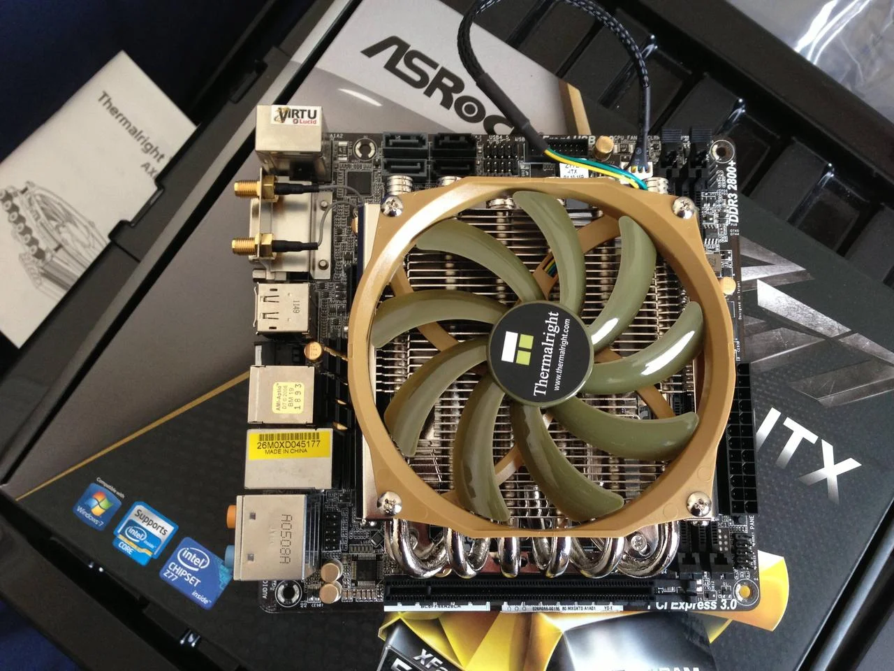

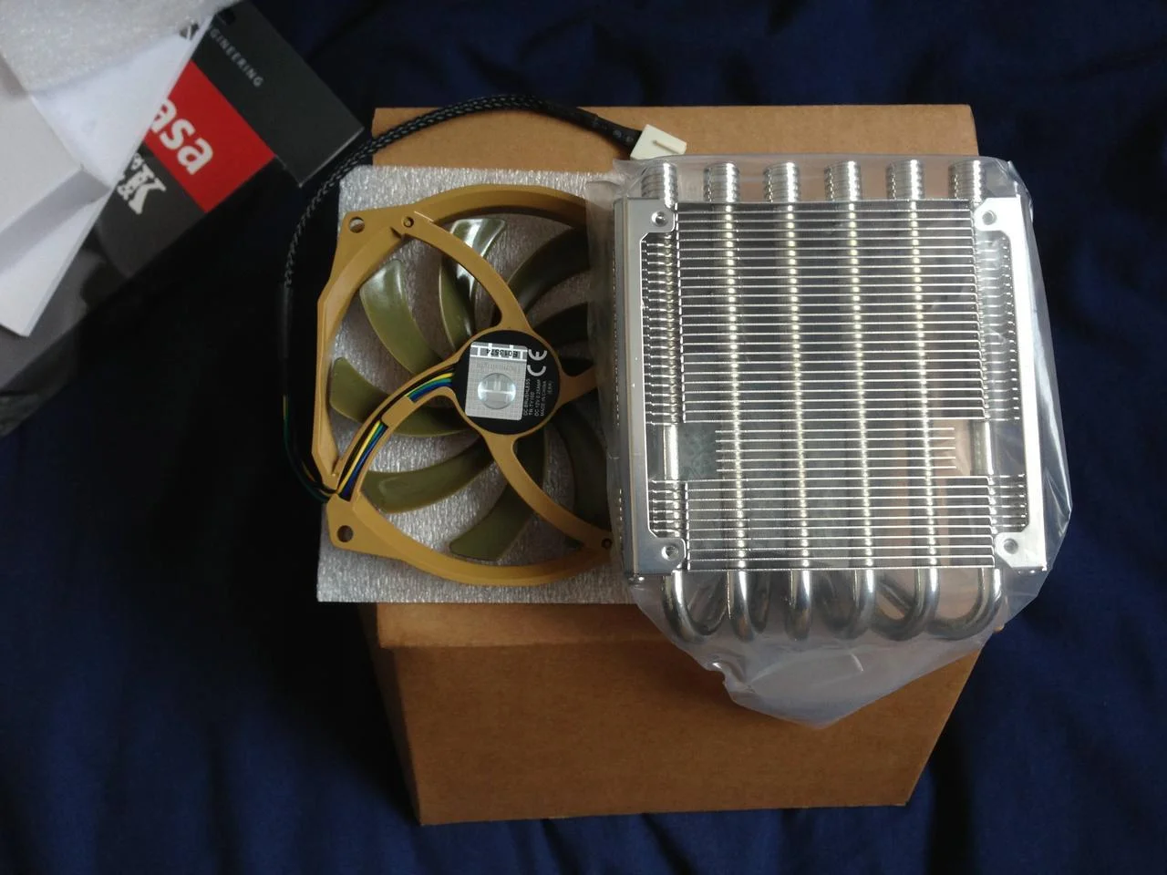

The Thermalright AXP-100 will be available soon however I can't see any type of air cooler being effective - especially when fighting the PSU fan. I've tried mounting the PSU upside down and the cables end up in an awkward position and swapping the fan around will just mean I'm blowing hot air from the PSU onto the CPU cooler.

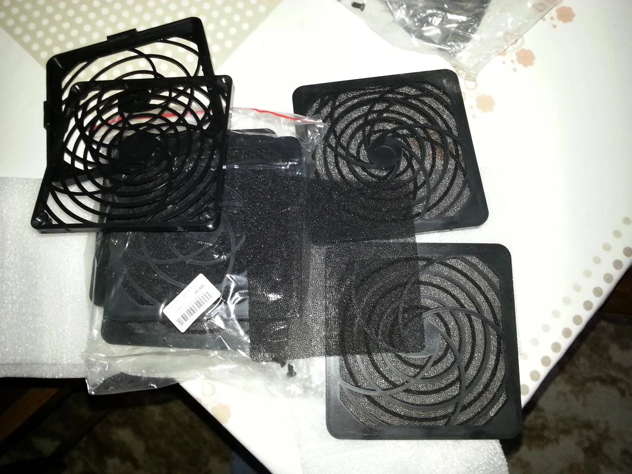

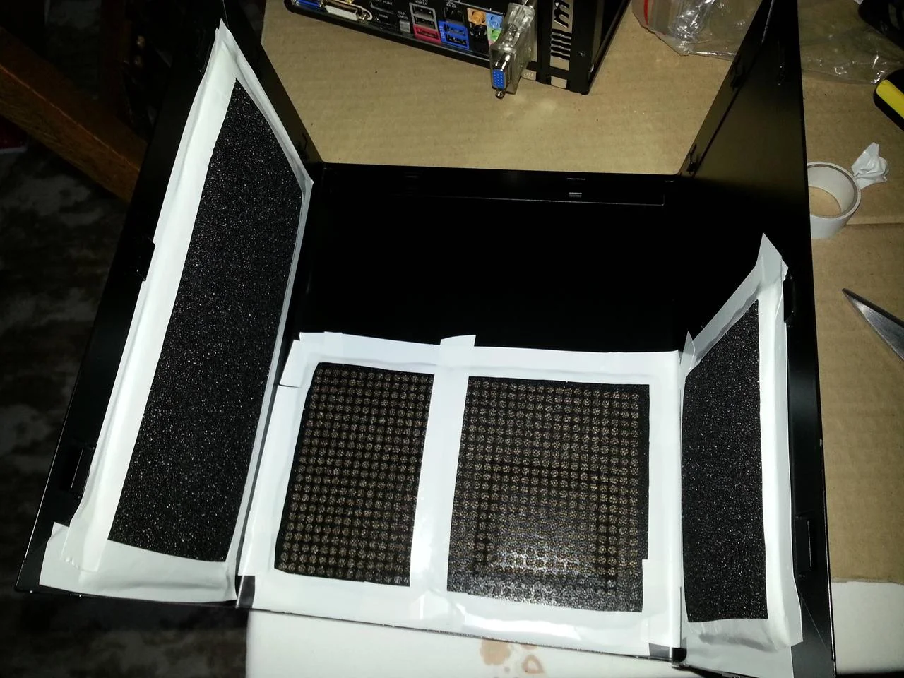

Got a load of these cheap:
Took the material out and covered the openings in the case
Hopefully this will stop the dust from getting in, temps up by a degree or so but better than everything getting caked in dust.

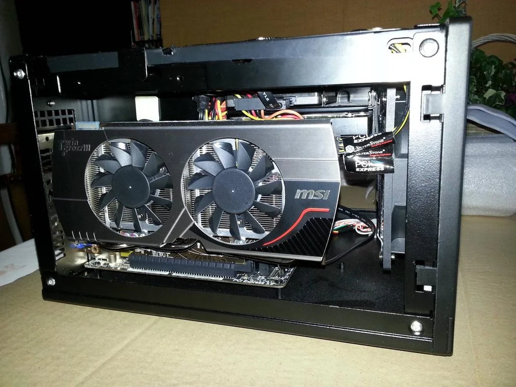

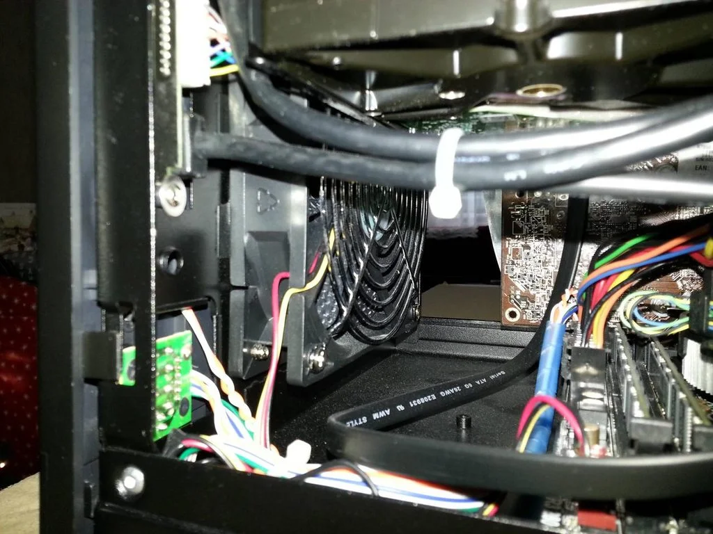

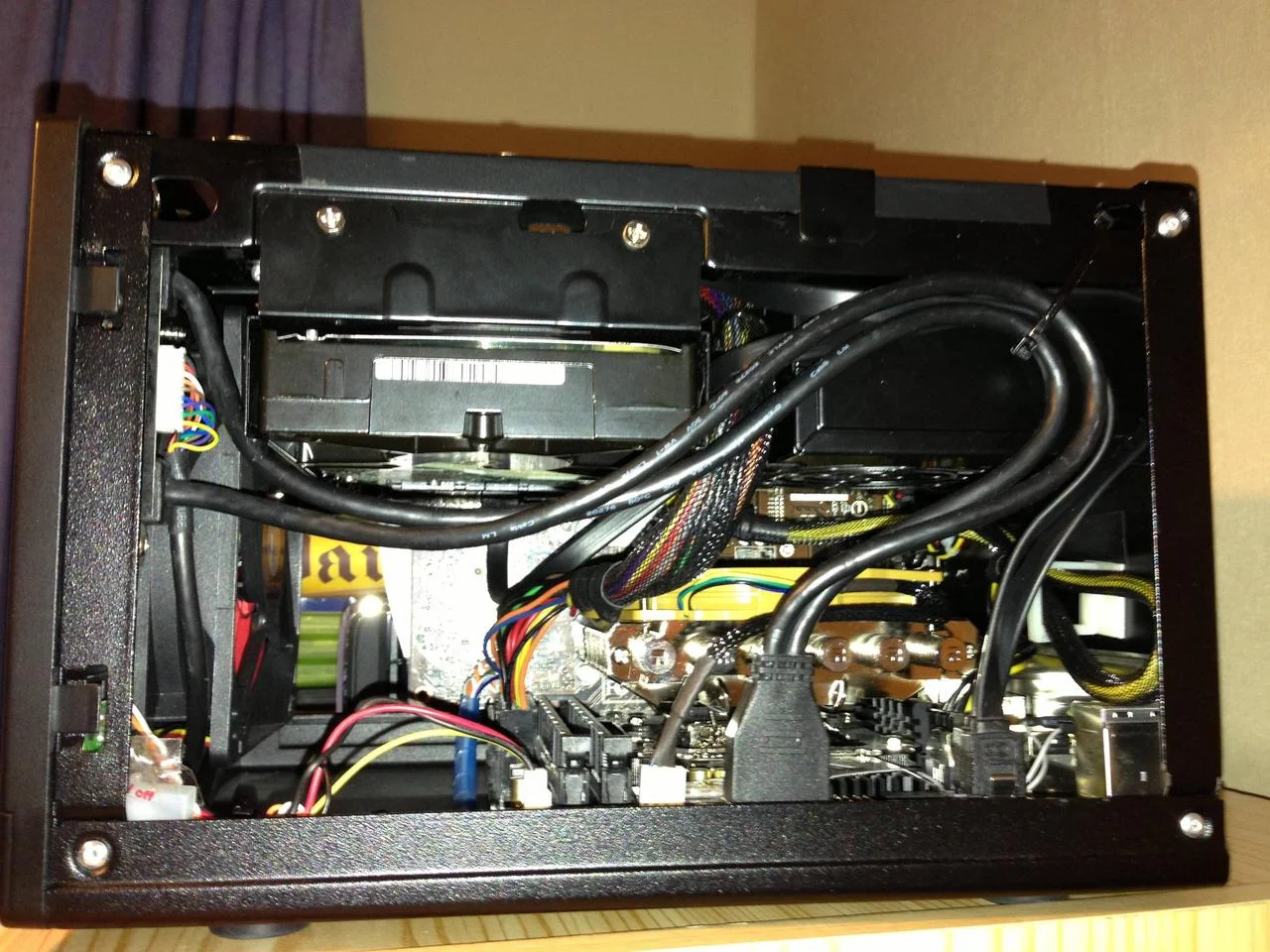

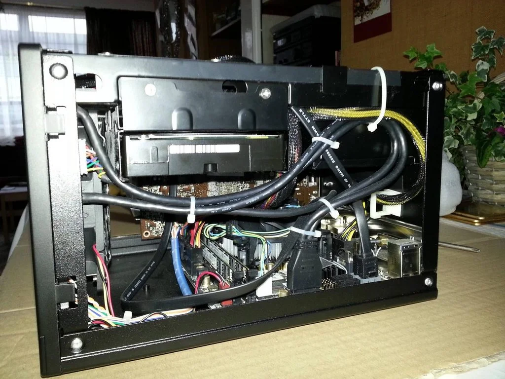

Some more pics of the inside, plenty of room really!

Dust filters a waste of time, increased system temps so ripped them out.
SSD had failed so I used this as a chance to rebuild and change a couple of things.
Stock cooler replaced with a Thermalright AXP-100 - a perfect fit for this board and case. Performs much better than the stock cooler and does not foul the PCI-E slot.

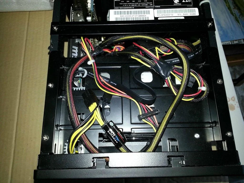

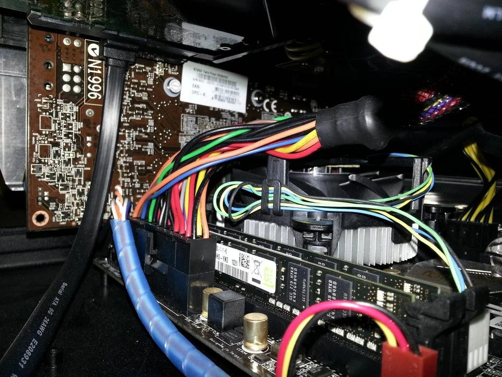

Got the cable management a little bit better.

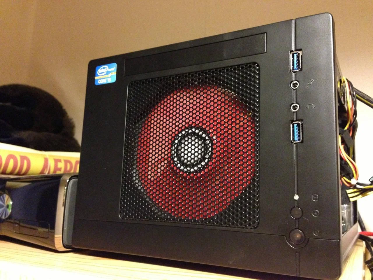

Replaced the stock fan with a Xilence XPF120R Red Wing, removed the stock dust guard too.
