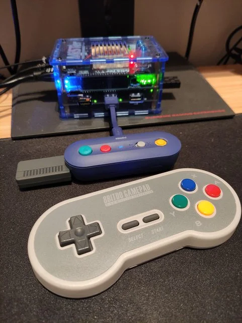

Got something new today, which whilst not 100% for MiSTer does seem to work very well with it. I've turned into an 8BitDo fan and have a number of their fantastic controllers and adaptors. Now I have added the G Bros. Wireless Adaptor.
Allows the use of Wii or GameCube controllers with Switch, PC, MiSTer and Linux/RPi etc. Over Bluetooth or USB. This opens up using NES or SNES Mini controllers too, as well as 8BitDo's SF30 2.4G Wireless Controller for the SNES Mini (as per my photo). Which as a 2.4G wireless controller will be slightly lower latency than Bluetooth variants and works perfectly with the SNES core as you would expect.
Very cool little device.
