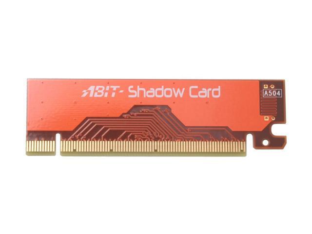

What do you mean by 'Blank' is that some kind of plastic insert in the vacant PCIe socket?

Ye, on the Nforce 4 there is a 'blank' that gets inserted into the unused slot if not running in SLI mode - lemme find a pic.
Ok, its called an Abit Shadow Card.
Hopefully the image tag will work.

Only reason I can think of is its to fool the mobo into thinking theres two cards in there.
Why you would need to do that, I dunno, maybe its an nvidia chipset thing. but ive never had an nvidia mobo, only intel.
Have you tried it without the 'blank' in? maybe you have to disable SLI at BIOS level or something if you do that?
Not sure - but it has to be in if the 2nd SLI slot is not used. The manual states not to reverse them but it only works the wrong way around in this case .... odd.
The lights that are on seem to indicate SLI mode - so it seems fooled. As long as it works and the mobo keeps working - im fairly happy.
