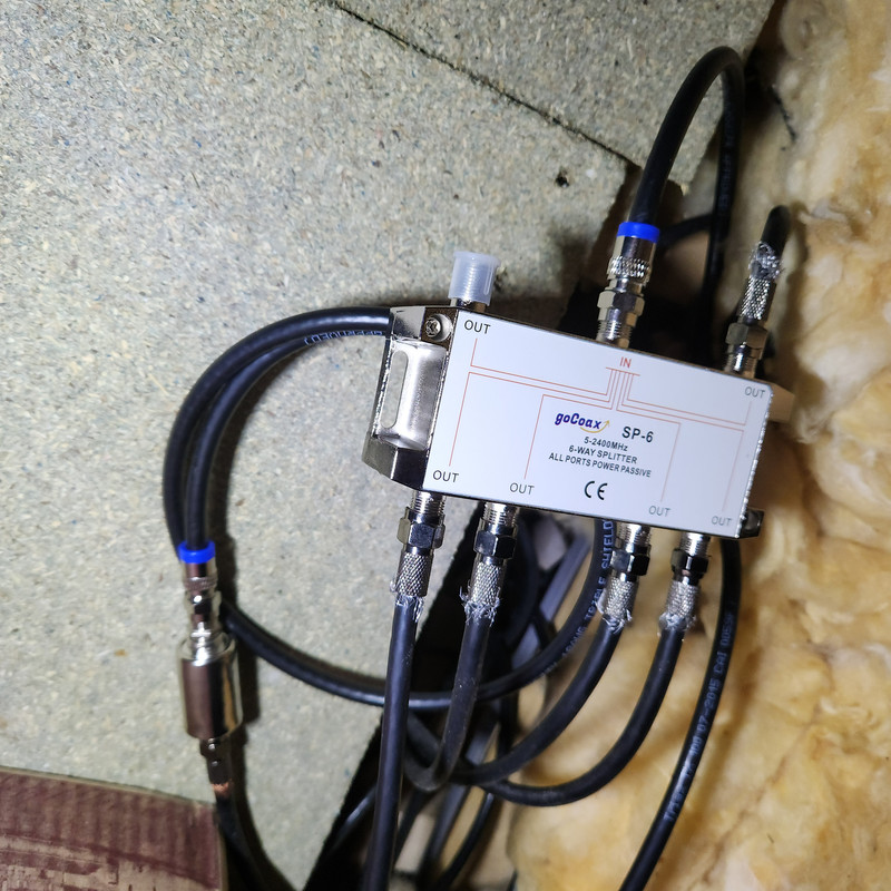

So i have the splitter with 5 out, 4 go to my bedrooms and 1 to my living room, which supplys the TV normally.
The cable with the blue end is my in cable from the arial, the barral attachment is the filter thats inbetween the splitter and the arial so that i dont broadcast the signal which if you are putting power through the cables you are at risk of doing (A big no no) the filter also bouncys the signal back improving stability.

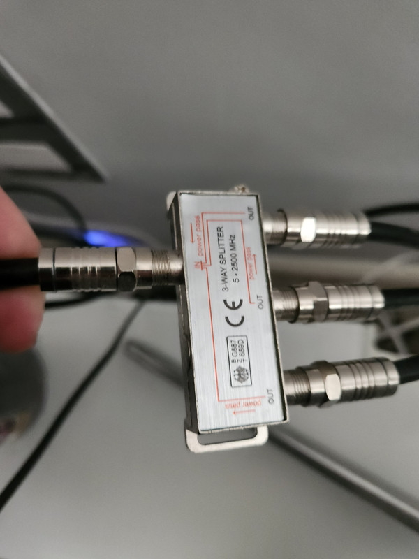

Splitter downstairs with one going to TV, one to Skybox and one to the adapter.

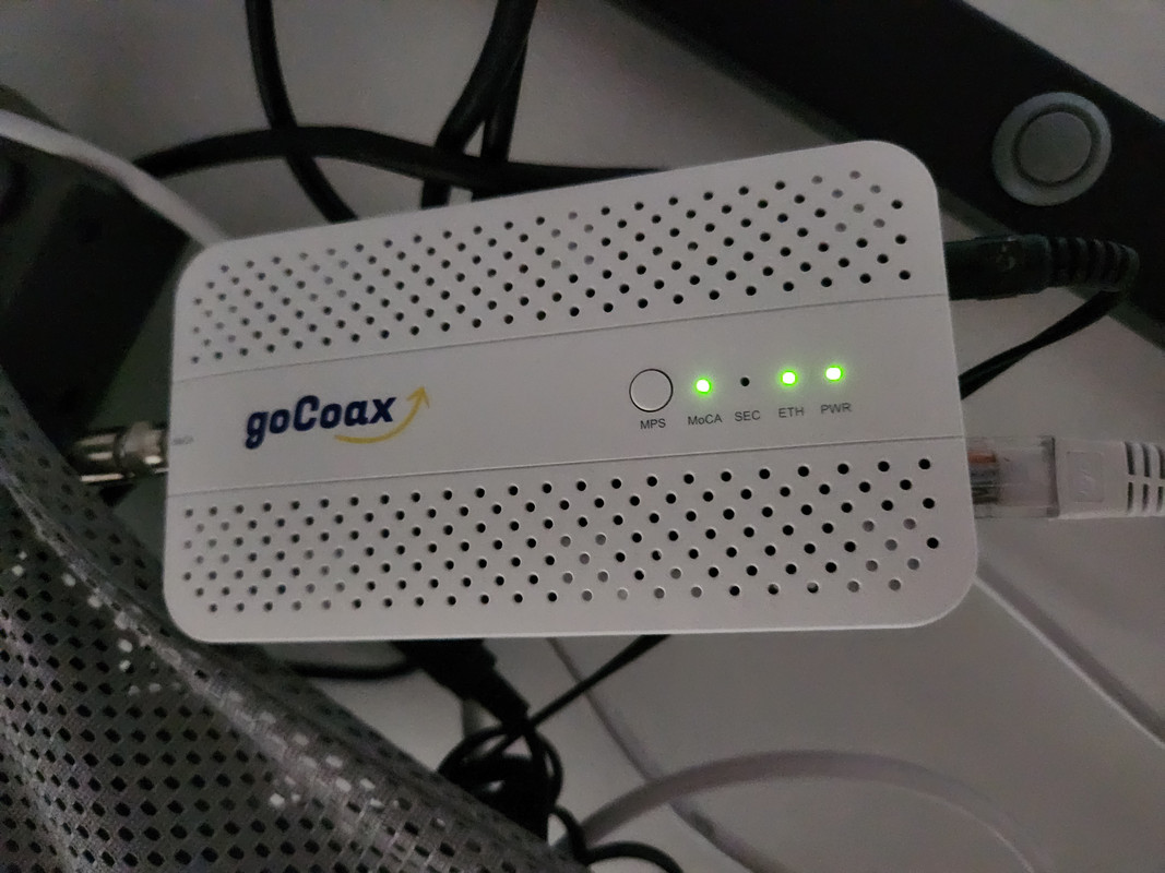

One of these on each end with cable going in one end and ethernet on the other.
These ones do 2.5gb over cable, not been able to test it fully as the rest of my network is 1gb but i am getting full internet speeds off of that so im not too bothered currently.
