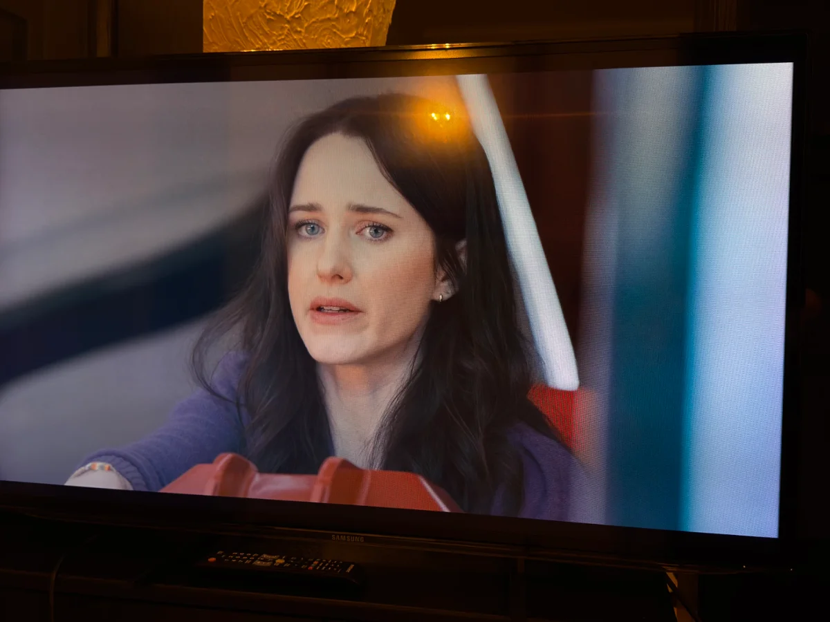

As well as people using the wrong bias lighting for their TVs. I remember back in 2014 I had to get D65 lighting CCFL tubes from a company in Colorado. Was called Ideal Lume back then. It was the only place you could get the correct 6500K back lights.
Where you then use a 10% grey pattern from a calibration disc to match up the correct amount of light displayed on the TV for optimal viewing in the dark.
Doing it for Plasma and OLED was a pain as you had to rest the panel as in change the content to do new measurements so there was no retention on the screen. Plus having the puck 1 inch away from the screen as heat would throw off measurements.
4 hours to do one TV. Daylight calibration and night settings.
