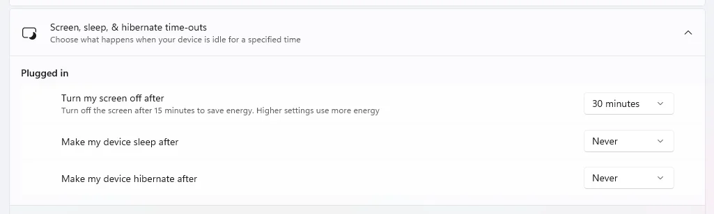

Do you not have a setting for screen off in power settings, rather than just computer sleep / hibernate?
Yes, sleep after 15 mins and screen off after 5 mins. I've changed the screen off time but it still does it.

True but it also did it with the IPS panel I tried too which is why I'm thinking it's something in W11 or perhaps something I've installed that's overriding the setting.
