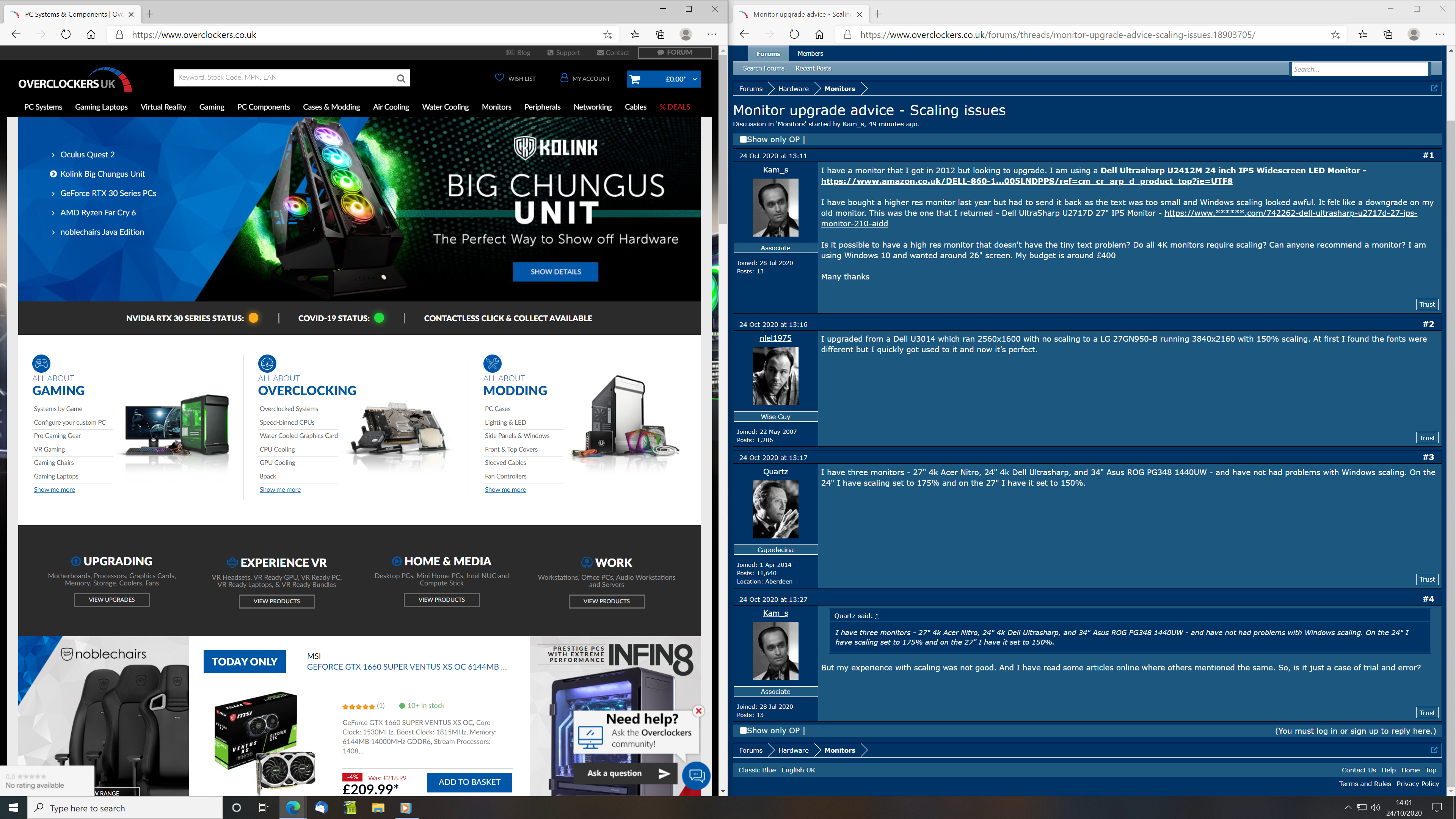

I have a monitor that I got in 2012 but looking to upgrade. I am using a Dell Ultrasharp U2412M 24 inch IPS Widescreen LED Monitor - https://www.amazon.co.uk/DELL-860-1...005LNDPPS/ref=cm_cr_arp_d_product_top?ie=UTF8
I have bought a higher res monitor last year but had to send it back as the text was too small and Windows scaling looked awful. It felt like a downgrade on my old monitor. This was the one that I returned - Dell UltraSharp U2717D 27" IPS Monitor - https://www.******.com/742262-dell-ultrasharp-u2717d-27-ips-monitor-210-aidd
Is it possible to have a high res monitor that doesn't have the tiny text problem? Do all 4K monitors require scaling? Can anyone recommend a monitor? I am using Windows 10 and wanted around 26" screen. My budget is around £400
Many thanks
I upgraded from a Dell U3014 which ran 2560x1600 with no scaling to a LG 27GN950-B running 3840x2160 with 150% scaling. At first I found the fonts were different but I quickly got used to it and now it’s perfect.
I have three monitors - 27" 4k Acer Nitro, 24" 4k Dell Ultrasharp, and 34" Asus ROG PG348 1440UW - and have not had problems with Windows scaling. On the 24" I have scaling set to 175% and on the 27" I have it set to 150%.
