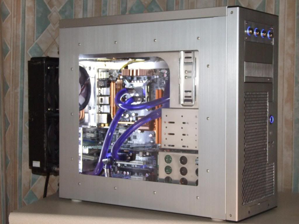

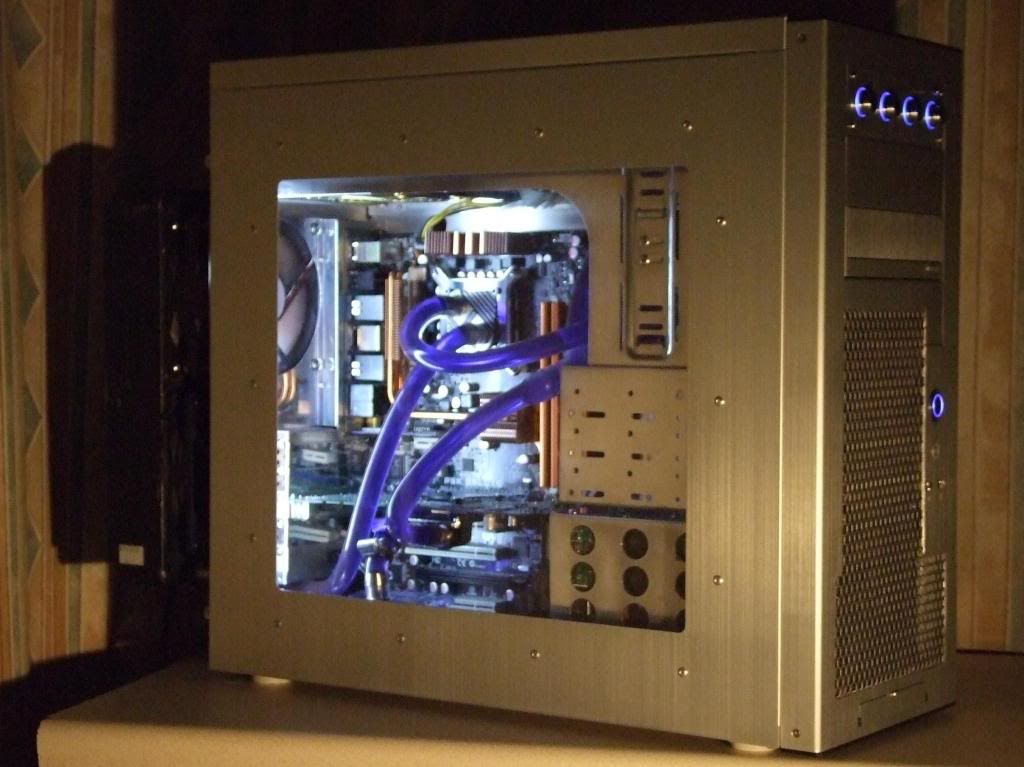

Right, well following on from the original modding on my PC-7 (http://forums.overclockers.co.uk/showthread.php?t=17781835) I switched to water cooling... I had already enlarged the exhaust 80mm fan to 120mm and put an antec bigboy 200mm fan in the roof, so I decided to put a pa120.2 off the back separated by a plastic shroud and 120mm x 38mm deep Panaflo medium fan held by bolts and the thermochill screws, and with a few holes cut for 7/16" tubing.
I'd been selling a load of water-cooling bits on the members' market I'd accumulated in job lots in the past, but quite a few bits weren't really getting any interest, so I figured I may as well put the 120.2 BIX2 radiator I had lying about to use and add it to the loop...
In my previous air-cooled mod I had toyed with the idea of cutting a full hole for a 120mm fan in the front, but decided to keep the ability to replace the 3 3.5" bays just in case. But seeing as I don't use them there doesn't seem to be a pressing need to keep them. Keeping the 3.5" bays for hard drives would be nice though.

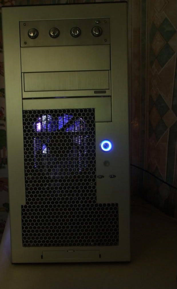

The most sensible place for the BIX2 seemed to be the front, what with everywhere else being taken. But there were a few mods that needed to be made to fit it in... there's not enough space between the front of the main case (not the clip-on front) and the hard-drive bay for the depth of the radiator by about 5mm, so the HDD box would need to be modded/moved. The fans would need to go in-between the main case chassis and the brushed aluminium clip-on front. The space inside the clip-on front is 25mm deep, but would make things very tight, and mean any mesh to cover them could not just be stuck on underneath the front as that would take up vital mm of depth. Finally, height-wise it would be a tight squeeze to fit with the USB ports below and lose only one 5.25” bay, and still allow an optical drive in the lower of the 3 remaining 5.25” bays.

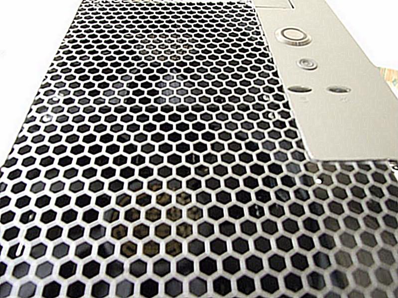

From the previous mod I decided I didn't want to just cut the hexx mesh to exactly the right size to stay in place on the front - araldite isn't strong enough to glue the tiny edges pressing against the front adequately, so it kept coming out when the front was taken off and was a hassle to keep putting back in place. This would only happen more often with a 120.2 sized piece of mesh.
Anyhow, on with the pics...

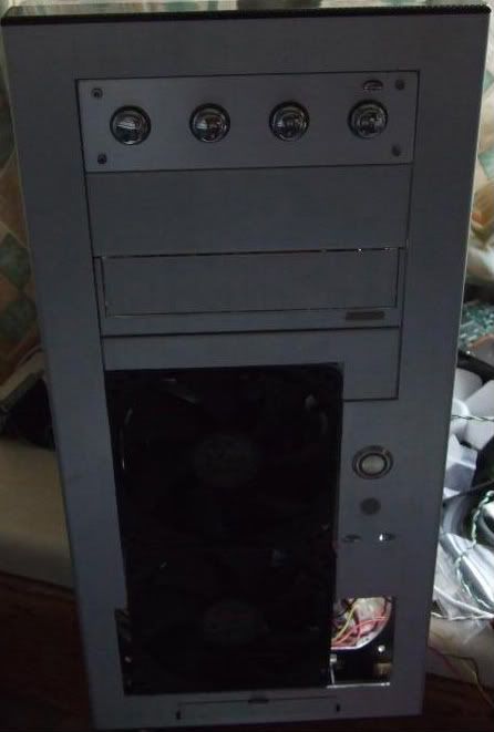

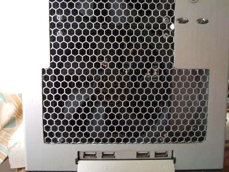

Here's the initial front clip on panel (well, already cut but you get the idea).
Before:
After (prior to tidying up the edges):

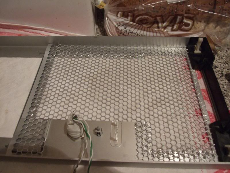

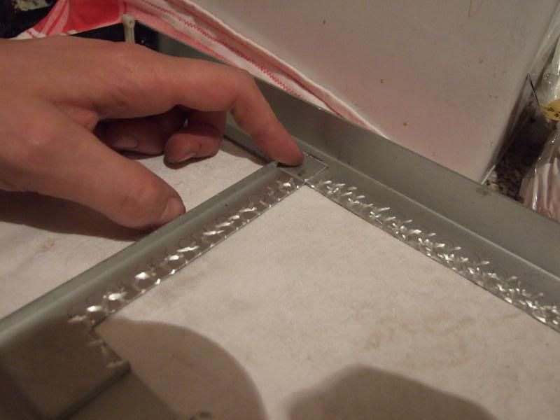

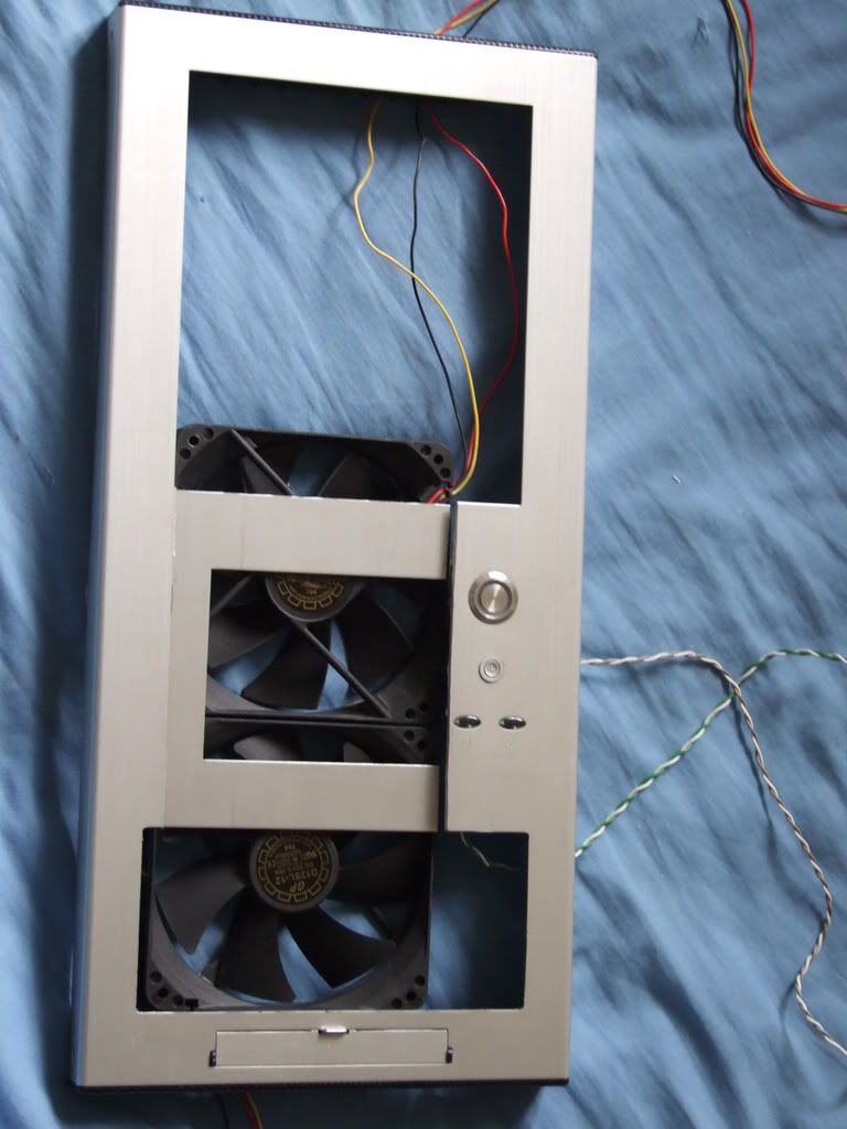

I then used the 5.25” bay plate/cover and modded it to accommodate the mesh so that there wouldn't be a mesh edge that could get fouled on the optical drive stealth cover above.
This was much easier than expected, with the sides easily bending, and the outermost parts with the 3 clip-in stamped holes snapping off on one 90-degree bend, which was a little disconcerting, so I decided to go easy on bending the bay plate flat and instead file into the back of the front clip-on cover to allow a flush fit with the front.
Front with modded 5.25" plate glued in place:

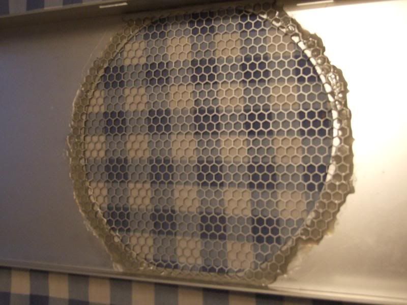

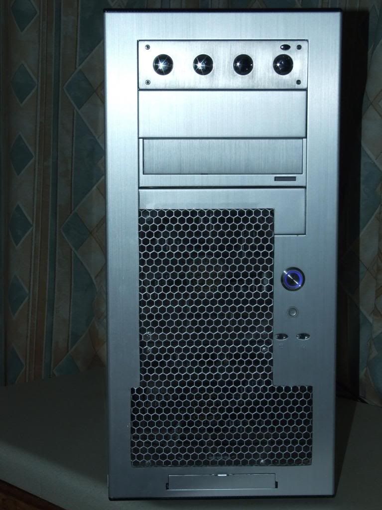

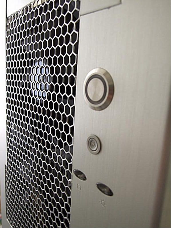

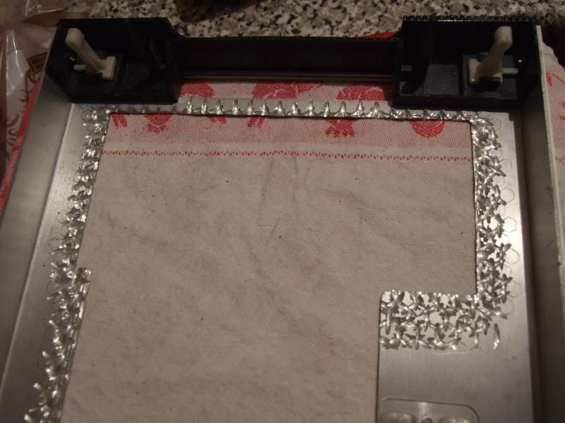

The area for mesh in the front was only a few mm over 12cm wide due to space constraints – I wanted the edge to continue from the 5.25” bays on the left and not interfere with the HDD/power light plastic bit on the right. This made getting a flush fit for the mesh with the aluminium front clip-on panel tricky, as I couldn't just create a sharp edge as the bends would take up too much width. So, having a free afternoon I decided to do several hours of careful dremel-ing to cut a relief for the hexx mesh. In retrospect this was madness, and there are probably far easier ways of doing it. But at least it's nice and flat with the front and securely attached with araldite.

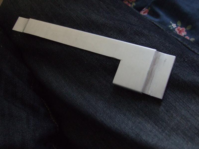

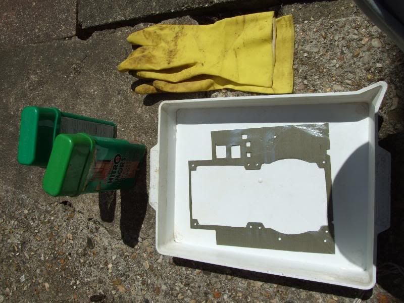

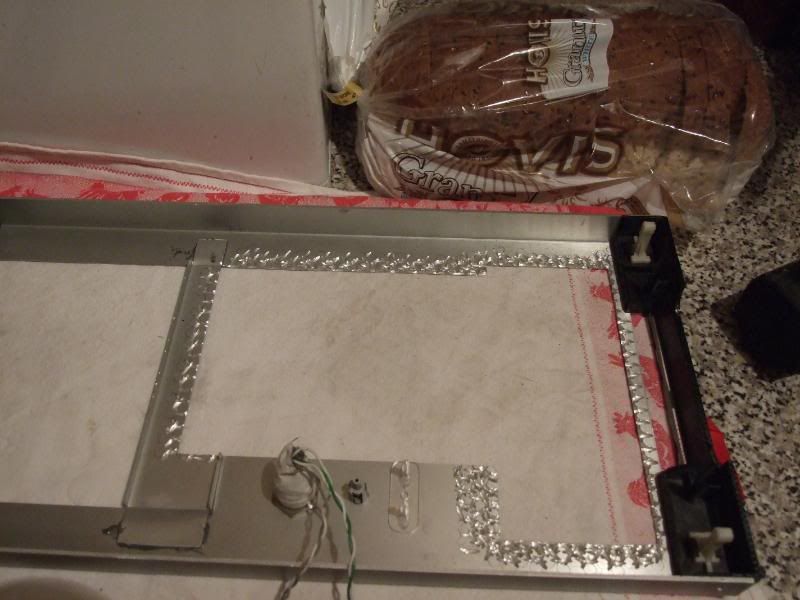

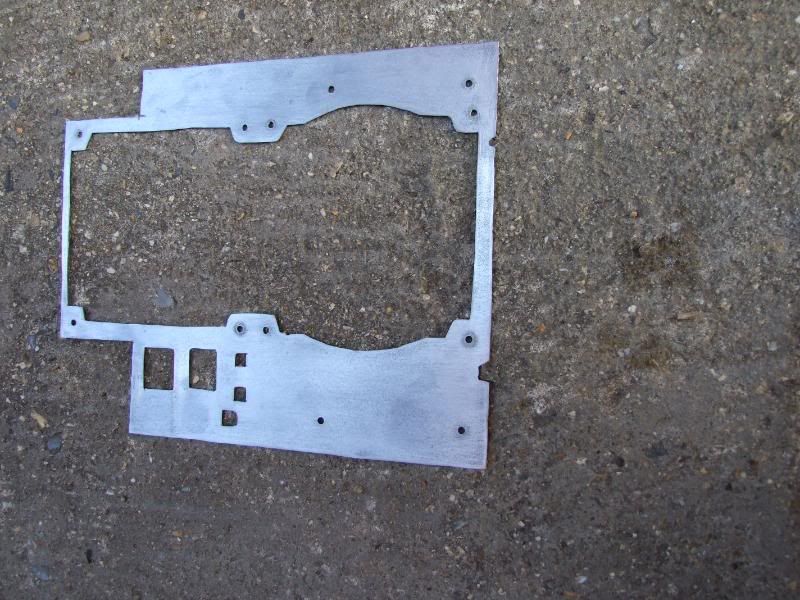

I then made a re-inforcing steel plate to go between the fans and radiator, and bolt to the pc chassis. This would add a bit of strength to the case and also set the fans back a few mm to give me a little more room. Luckily we had an old tumble-dryer side lying around for some reason...
After nitro-morsing and a bit of sanding. The final plate has 2 more bolt holes on either side to attach to the chassis:

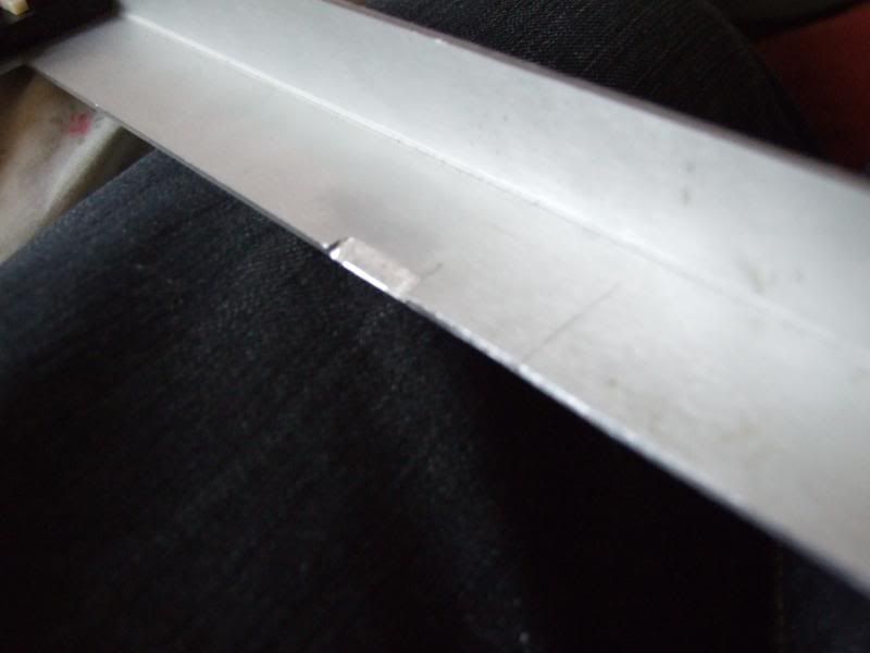

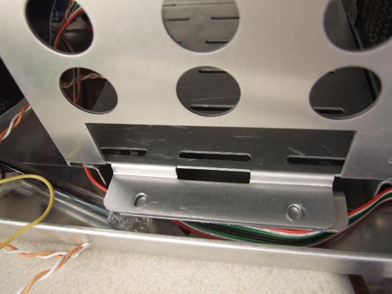

To fit the radiator in the HDD box need to be moved away from the front of the case by 5mm or so. This was done by cutting back the rail it runs on at the front-end of the case, the holding slot extended by 5mm and the holes on the drive box for thumbscrews to press down against extended to allow the original threaded holes to be used.
(taken before the nts and bolts are tightened to attach the 3.5” box to the case).

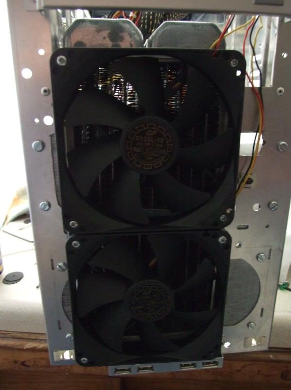

The radiator in place...
Radiator in place with countersinking done to Yate-loons...

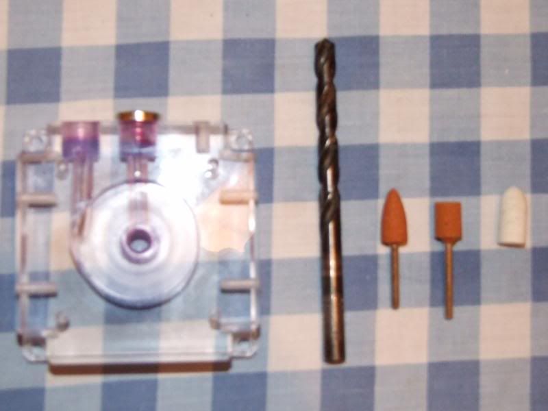

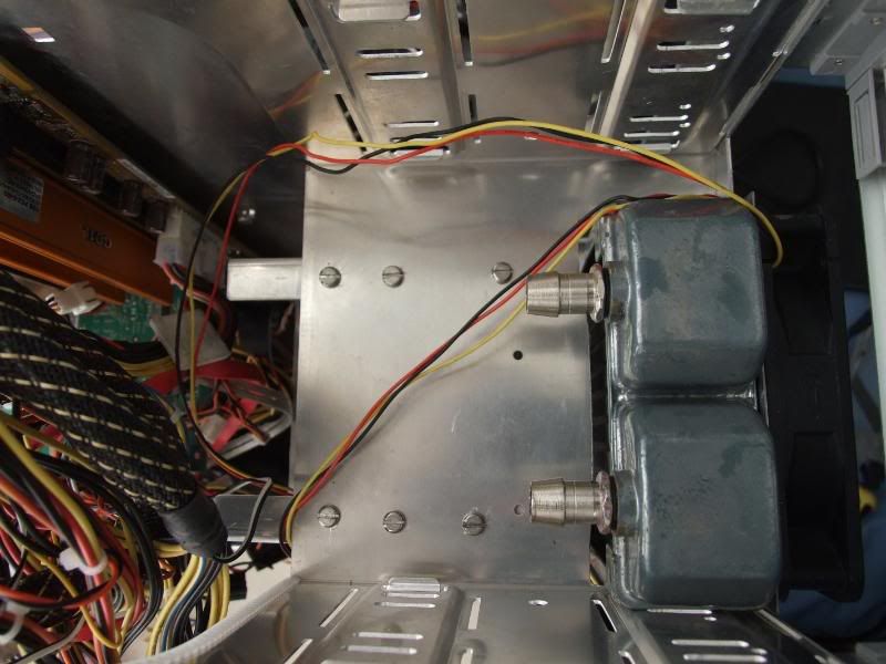

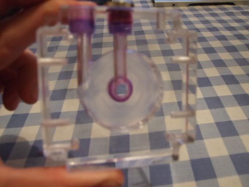

Alphacool DDC pump top at stock 7.5mm inlet size with the tools to mod it (8mm drill bit and dremel attachments:
And after (with hi-flow barb in)

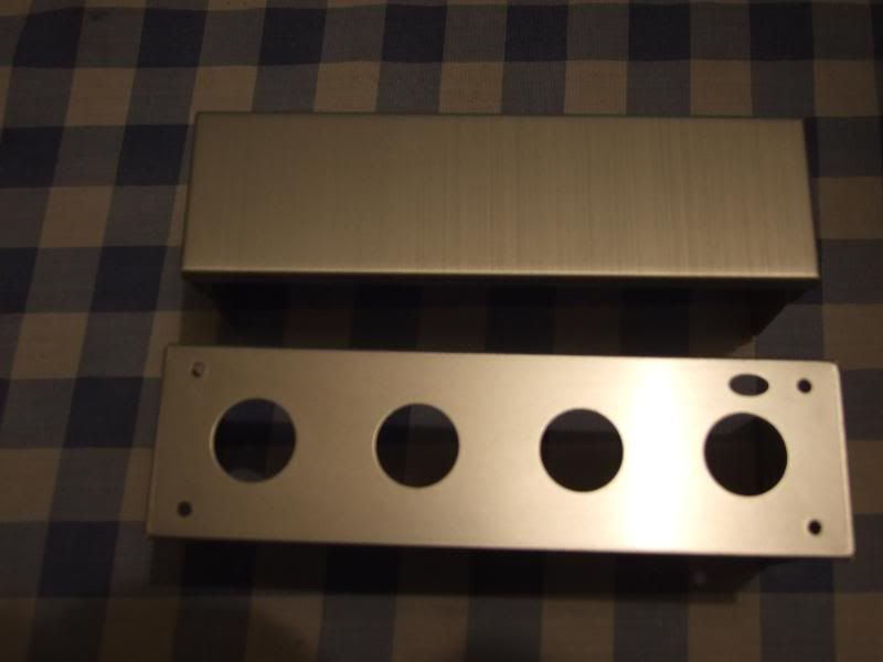

Coolermaster fan controller faceplate:
after wirebrushing. Windowed side panel also cut to accommodate 120mm fan on back of the case for the pa120.2. The tubing is a foot of steel reinforced PVC stuff for a sharp bend between GFX and pump that was kinking with masterkleer.:

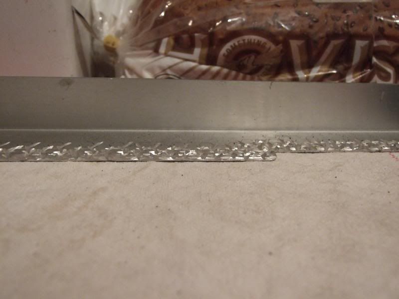

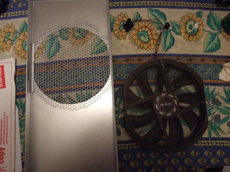

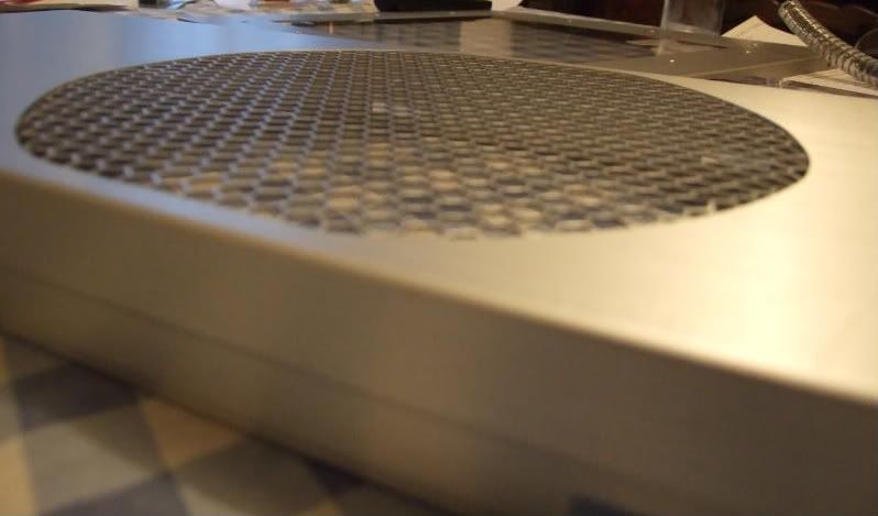

Sanded down the 200mm fan hole edges on the case top to a rounder shape: before glueing mesh in place with araldite:
and after (edges bent down for flush fit with top):
Looks very nice at the moment, although your right about that dremeling being madness :p
You going to fit any filters infront of those fans ? Dust really isn't a radiators friend.
Yeah, I've stretched some 5 deniere "almost naked" :p tights and glued them behind the front mesh so that the front can just be taken off and blown through. May redo it though as the stretching and laddering I did to make it as unrestrictive as possible is a bit uneven and it starts to get noticeable as they clog with dust.
I'm sorry, and I don't normally say this about people's mods, but the front of that just looks like a butchered mess. Why not just make the vent one big rectangle? It would look so much better if you completely removed the bottom drive bay and the section where the switch is. You could move them to the other blanking plate above or even keep them where they are now but in the expanded grill instead. Lian Li's should be about simple plain lines, not obscure shapes!
EDIT: the rest of it looks great though! :p
PK!
I didn't want to have the mesh continuing up to the next bay as it's going to be taken off a fair bit to clean the stretched tights filtering the 120.2 at the front and it's not really very sturdy stuff. Ditto for having the switch in the mesh - bulgin switches need a fair bit of pressure. Since it's a mod of the old pc-7 (hence the wide bit at the bottom from 2x80mm front fans) the lines would never be able to keep to the same lines as the 5.25" bays completely. But fair enough if you don't like the lines of the front mate, each to their own and all that. :)
I'm liking the end result there!

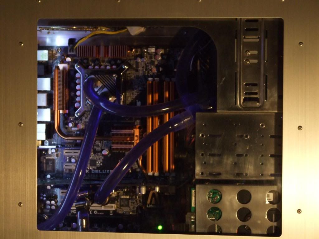

But whats going on at the back there? a second res? I can't quite figure ut where the air is flowing round the back either, I guess the lower res fan is blowing towards the back, but then the one above must act as a case intake too?
Another question, where is the mesh from, I'm looking to get some similar for my project maybe, do you know if smaller guage is available or other colours? Could I eve be cheaky and ask for an offcut to sample if you have any left over?
very nice, will look forward to it as more get put on. Is it an alright case so far to work with?
It's not really big enough for water cooling, but it 's easy to cut up. :D The build quality is really nice, though admittedly it's my first non-beige box so it doesn't have much to beat.
Yeah the airflow is:
In at front (2x120mm yate loons at 7v),
In at back (120mm sharkoon silent eagle 2000 at ~0.6v ish),
Out at top 200mm fan on medium (and by the PSU at the back)
I can't link as it's a competitor, but the stuff is called 'AC Ryan MeshxPanel HEXX'. Google's your friend. :) It's aluminium and it's available in 480mm x 480mm x 1mm sheets in silver (bare Al) or black (painted Al).
They also do a much smaller guage round hole type rather than honeycomb, which looks like old cheap metal pc speaker grills. It's more restrictive and not as pretty as it's round hole rather than proper honeycomb. I accidentally ordered it before getting this. It's far too restrictive for a radiator grill though imo.
Send me an email with your address and I'll send you a sample of hexx mesh. :)
