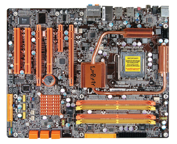

So I have a DFI LANPARTY DK X48-T2RS motherboard and I have just purchased a Zalman CNPS9500A cpu cooler. The problem is it won't fit properly with MOSFET heatsinks on the board. I was going to swap out the NB heatsink for that Alpenföhn Ötzi Northbridge Cooler. Would it be okay just to leave the MOSFET's bare? Do they really need heatsinks? Thanks.
That's the board below:
Sorry but yes they absolutely need some sort of cooling

Nope. That thick, grey pad is used to transfer heat from the very uneven surface of the mosfets onto the heatsink. As evidence I offer the boards with mosfet heatsinks that are separate from the northbridge.
However, by the same token you can buy boards with no mosfet heatsinks. This suggests that they'll work bare. However they'll run hot, and I think will limit your possible overclock. It's possible that you wont be stable at stock settings and/or will damage them by attempting this.
The better idea is to send the cpu cooler back and get a different one. Sorry man.
