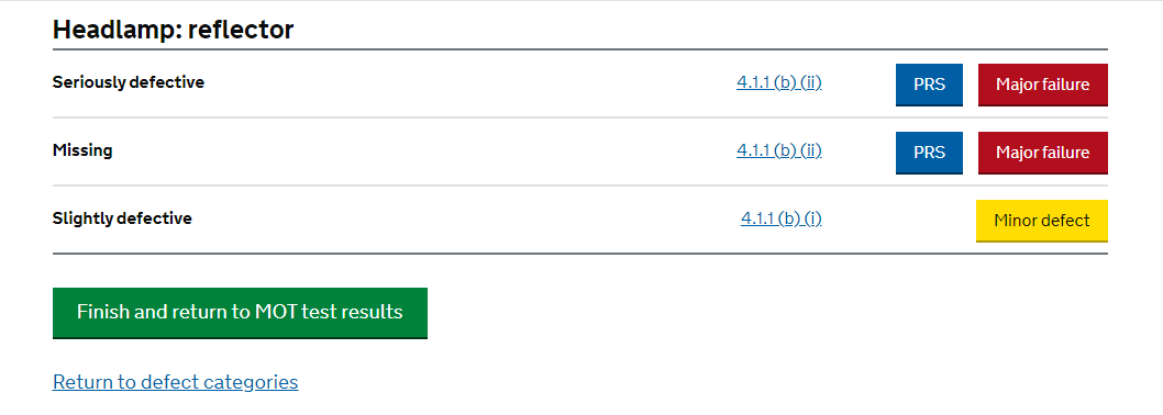

I thought height/aim was a separate failing? I've never had it worded like this before.
Ref headlamps and beams etc..
