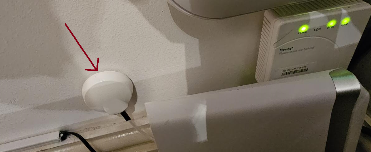

Sorry for the necrobump but I am wanting to do this as well. I just want to move the ONT box as the grey box outside is ok where it is.
The problem is I don't know if it's possible to disconnect the ONT and pull the fibre back outside with plug attached?
It's connected to the wall with some kind of white plug (see pic). It doesnt obviously come off but I am hesitant to put much force on it.
No, you can’t do that.
When they installed the fibre, they passed the fibre through the hole in the wall and then terminated the connection with a big plug. That plug won’t go through the hole in the wall.
And the white ‘plug’ is a cable nose - it’s just a stick-on cover that covers up the unsightly hole and makes sure the cable points downwards. It makes the job tidier.
Ok thanks for confirming. I'll try get Openreach to move it.
