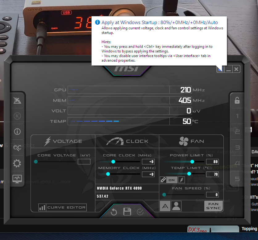

It's as easy as that. Just make sure that the blue windows logo is enabled so that the power limit is applied at startup:
It's realtime too so you can adjust it on the lfy whilst gaming and see the immediate power draw affect it has if you go back into AB/HWINFO64 etc.
thanks @mrk
I have put it down to 85% for now. The only issue im getting is the Windows logo at the top is "greyed out". I cant click or amend with it??
Got it sorted thanks mate. It was locked on the profile tab, soon as i unlocked it, it let me set the Windows icon!
