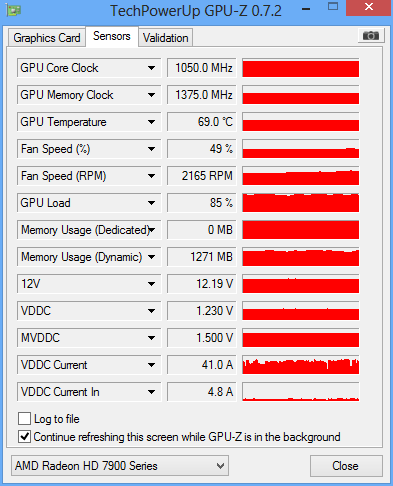

When under load the voltage drops from about 1.26 to 1.18V, if you watch the line in GPUz you can see its up and down under load and constantly under the set voltage. I can upload a photo later when I'm at home.

Have you set the power limit to +20%? Use an overlay and check the core is not throttling while under load.
Yeah I did set it to 20%. I will do a GPUz screenshot later if that will help at all?
Here it is. AB is set to 1256 mV
Although it doesnt look to bad on this occasion, typical hey
vdroop
theres also different voltages/core/memory clocks for each load situation,web browsing/watching video/gaming and idle mode,they switch automatically which is normal
to see true vdroop you have to fully stress the gpu
You can see it better in this one running heaven 4, the VDDC is quite low compared to what it should be (1.178 instead of 1.256) which I'm guessing is Vdroop, is that a normal amount?
not sure tbh,i'd need to look at my 7970 to compare when I get a chance
aslong as everything is stable then vdroop doesn't matter
