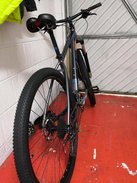

Thanks so much for your replies guys i appreciate it,i decided to go with the Continental Double Fighter III 29er,makes the bike look so different compared to what it had on last but i like it,Not been able to take it out for a ride yet because been horrible weather yesterday afternoon but here they are and how the look.
Degreased and cleaned the whole bike while i had it apart too,super clean now. :D
