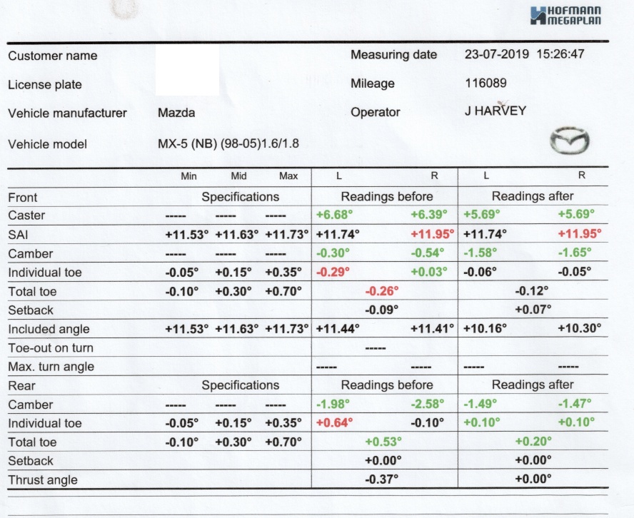

Fast road alignment done today. Also oil change as I gave up 3 hrs in trying to get the damn filter off. Pretty much ready for the owners club sprint at Curborough in few weeks. Anyone else going?

Will prob do a full alignment afterwards as well.

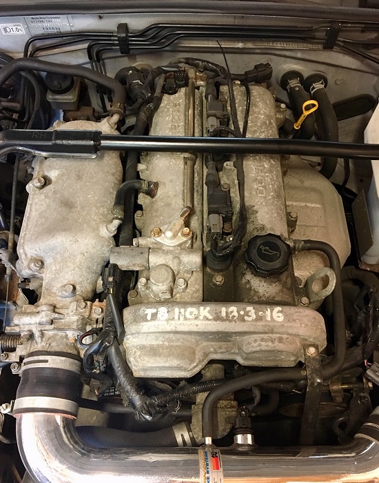

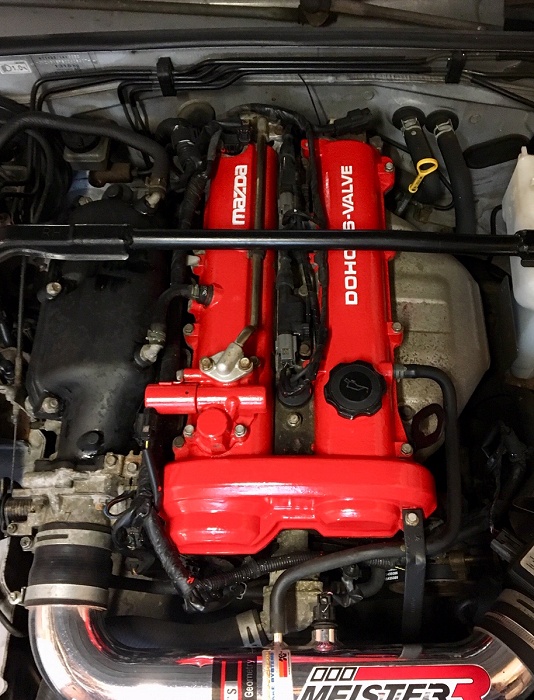

Tarted up the engine bay. Sanded some of the other bits in there which you can't see, to get rid of the surface rust and painted grey again. Mostly the bar that goes across the front at the top, that the radiator and front lights attach to.
