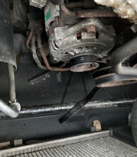

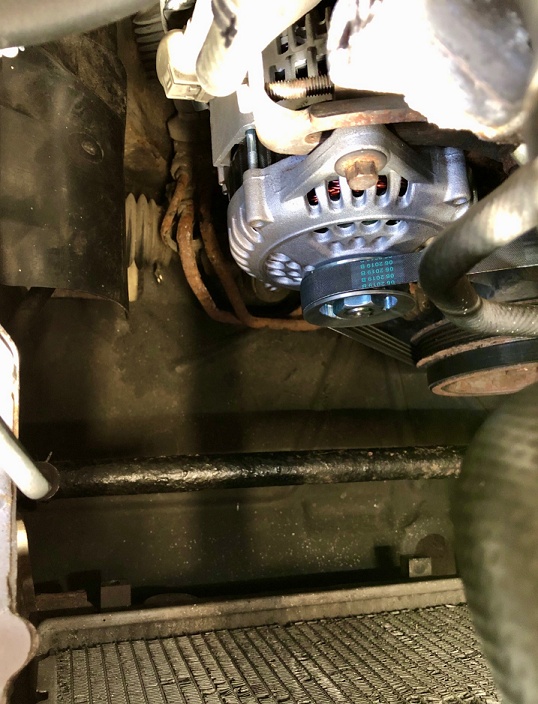

Took the MX5 out of hibernation (garaged on 1st Dec and gave it a quick run in mid Jan) and...
Erm stopped the engine quick.
Turned out the alternator had completely seized so it wore the belt away within seconds.
Got a new one fitted and new belts. So shiny so chrome :D

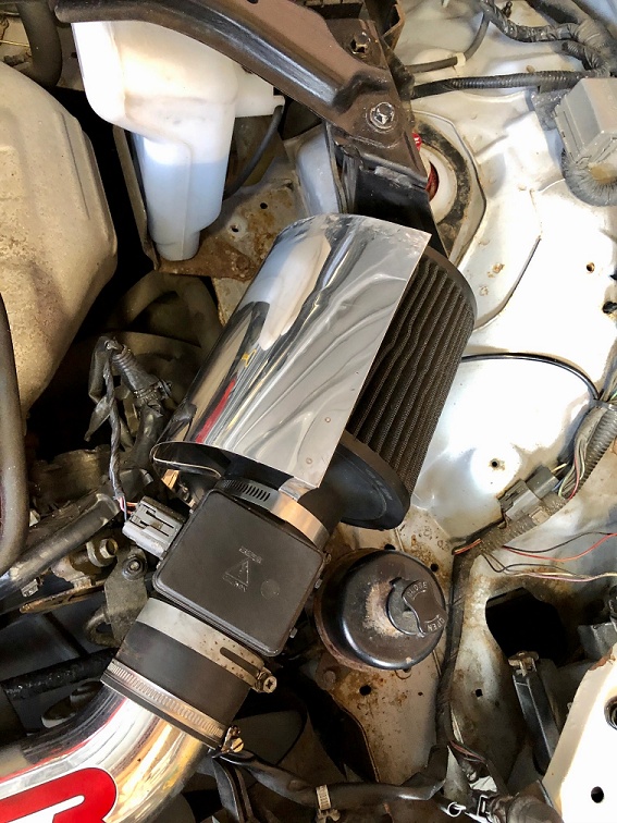

Idle was rough which is something I knew needed sorting. Swapped the MAF over from the K&N one to the stock one I still had. Sorted it out nicely :) Also a chance to clean up the heatshield and cone.
