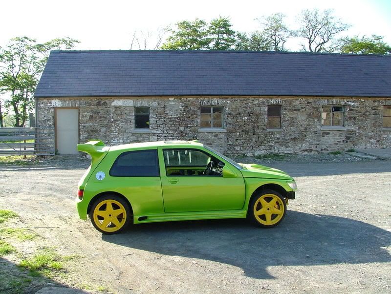

what you do think?
Its a clio 1.8 engine with modded crank, arrow steel rods ,wossner 8.5 to 1 forged pistons, wire ringed block, big valved ported head, some piper turbo spec cams, hybrid T28 turbo, pace charger cooler, air oil cooler and lots of other bits and pieces.
output will be between 350/400bhp.
performance is yet unknown.
car is a very highly modded clio maxi replica.
makes 320bhp without cams and headwork. bb tuning sell this kit with either a 250bhp or a 320bhp map.
will post results once i,ve run it in.
i,ve ditched the spoiler see above and its on coilovers so will be going down. engine wasn,t fitted in those pics.

hi. do i still need the hovis photos now then. i agree it doesn,t look at all the same but it is a maxi kit. i have realised the front splitter was a mistake and removed it. also removed the vent as i have fitted a carbon bonnet. i like the skirt and rear spoiler still. the shut lines have been sorted with a bit of adjustment. those photos are from its return from the body shop over two years ago.
