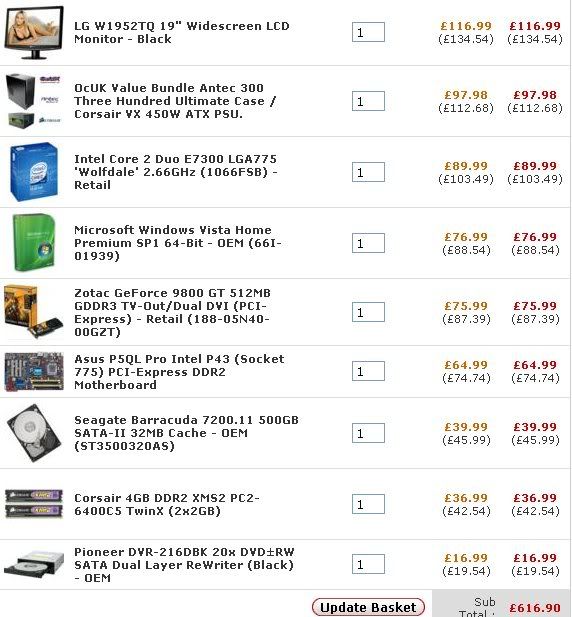

Need OS but mouse keyboard monitor seperate budget for that.This is what i thought i might buy..But is it any good? I am a little flexible with my budget about £50 for upgrades or if i just got something wrong with hardware.
Id certainly look at getting a 4850 instead of the 9800, its not only better but would also allow you to add another card later if you needed, as that mobo supports crossfire, Id also look at the gigabyte GA-EP43-DSL mobo (same sort of price), if you do prefer asus i'd recomend spending the extra to get the P5Q Pro (no L in there) as better board and better layout, these also support crossfire so an ATI card will be better, the 4850 is more than the 9800 but its worth it, also look at the 20" monitors, either one of the samsungs, I'd normally just go for the pebbles but the aqua is on this week only so worth a look too, theyre actually cheaper than the one you've specced
