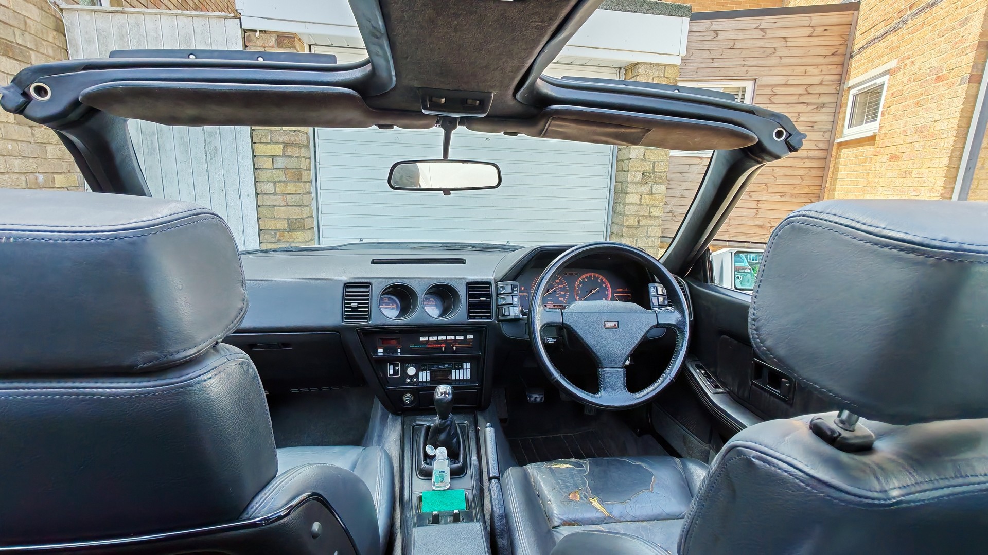

At the ripe old age of 36 and having liked cars for maybe 35 of those years I've decided its time for a midlife crisis my first project car. I am not very good at making decisions because it is easier to just continue with the status quo, so I've been looking on and off for a car for a few years including this post a few years ago. But this week I finally stopped being wimpy and bought something - it helped that it was nearly a third of the price of that grey 300ZX.
I feel I am being a bit ambitious having barely changed a battery by myself in the past - parts are hard to come by!
On Saturday I spent an hour or so cleaning it up and giving it a more thorough inspection (I get excited and forgetful when I view cars as it happens every year or so). For a car that "doesn't have leaky t-tops" it definitely had mould in it - but I might put that down to being stored in under cover, damp, all winter. But it cleaned up OK.
It has spent many years in Spain not getting salty so the underside is actually OK except for the jacking points.
By coincedence (especially considering how rare these cars are) there is a guy a few miles from me that is breaking a couple of these so I can pick up a few parts locally.

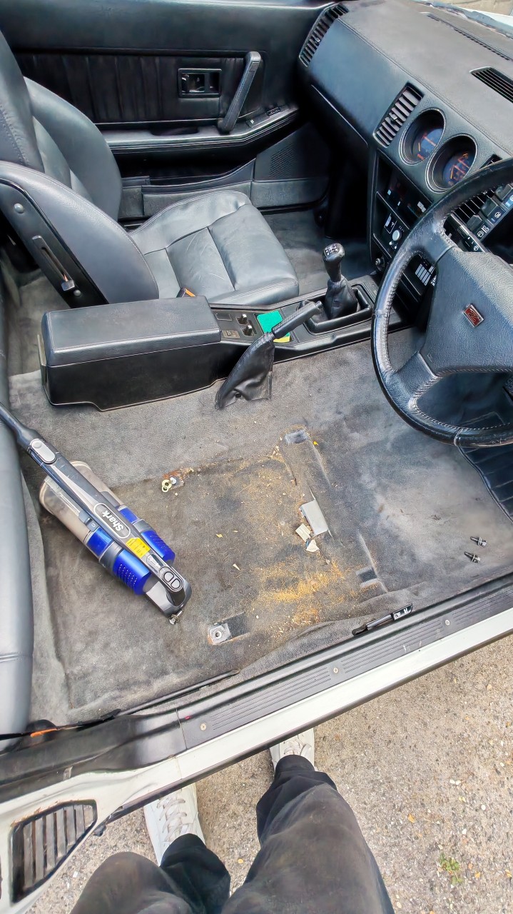

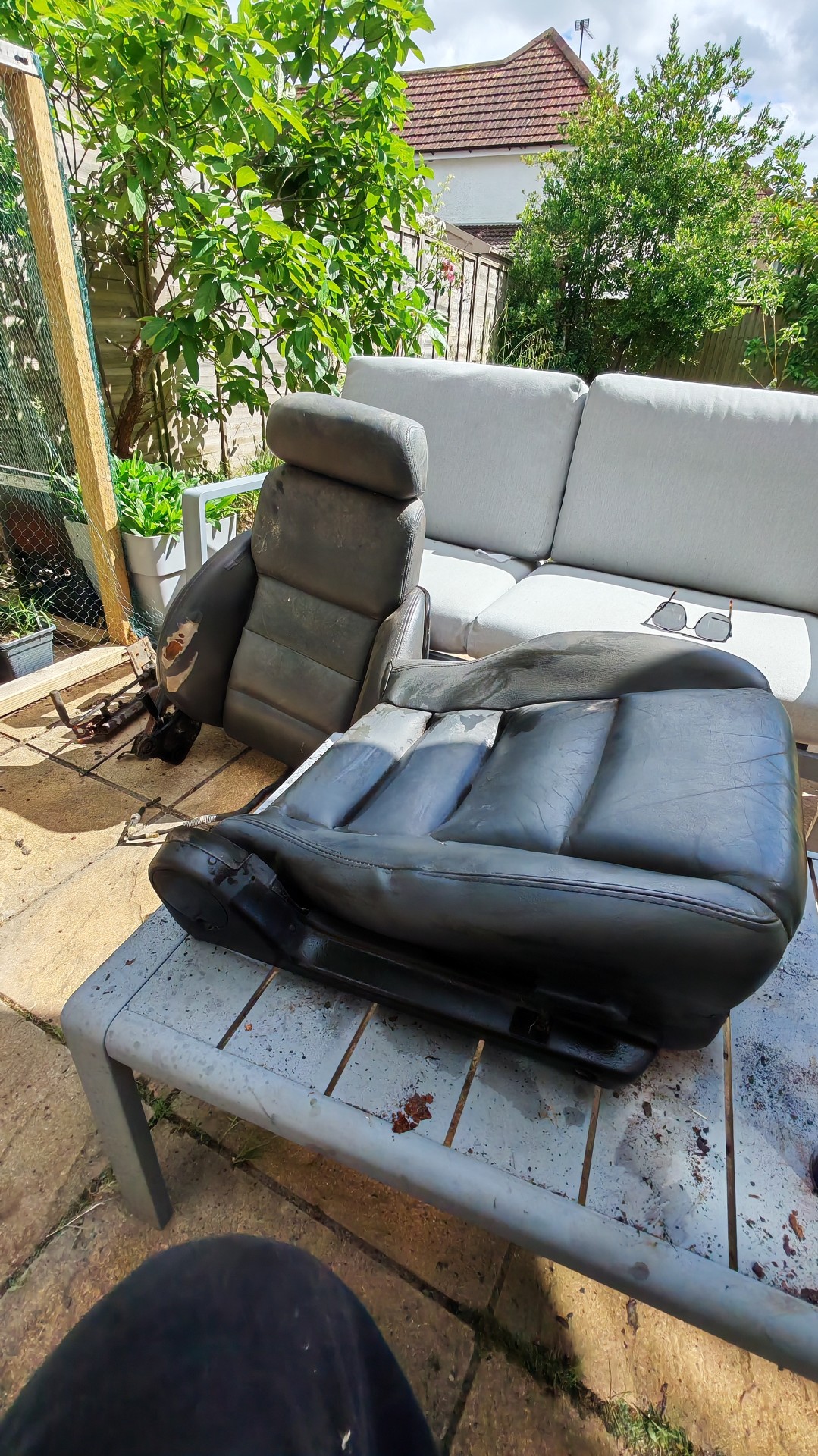

I was then too chickenshit to do the oil service or coolant so instead I went to the parts guy to pick up the seat. Getting it back home I decided the best bet was to combine the good base from the spare with the good backrest from the seat in my car, but mount it on the good railes from my car. I then spent a few hours taking apart the spare:
However when I got the seat out of my car, I noted the base of the spare seat had much much worse corrosion. I decided that I would rather have crap leather but some actual solid metal under my butt so proceeded to put my own seat back together again. On the plus side I know how the seats come part now, and I could hoover up the rubbish that had accumulated under the seat.
I then re-mounted them in the car but forgot to re-attach the seatbelt house thing, so out came the seat again.
For someone who has an energy limiting condition, I am now completely knackered!

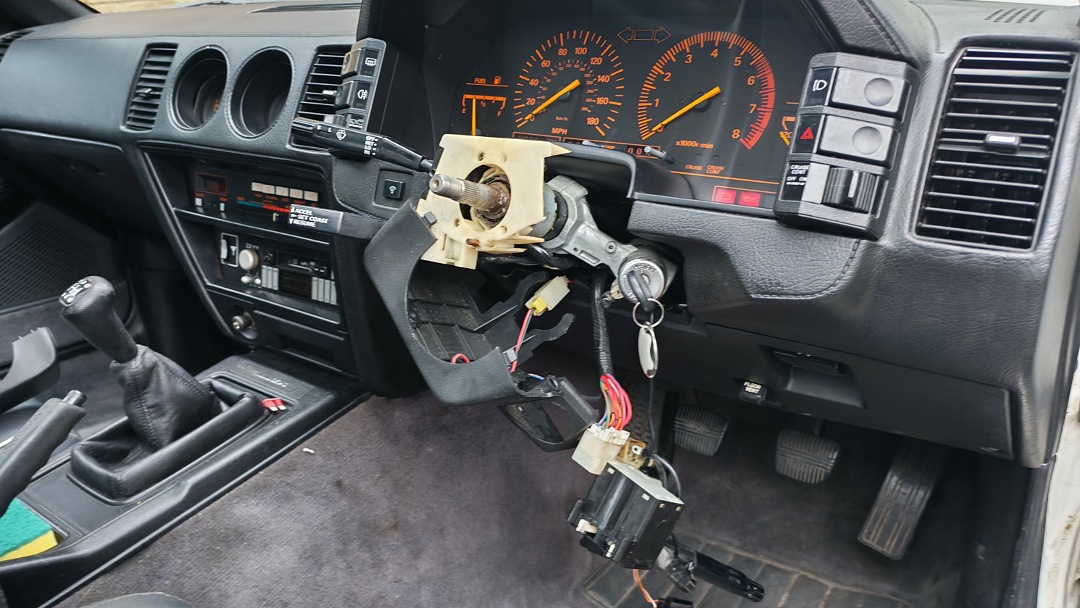

But today I decided to tackle the light issues. The side lights wouldn't work and the tail lights wouldn't work. After checking some bulbs and fuses the most likely culprit is the switch on the steering wheel.
So I took apart and removed the steering wheel removed a few screws and 40 year old plugs and plugged in a new switch. It is scary to see your car like this when you don't know what you're doing:
This was a junkyard switch but it all works so I now have tail lights and side lights (and headlights!) I was hoping you give it a "sleepy eye" look for side lights (I.e. don't raise the lights) like the child that I am but couldn't figure out what to unplug as the switch that opens the lights when you turn them on was already unplugged...

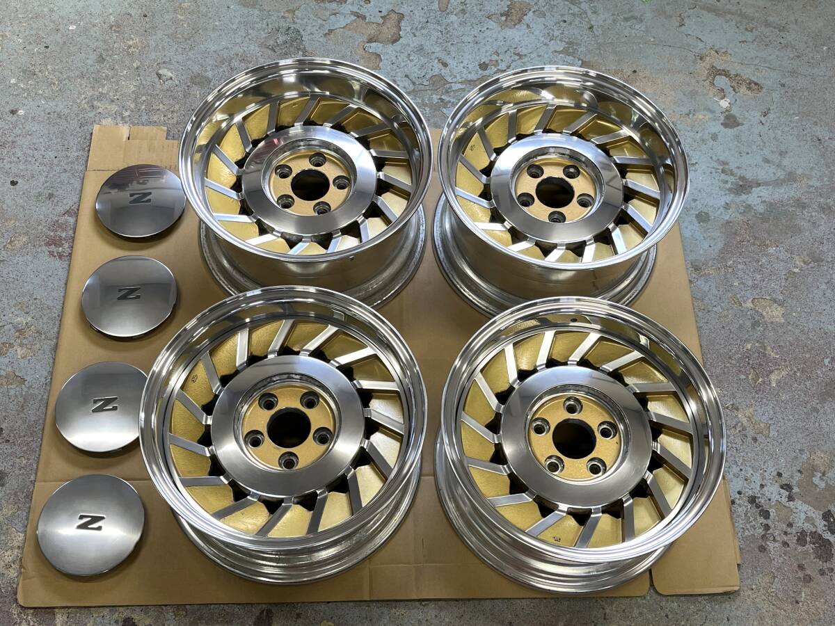

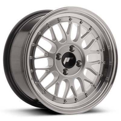

I am fan of turbine style wheels and multi-spokes. So far wheels in contention (5x 114.3 16"x 6.5" or 7") are:
Japan Racing JR23
These Z31 special edition wheels which are about twice as expensive
I don't think 5 or 6 spokes will really work on it - it looks too old.
