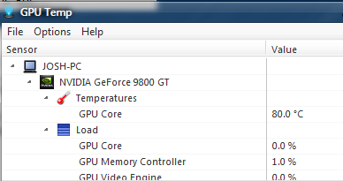

My GPU core temp is 80c...

I do, yet you fail to realise that a card sitting at 80C on IDLE is quite clearly suffering from a faulty heatsink/fan assembly. You contridicted yourself in the post I put lol to seen as it didn't warrant any more of an answer than that.
Why on earth would you think that 80C whilst IDLE is an acceptable level? If he watched a youtube video, his graphics card would probably hit the thermal limit and throttle hard to try stop itself from melting.
To the OP, like I've said before, replace the card or replace the HSF.
there is definitely something wrong i had 8800gts g92 temps never were so high , also people saying that 4870 idle 80 c it is something wrong with the card as my idles @ 40 c with bad airflow case, on my second pc.
try resit the cooler
I had an 8800GT which i'm sure it's pretty much the same card,was going over the 100'C in some games and idle about 70-80'C.
I took the cooler off and cleaned all dust/thermal paste away.
Re-applied thermal paste and it was a lot better, 40-50 idle and 90's at load.
Carefull with the pads on the memory and VRMs, mine flaked apart and I think that's why the card died eventually..

The OP has said multiple times that he hasn't experienced any problems with the card's performance and if he's happy with it he should just carry on using it until it dies like any other piece of hardware. Personally, given its age, I'd replace it with something like the 6850 as suggested in other posts, but trying to get it cooler achieves, at best, nothing but the same card, doing the same stuff, at a lower temperature. At worst, he wastes money and risks damaging a working card he's otherwise happy with.
I realise that this is an enthusiast forum where people often use superior cooling methods and care a lot about temperatures, benchmark results, et cetera. However, I'm not going to apologise for not caring in the slightest beyond general, real world performance.
As to "Why on earth would you think that 80C whilst IDLE is an acceptable level?" (this includes the 4870 temperature). Because, again, it's within spec. I'm quite sure people can go to review sites and see things like the reference design 4850 exceeding 80+c when tested, sometimes 90c. The 4800 series was well know for running hot, and mine did indeed idle at 80+c and load at 85/90c without throttling or the fan speed increasing significantly. It also ran quite happily for years and it's unlikely that the eventual fault which led to me fitting a new card was temperature related. It's not surprising as decent coolers add to the cost and people notice noise more than temperature, so it's easier to let the heat build up and just cool enough to keep it in line.

You honestly don't have a clue what you are on about. 80C idle and over 90 in a 2D game means that the lifespawn of that GPU will be severely limited. Just because the max temp is slightly higher, doesn't mean the card is designed to run at it 24/7.
The cooler is faulty and arguing about the nomenclature I use is just purile.

I have to agree with this. No way should ANY gfx card be at 80c+ on idle. If it was me, after the usual de-dust and if the temp was still way high, then so long as the fan is still spinning correctly, then take the heatsink off, and clean off the old thermal paste and add new.
I agree for most stock gpu's they don't hit this at full load. On idle either the Cooling is not working or the card is faulty. Overclocked on full load my 6950 gets to a max of about 60c.

As you can see these idle temps are far far below the OP idle temps...This leads me to believe something is wrong. Oh and just to state, the OP uses a 9800GT.

Firstly, the 4850 examples were in relation to the various comments in other posts about 4850/4870 temperatures and all I was trying to show was that there are cards that run at those levels with stock coolers. I was not making a direct comparison to the OP's 9800 GT.
Secondly, I am in no way saying that it wouldn't be better if it ran (a lot) cooler. I wouldn't dream of overclocking that card and its temperature may well shorten its life. I don't dispute for one moment that if he replaced the heatsink it would run cooler and that would be better overall.
Unfortunately, there quite a lot of information missing about what temperatures the card ran in the past, the voltages, make of card, full case layout, actual fan speed, what happens when the card gets really stressed out and so on.
I still think that the card is just on the edge of running okay and its performance is indicative of a budget card/cooler in a less than optimal situation.
If there was more info, say, it going higher than the mid nineties under maximum stress then I would agree that the cooler should be re-seated or replaced.
However, I got the impression that the OP's main concern was if serious problems were going to develop at those temperatures and given that the card is really pretty old already I honestly don't think it's worth worrying about. I didn't want him to panic, waste money or to try and modify hardware if he hadn't done it before.
Personally, I often run the cheapest reference design card, don't overclock it and often change it when the warranty runs out, if necessary, so that may be why higher temperatures don't seem that unusual to me.
Anyway, I really didn't want this thread to become "epic" or to come across as an ass. I'm not (completely) clueless and do understand about the problems heat can cause with reliability, et cetera.
