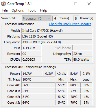

I ran coretemp as soon as I was able to, as you can see it was hitting 80C during startup, dropping to around 50-55 at idle, Vcore set to 1.140v

Have you actually set vcore to 1.14v or are you just quoting the VID in core temp? ( think VID is what the CPU require to be stable at stock speed)
You need CPU-Z as that will show what the bios is actually running CPU vcore at.

is that voltage @ idle or are you loading up the processor. When win boots up, it launches/starts services and apps, and the cpu is loaded up.
get HWinfo and post a screen when you can. It might not be JUST the vCore(which seems quite good 1.14 for 4.4), your Ring/input might be stupidly high.
Also you might want to check the voltage under some stress, don't use prime/ibt get asus rog bench test(??) or aida64, run them for more than 2-3 minutes, and post the voltages/temps.

That's idle voltage. I'm not going to touch stress tests since just opening up chrome with 10 tabs open will push the cpu up to 90C without the cpu even being at 100%, so I'd rather not toast it by trying to do that!
