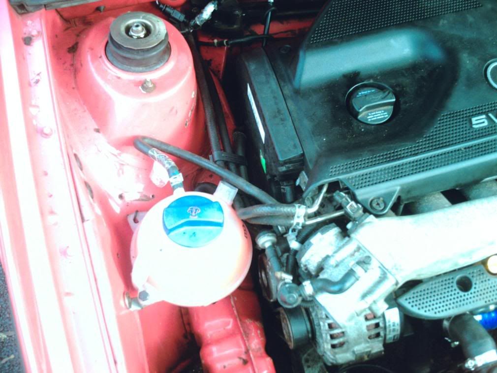

next i used some gunk to clean up the bay. its still not the cleanest but a massive improvement from how it was
that was as far as i got realy, bar fitting powerflex stearing rack bushes and almost getting the mk4 shifter in.

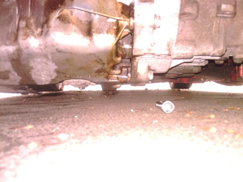

i actually got the engine and box in, i have fitted 100mm flanges to the gearbox (so the standard rocco shafts will mate up), but im having trouble getting the drive shafts to fit. it looks as though the shafts are just too long to fit, but it looks like they would sit in the cup if i could get them past the edges, if that at all makes sence.
i have a problem with the brake mc/servo, one of the pipes that comes off the bottom of the mc is right in the way of the counterweight on the gear selector, so im going to have to change the mc/servo sooner rather than later, as i was planning. (i might use a mk2 16v one i have instead of the mk4 one like i was going to.
the rear gearbox mount i bought from tracksport is utterly useless it is no where near fitting, but with the car on a ramp and the engine in place im sure i can sort something out.

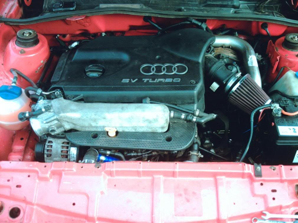

the only pic i took of the engine
and a test fit of the intercooler, perfect haha

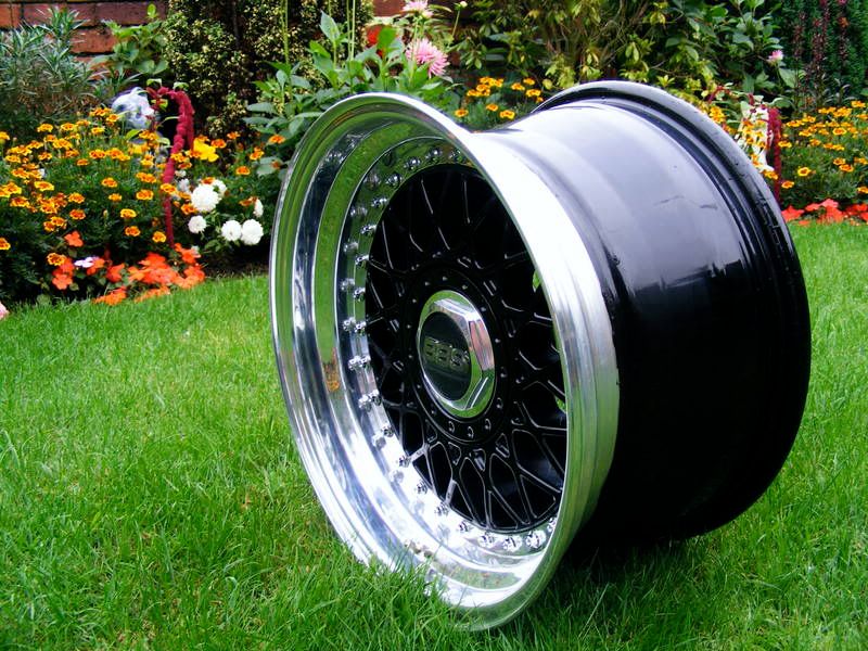

just got 4 of these,
8.5x15

i bought the rims from a lad on CGTI/E38 he had built them/had them powder coated. they should look a lot better than my ats rims i have now, and should give it a nicer stance.

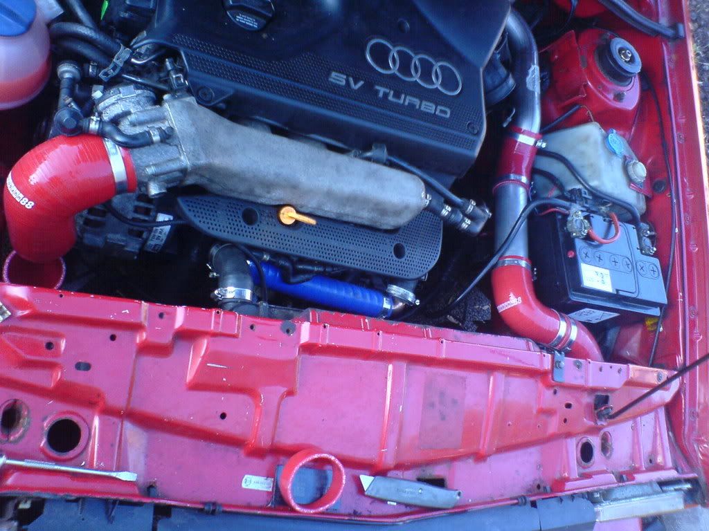

theres still a few things i need befor it will be running, number1 is my ecu back haha. i need to get some boost pipes sorted, i was gona use silicone bends and alloy straights but i think that will look a bit cheap so im gona try n get some stainless pipework made up.

i got the boost pipes fitted today, took me a day to find a place to make me a pipe so i could fit the map sensor :(
it now makes some good whooshy noises haha. just need to get a couple of brake pipes sorted and i can take it sor a spin round the block.

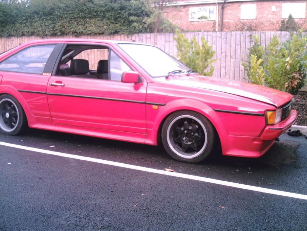

car look a bit purple in this pic.. bloody digi cam
ground clearence is a bit of a problem
