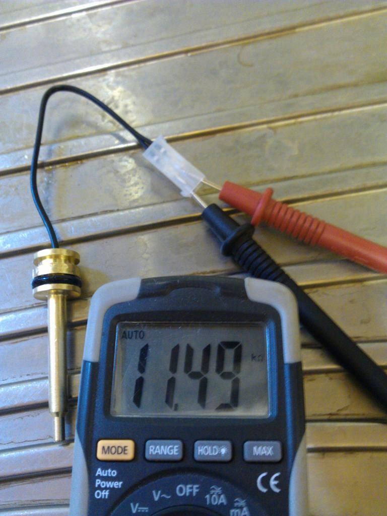

I got called out today to an Ideal HE combi reportedly showing the H3 fault code...So took a dhw sensor with me, and fitted it, all worked fine :)
Measured the resistance and took a photo for you:
Mick
