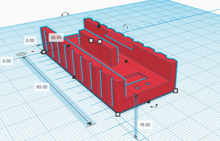

Modelling and printing it is a doddle, the part that isn't is getting all the measurments right. I threw this together in 2 mins in tinkercad:
Its the little things like the little down clip that starts half way or so down the part, does that run all the way? so many questions... I can literally do a tutorial though to make that part in a few mins if you have all the measurements of every part.
That’s incredible! You sir are something of an expert with Tinkercad! I spent an age before trying to work it out and gave up in the end!!
The part in your design looks pretty darn accurate, aside from the internal angular pieces, but honestly please don’t go to any more trouble though, you’ve all done more than enough.
