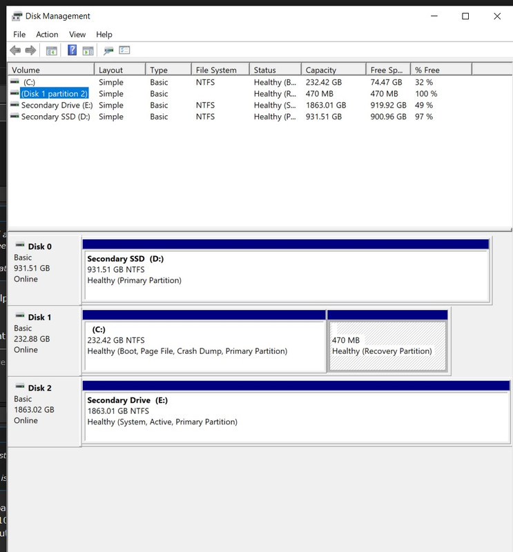

Unless its anyting to do with that random Disc 1 partition 2???? I dont know what that is? (highlighted blue)

Because of Microsoft being such crap at making good software Windows will definitely install itself all over the place, if you have multiple drives connected when you install it.
That HDD has partition which is marked as system+active partition.
That tells Windows installed part of its boot data to it.
Drive not involved in Windows loading process has only that "Healthy (Primary Partition)" marking.
You need to repair boot data with only OS drive attached.

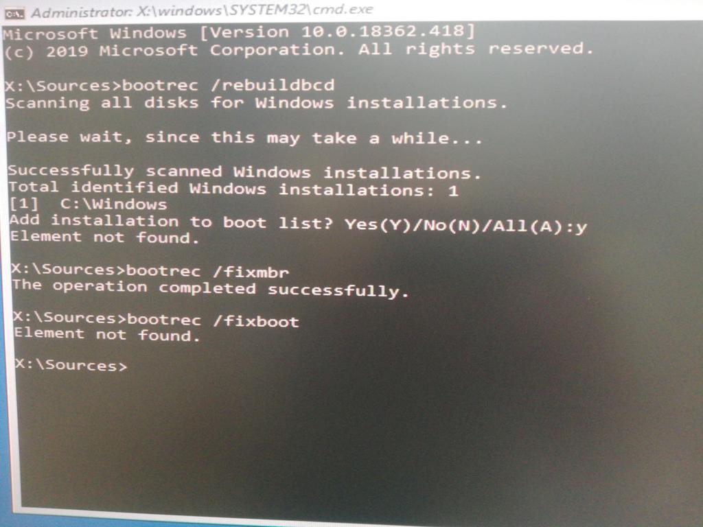

Open Command Prompt from Windows installation/repair and use bootrec
https://support.microsoft.com/en-us...the-windows-re-to-troubleshoot-startup-issues
These should be make Windows bootable when SSD is only connected drive:
bootrec /rebuildbcd
bootrec /fixmbr
bootrec /fixboot
Hi thanks, I tried the below both with JUST the smaller SSD connected and also the secodary mechanical, same result both times. Still getting the no boot drive found message if I try and boot windows with just the SSD connected after doing this.
