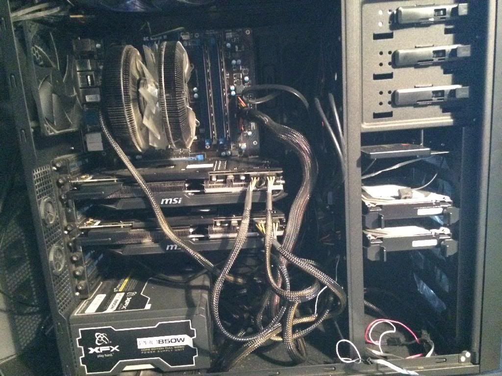

I've been thinking about replacing the case on this machine for a while now and I just realised my top GPU was sitting at 80 while I was playing Dark Souls earlier so its really got me thinking it has to be done now
thats what it looks like inside my case right now. I have 2 120mm intakes in front and another 2 on the side, 1 200mm and 1 120 on the rear as outgoing air. My GPUs are MSI gaming Edition 290s. First problem is I ended up with a non modular psu. So thats a pain. However my plan was to buy a 540 air and some extensions so i can stick that psu in the back and only have the leads I need coming through. Then have 3 120mm fans in front and one in the rear. Now my CPU cooler Is doing a decent enough job I think its at 4.6 and sits around 60 but would an AIO water solution help to keep my GPUs cooler because theres less hot air being dumped into the case.
Whats the best course of action here that isnt a full waterloop as thats going to go far over budget. Ideally id like to be in the £300-£350 region to fix this.
It also needs a dust. Thats my job on saturday.
The problem with flipping them to exhausts is that I can't get them back out the side window. They were a nightmare to get in and I've threaded a couple screws. I could probably do something with the psu if I got some extensions but due to the length of the cables I can't really do anything just now.

What case is it?
Unless the routing holes are weird or there's little/no space between the mobo and the side panel, you should have enough cable length to make it work :)
As much cable management as you can round the back panel, then zipties for the cables left on the front. Moving the harddrives to the very top and very bottom may help the front intake and then go round your whole PC with the hoover to take up all the dust
Case wise, something like the corsair 540 air would be ideal. No obstacles such as hdd trays to block airflow. Separate chamber for the psu which will aid cable management.
In the meantime, id suggest putting your hdd's lower down, try to manage cabling a bit, remove pci plate covers to aid airflow between the gpu's.

its an Antec 1100. I have tried putting all the cables through to the back and then pulling them back through but both power connections on the motherboard seem just out of reach. I will have another attempt as I havent for a while as I couldnt see how to make it reach but I might be able to sort out some of the GPU cabling at least. I will be getting all the dusting sorted out as soon as I can.
You can get extension cables for the ones that don't reach the motherboard
Which case fans do you have exactly?
Stock at the rear spectre pro 200mm on the top and 4 antec tricool at the front and sides. Can only have them set to medium though as high is just far too noisy.
If you can get the side fan out, even if you end up threading the thing, something like THIS will let you remount it the other way round. It made a big difference to mine when i did that.
Did that to it. Ran Furmark and ended up with my top GPU at 90 after a short time before I quit the program. Its annoying I cant put my GPU's further apart as thats something else I think I need to do. Will a 540 and some new fans help much? Ill get the dusting done tomorrow I reckon

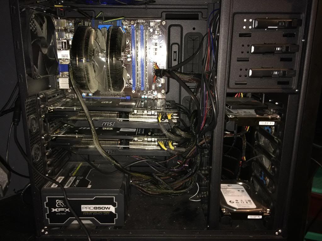

Had a quick session in Dark Souls and temps were down to 67 on the top card! I need to have more extended sessions to make sure but it was hitting 80 quite quickly before.
Use msi afterburner to create custom fan profiles so that fans kick up hot ithe cards get...can get noisy sure but keeps the temps down.
Def need to try to get all those cables out the back and in again so that air can flow properly.
Dust on cpu cooler too btw :)
PCIE plates still there too i see.
If you are happy to butcher your case then you can remove the grilled bit behind exhaust fan...makes a big diff to the air it can remove...just don't do with motherboard in and get metal bit in the case!!!
Yeah I haven't had time to do a proper take apart and clean. Maybe tonight though. I do have a custom fan profile set up but I'm going to try sorting out the cabling before I ramp it up to save on noise. The CPU cooler is a nightmare to clean I think I need to try and get some cotton buds or something to really get into it.
