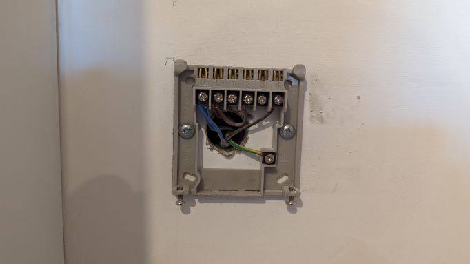

Bit confused with this one. Just got an apartment and want to replace the wired thermostat (Boss) with a Nest. I ran the compatibility checker online which just asks what heating type it is, whether the existing thermostat is wired etc, and it says the Nest Thermostat E is compatible. But when I go through the setup via the app none of the wires match and it says it's not compatible.
If that's not clear the terminals across the top are N L 1 2 3 4 with Earth bottom right. It's pretty simple wiring setup that I'm sure I've seen before when fitting my previous Nest Thermostat.
Any advice?

High-voltage wires
If your thermostat is labeled 120V or 240V, or has thick wires with wire nuts, or has L1 and L2 terminal blocks, your system
is high voltage and isn’t compatible with the Nest Thermostat.
Your original thermostat is 240v and going off the nest thermostat it won't work.. there are other nest thermostats with a receiver that will take 240v and a switch wire and a separate nest thermostat with its own power supply via transformer plug.
wire in the L N into the receiver, that should be near the boiler and connect the wires from the source of the original thermostat into the low voltage parts of the receiver then you'll be able to wire the original wires for the thermostat into a standard nest thermostat, just two wires. hard to explain on here.

Take the two blues (N), join them together in a block connector, not connected to anything else.
Do the same for the single earth wire.
Remove the brown link from L&2 and discard.
Take the brown from terminal 1 and connect to C at the Nest.
Take the black from terminal 4 and connect to NO at the Nest..
If you need any help just message me and I'll guide you through it m8, I do this for a living :)
Thanks, I'll give this a go.
