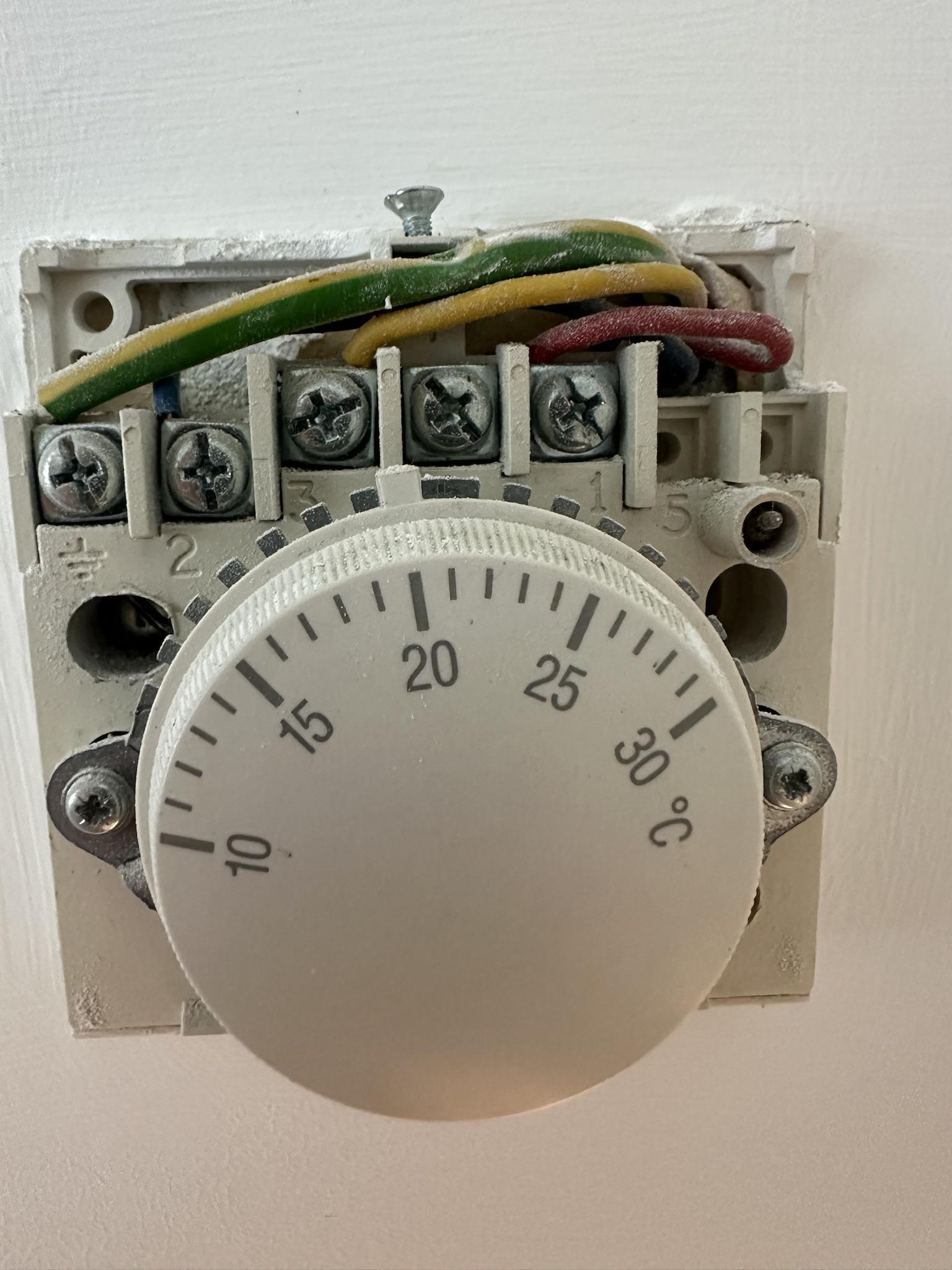

The thermostat is wired as below:

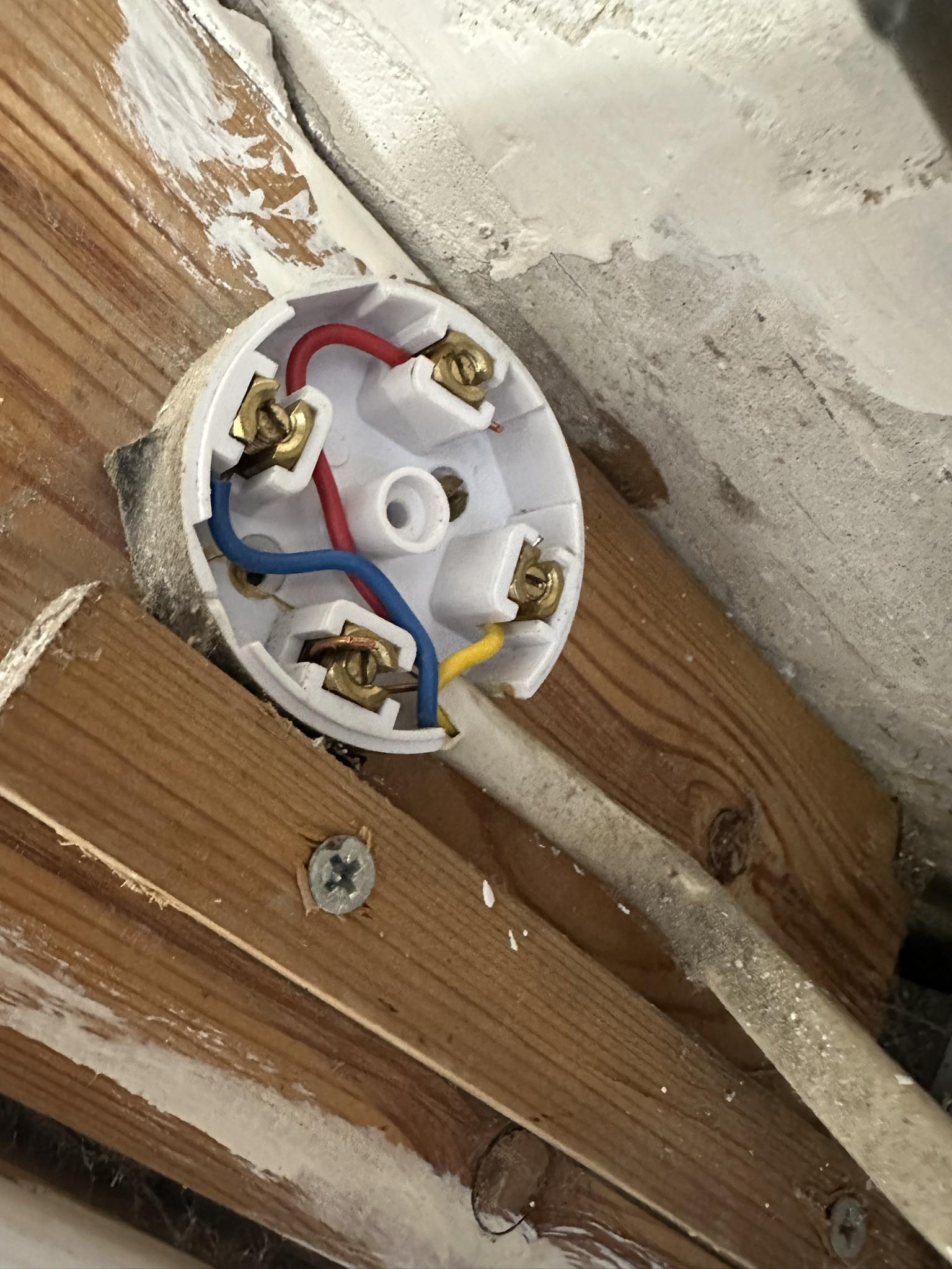

And there is a connection block just under the boiler that I am assuming are the wires that go to this stat:
Questions:
1. The Nest requires just two cables connecting to the home link - no 240V. When I put my voltage detector on the cables at the stat or at the connection block it glows as if it’s powered, but when I try my multimeter on it I get no voltage…
In a perfect world, I could just use the red and yellow cable and connect one end to home link and the other to the Nest, but I am concerned my voltage stick is picking up power - should I be concerned?
2. Is there any way I can determine that the cables coming from the stat and the cables coming into the connection block are connected? They are in different rooms across the house.
3. If these cables to the T40 have 240V running through them, what is my alternative? I really want the Nest wall mounted and want to avoid buying a stand.
