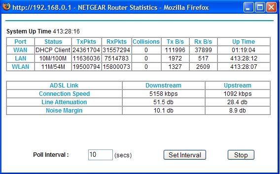

Bet no-ones as bad as mine.
IP Address:
78.86.105.166 (BE UN LIMITED)
Last Test Date:
6/9/2008
Total Tests Taken:
5
Fastest Download:
5041 kb/s
Fastest Upload:
994 kb/s
Average Download:
4332 kb/s
Average Upload:
795 kb/s
No idea how to check attenuation on a Netgear DG834PN, but i'm miles from the exchange. I was getting 2 Mb on BT 8Mb.
