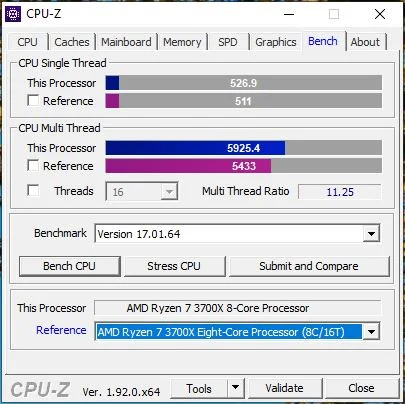

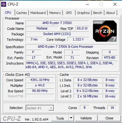

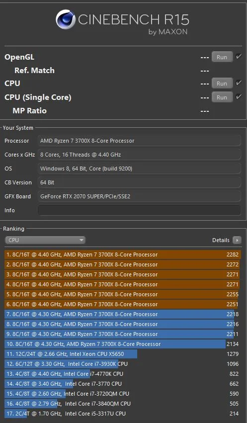

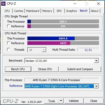

And after having a play around with overclocking a Ryzen for the 1st time I'm getting the following;
4.4Mhz on all cores at 1.332v, CPU idle temps are around low 30's degrees according to HWiNFO.
CPU-Z benchmark score of 5925.4

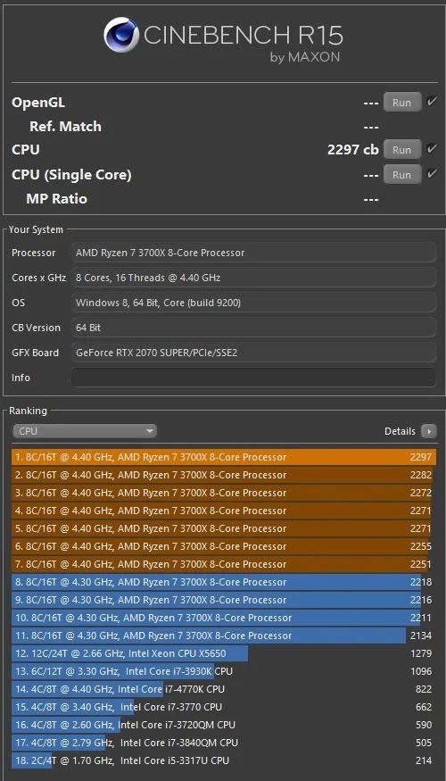

Cinebench R15 score of 2282 using (with a max temp of mid to high 60's)
I've tried pushing the CPU to 4.5Mhz, but it needs a lot more volts and the max temps hit low to mid 70's. Should I just stop where I am?
Having run the DRAM calculator, I've adjust the RAM timings and got a Cinebench R15 score of 2297 (up from 2282).
RAM timings before;
16, 16, 16, 16, 36
RAM timings after;
14, 14, 14, 14, 30
It would normally only boost to that on a few cores with heavy multi core workloads dropping to low 4s so being able to get 4.4 on all cores is a very good result.
Maybe I just struck abit lucky with the silicon lottery lol.
nice results that pretty much the same as my 3800x
think I got the vcore at 1.28v at 4.4 but wasn't avx2 stable and wouldn't do 4450/4500 at all no matter the vcore upto 1.38/1.4
Nice result!
How simple was this to achieve? just ratio and voltage or 101 other settings too? (My last overclocking was back on 9600k-9700k)
Nice result!
Was very, very simple to do (was just ratio and voltage, and hard setting the memory timings.) Far easier than the 2500k which was the last CPU I overclocked....which was years ago now lol.

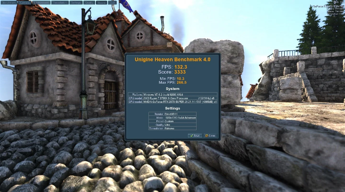

I have run the Unigine Heaven 4 benchmark this morning, after upping the GPU speeds from;
GPU Clock: 1680Mhz, Memory: 1938Mhz, Boost: 1860Mhz
to
GPU Clock: 1715Mhz, Memory: 1950Mhz, Boost: 1895Mhz
And got the following result;

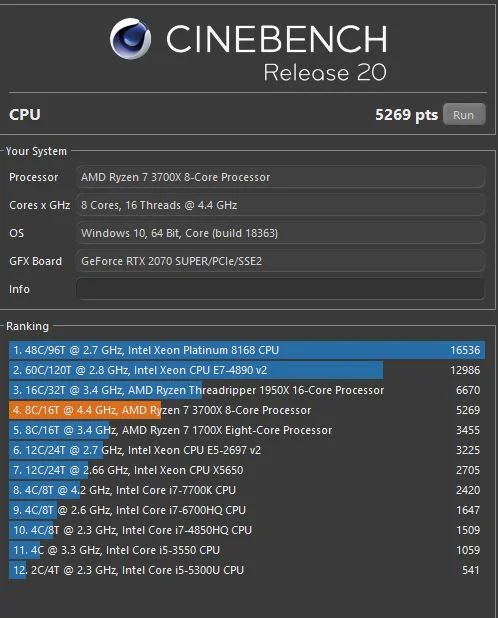

i get CB20 score of 5192 at 4.3Ghz and 1.28volts can do 4.4 not AVX stable like you but for the temperate difference i keep it at 4.3
to
what was your score at stock gpu speeds?
Is 1938Mhz stock for the gpu ram or is it 1750Mhz?
