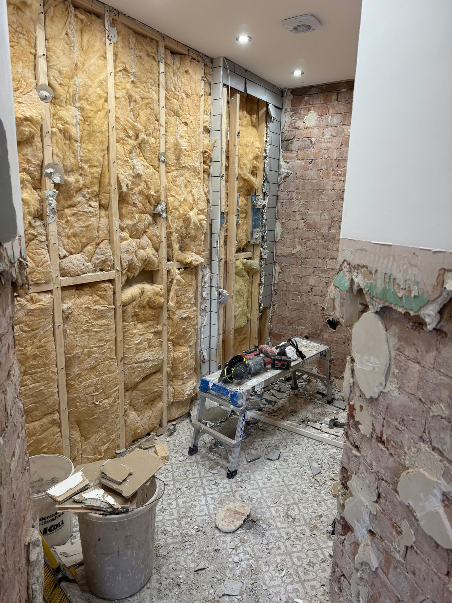

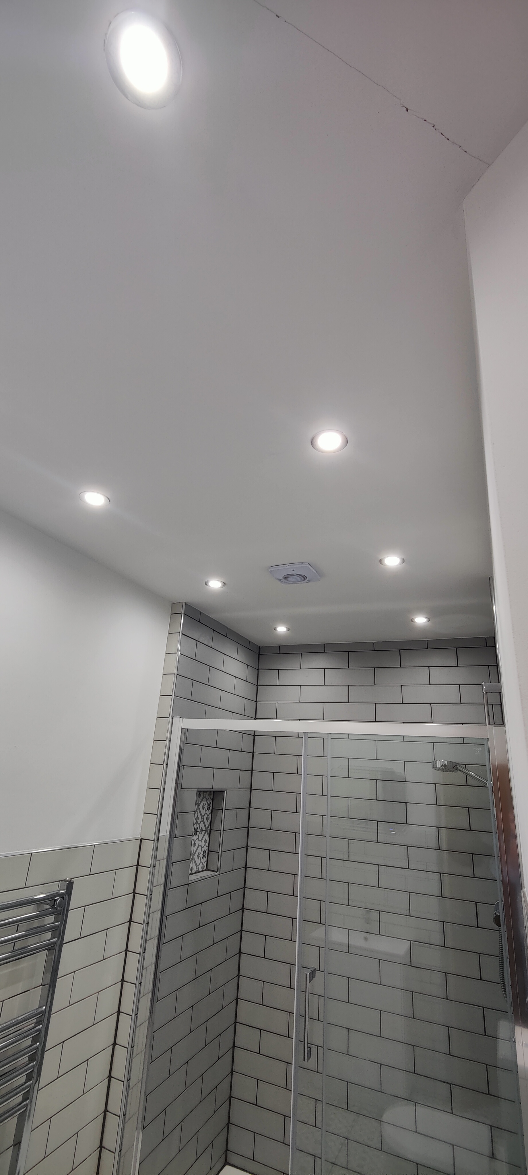

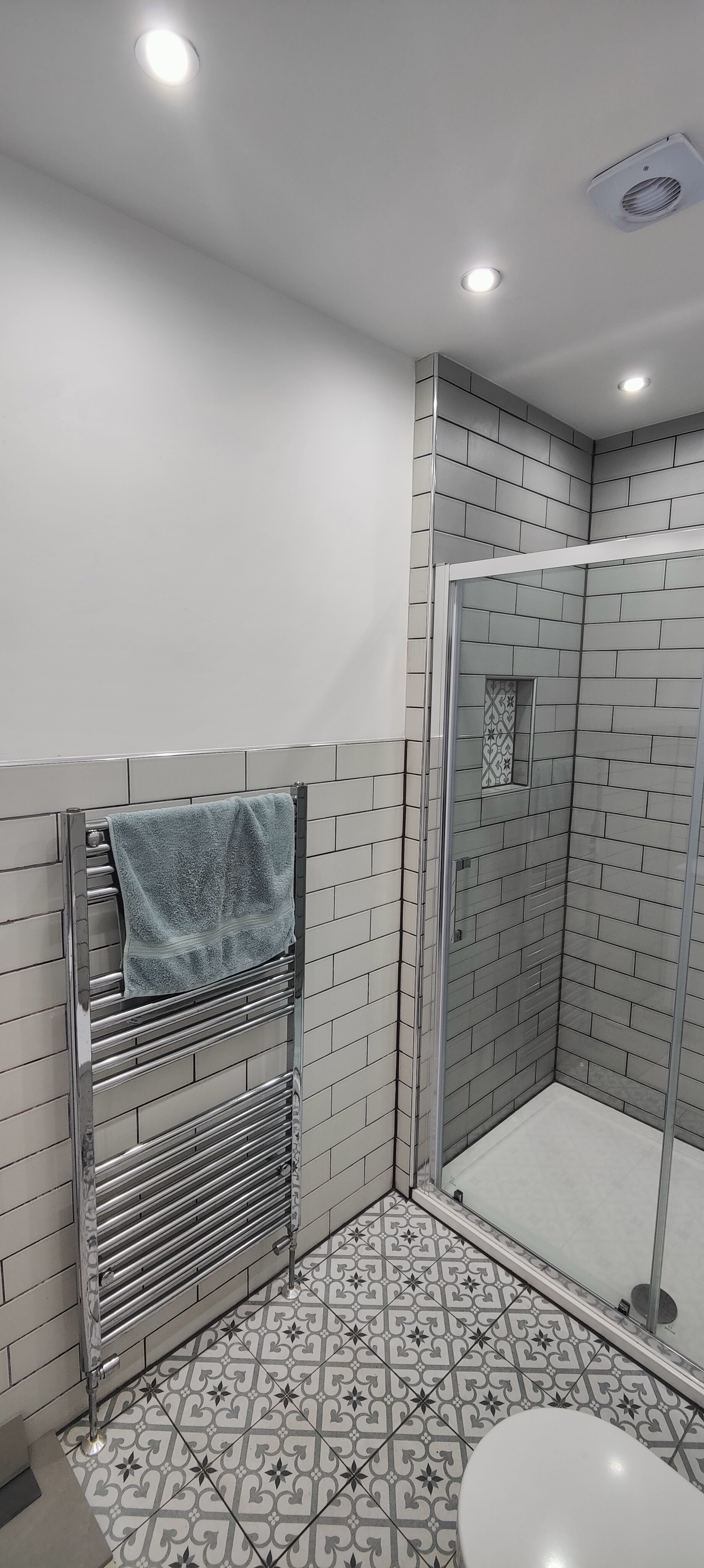

Before

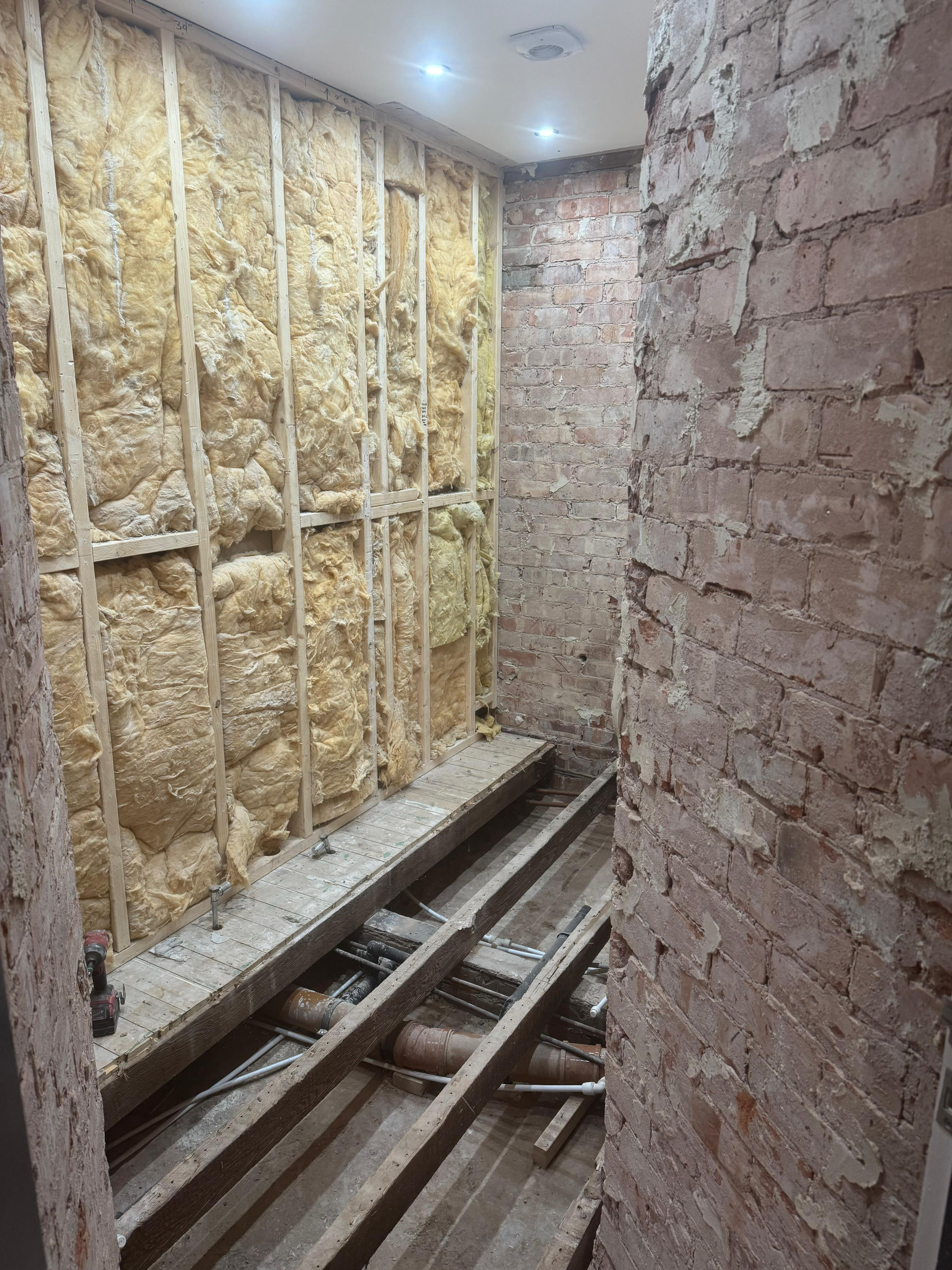

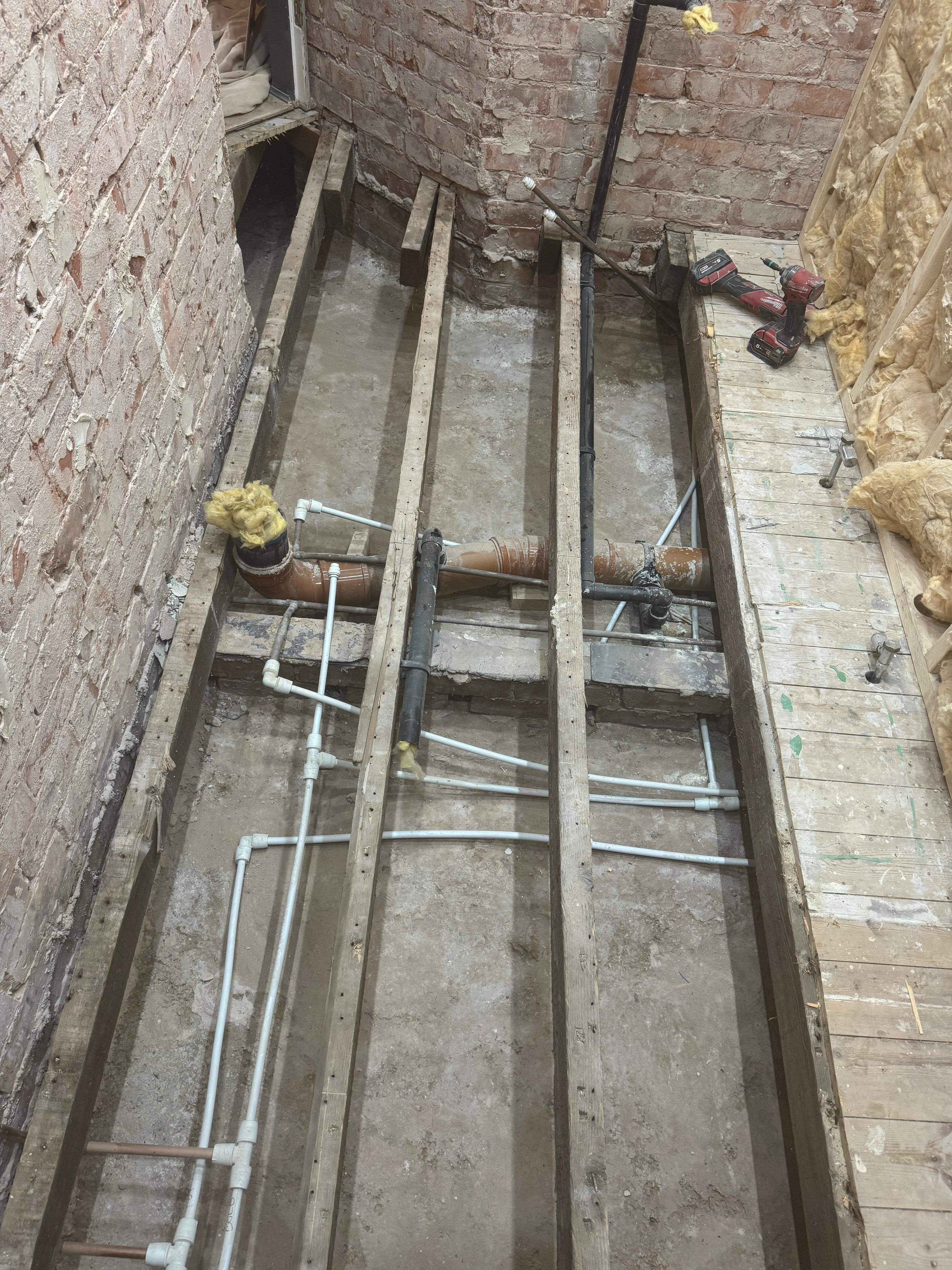

During (well after strip out)

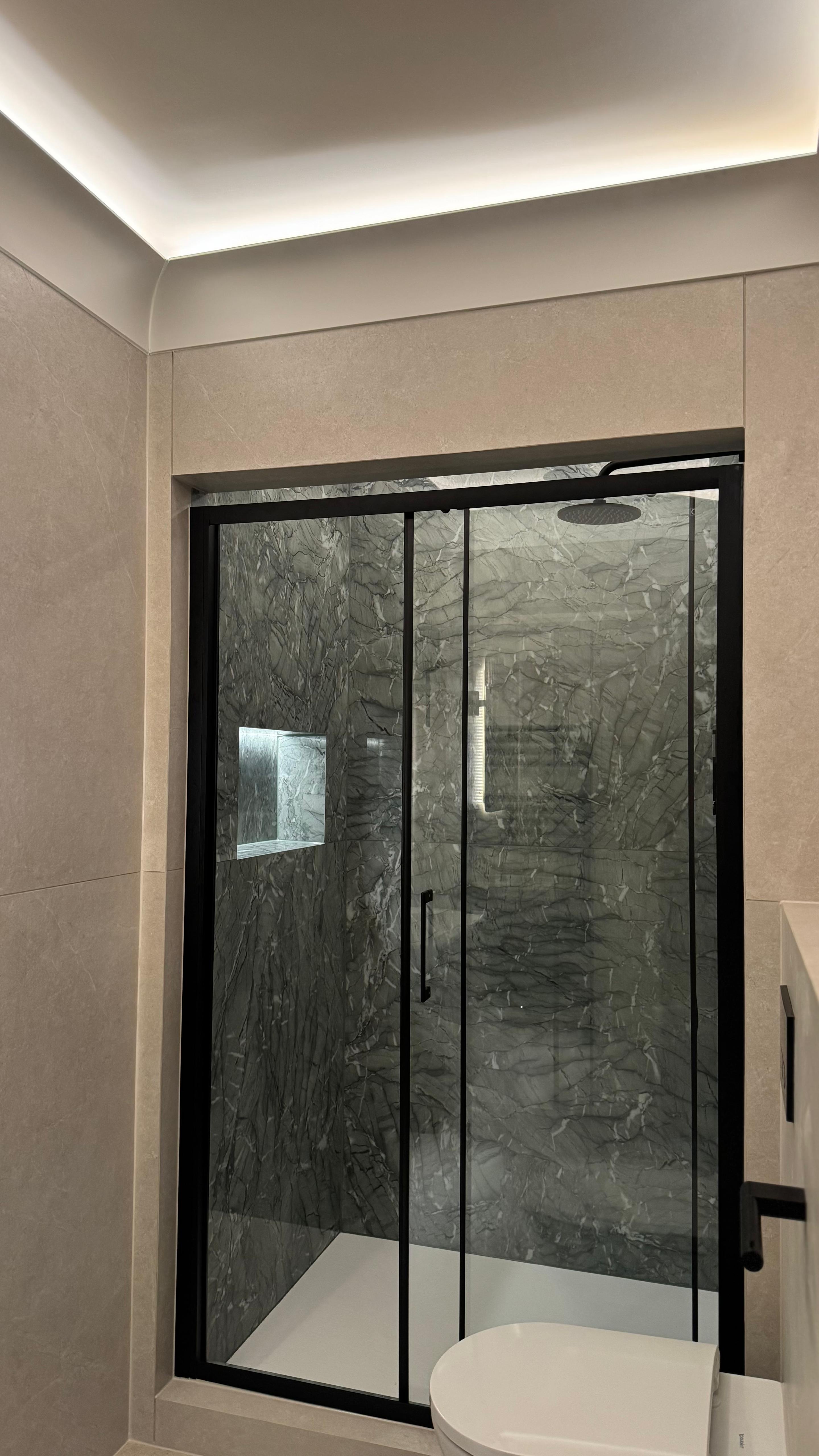

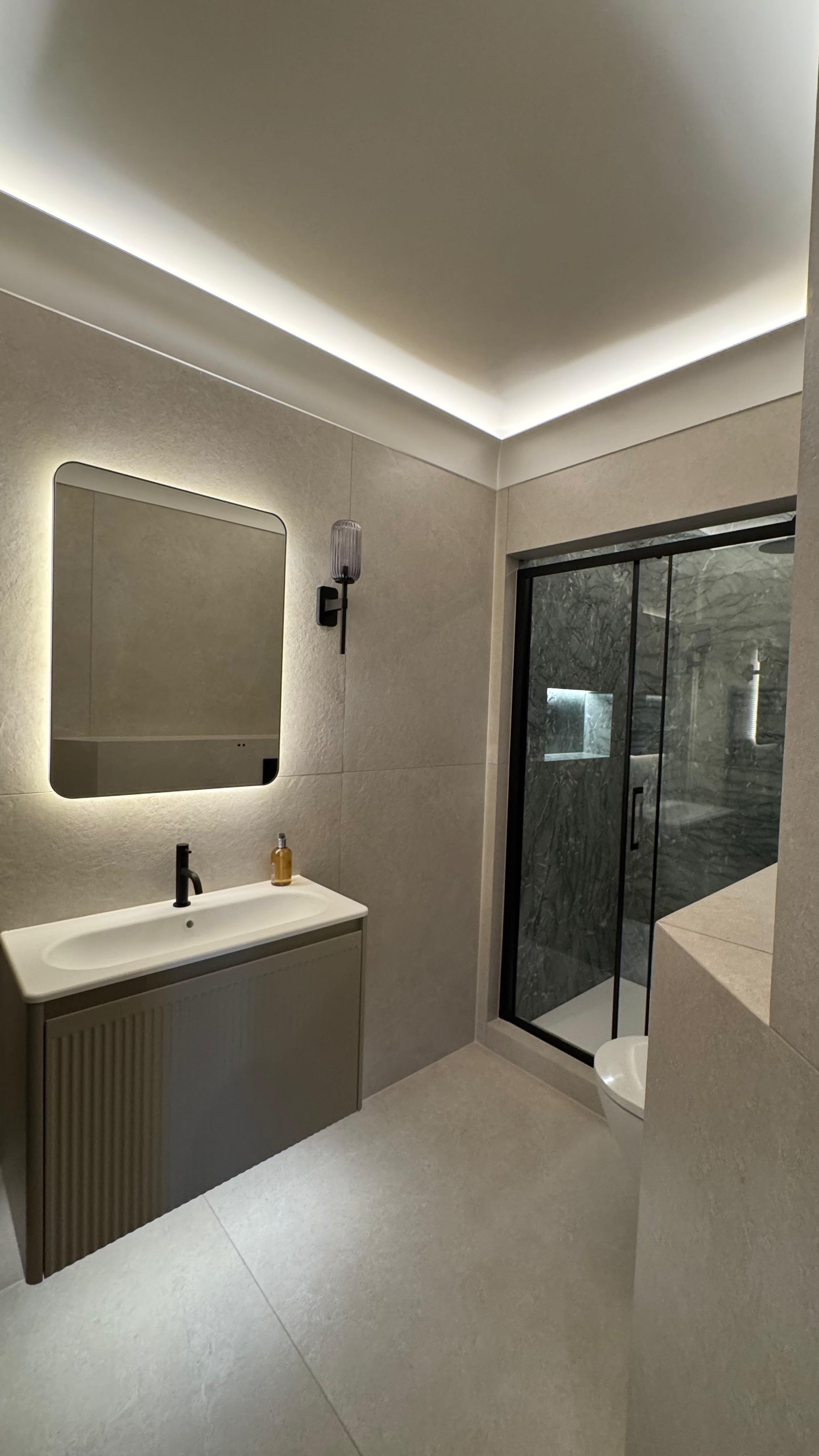

After (competed today) and over the moon with it
Thanks :)

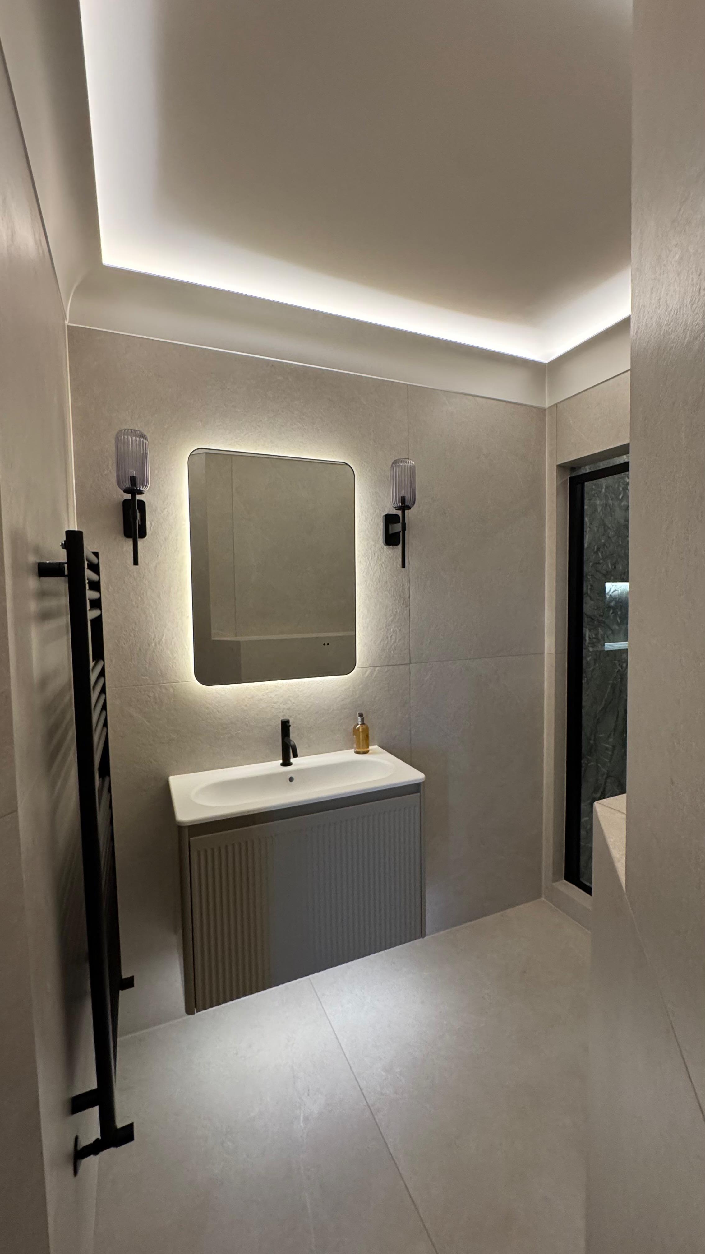

It was "ok" but the original tiler hadn't done s great job, Mrs TB never liked the grout colour

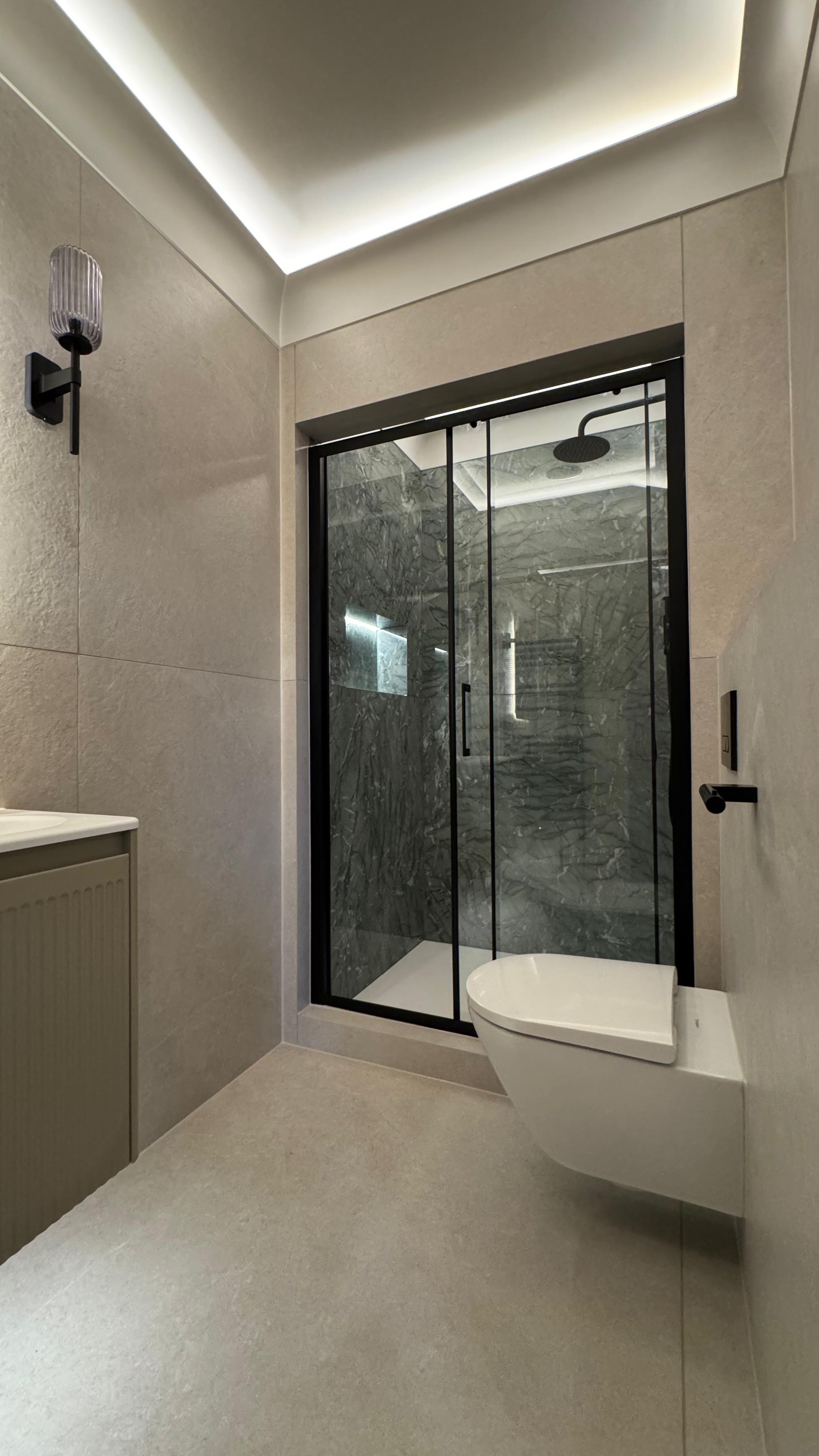

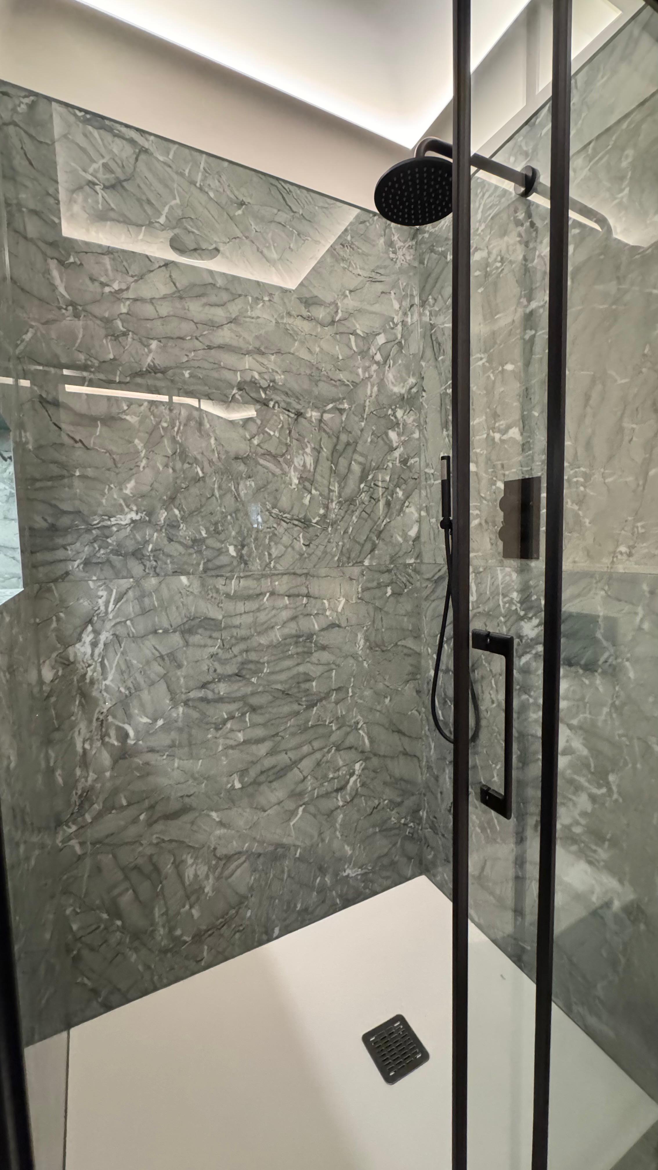

We're over the moon with it and love the halo ceiling and gesture controls on the mirror lighting
Can't wait to test the plumbing in there ;) :D
Was like that's nice and then it became even nicerer :D

All in it was around 16k which I was quite honestly shocked at but when broken down it was
Tiles about 2.8k (c£77/m2)
Fixtures and fittings 5.2k Inc shower tray, screen, shower, wc, vanity unit, mirror, lights, and coving

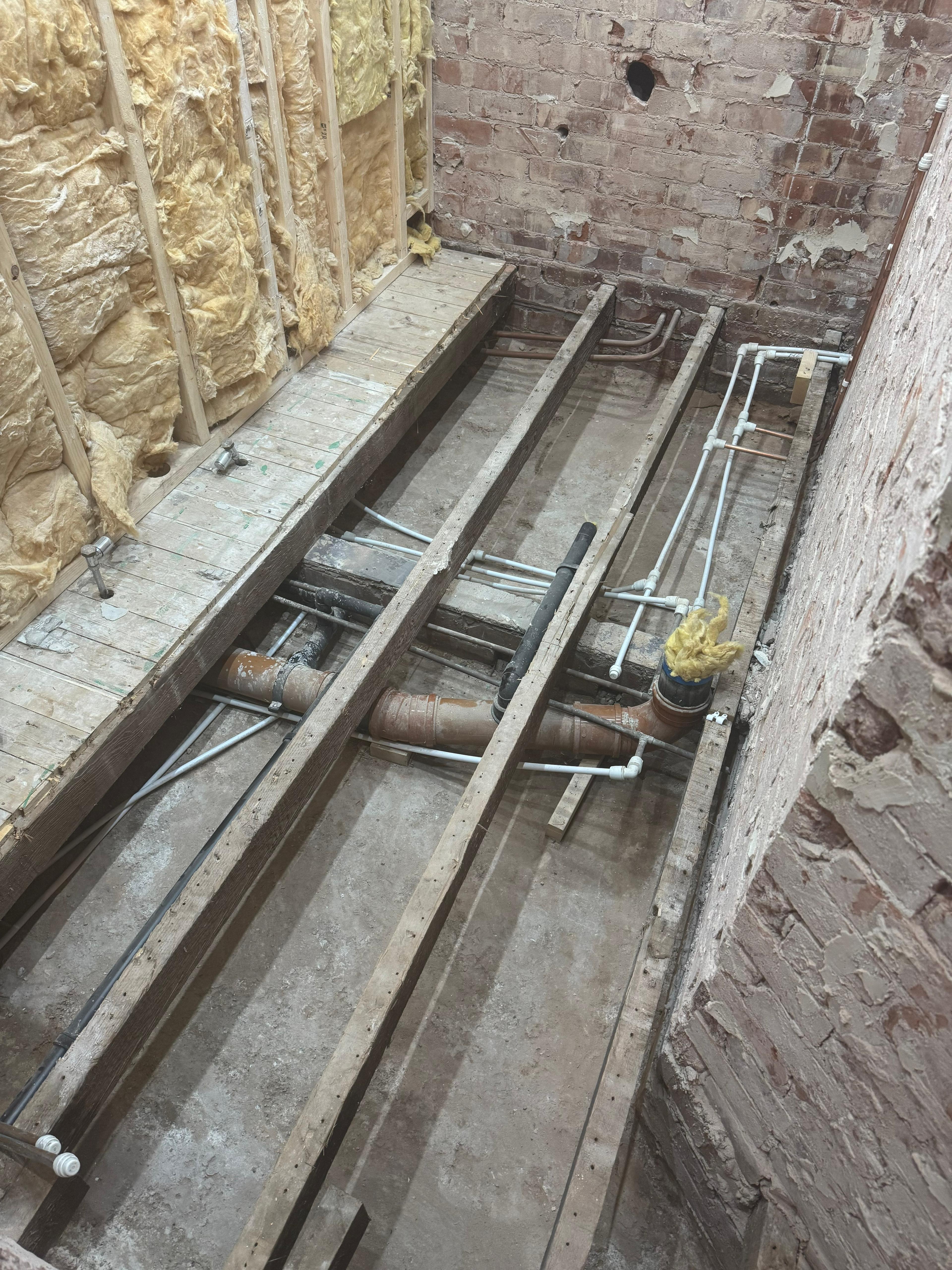

Labour and materials 7.9k which was a full strip out to
bare walls / studs and joists, all new pipework and wastes, framing out, flooring, boarding the walls and over boarding the ceiling, waterproofing, tiling, grouting, resin and silicone, the LED strips and driver.
A good 1200 of that was to have all of the edges mitred, filled and polished so there is no trim anywhere and the joints between the tiles are colour matched with resin and polished to give a smooth edge and "continuous" finish
All prices are inc VAT
It's a lot of money but the main downstairs bathroom and the finish is fantastic
There's a lot of tiles (about 40m2) and the fixtures and fittings are in the higher end / price, but we didn't want to scrimp
The fitter was, honestly, an absolute star, his knowledge, attention to detail, passion and pride in his work was phenomenal and the quality shows that

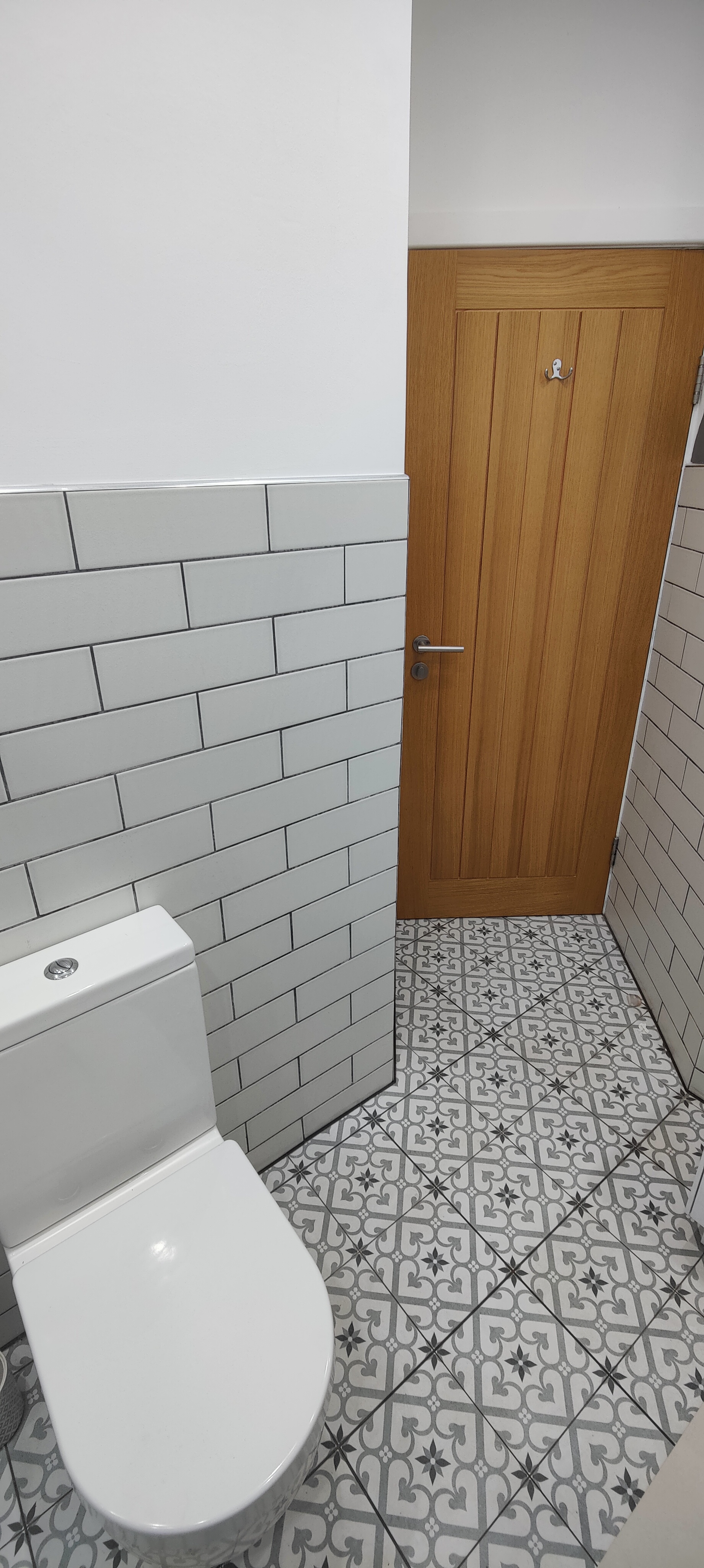

This is about 1/2 of the original (only) bathroom when we first moved in. We split it in two and the other part is now a utility.

Looks much better now. The before image just looks like standard brick tiles and black grout, pretty horrible IMO :p
Thanks and ha, yes, the Mrs never liked it from the day it went in :D :cry:
It was never the finished product so we went cheap and cheerful when we had the work done to split into a utility room and downstairs bathroom (when we had the loft conversion done)
The quality want great and threw ideas together. Getting someone who knows what they're doing with the design, spec and install makes the world of difference!

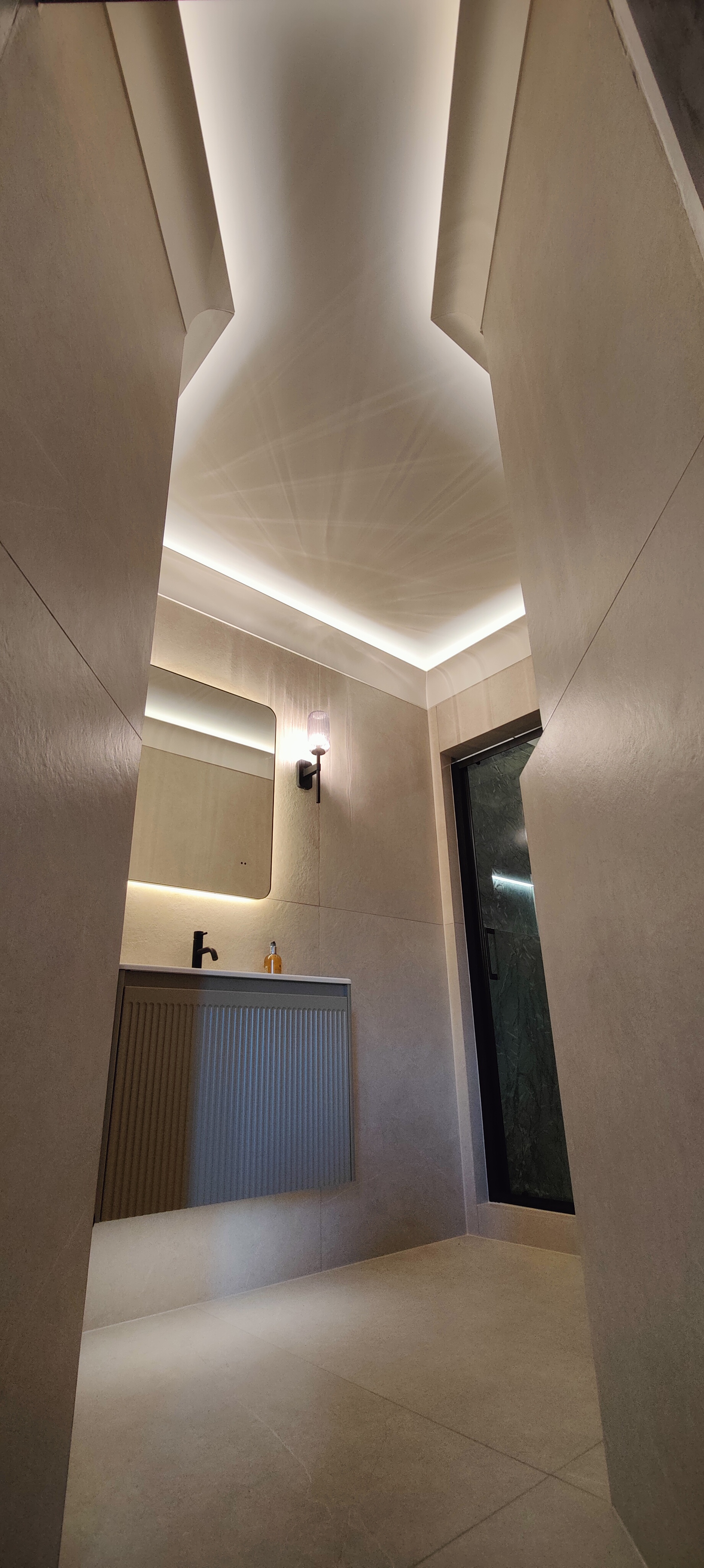

There is no natural light as a fully internal space but the photos are deceptive. It's quite bright. The LEDs and mirror lights are adjustable in terms of "warmth" and the LEDs can be adjusted for brightness also
It is (for us) a nice balance of warmth without being too dark, we may adjust the brightness and warmth levels at some point but it's a world of difference to the harsh clinical brightness of the "before" with the ceiling spots
