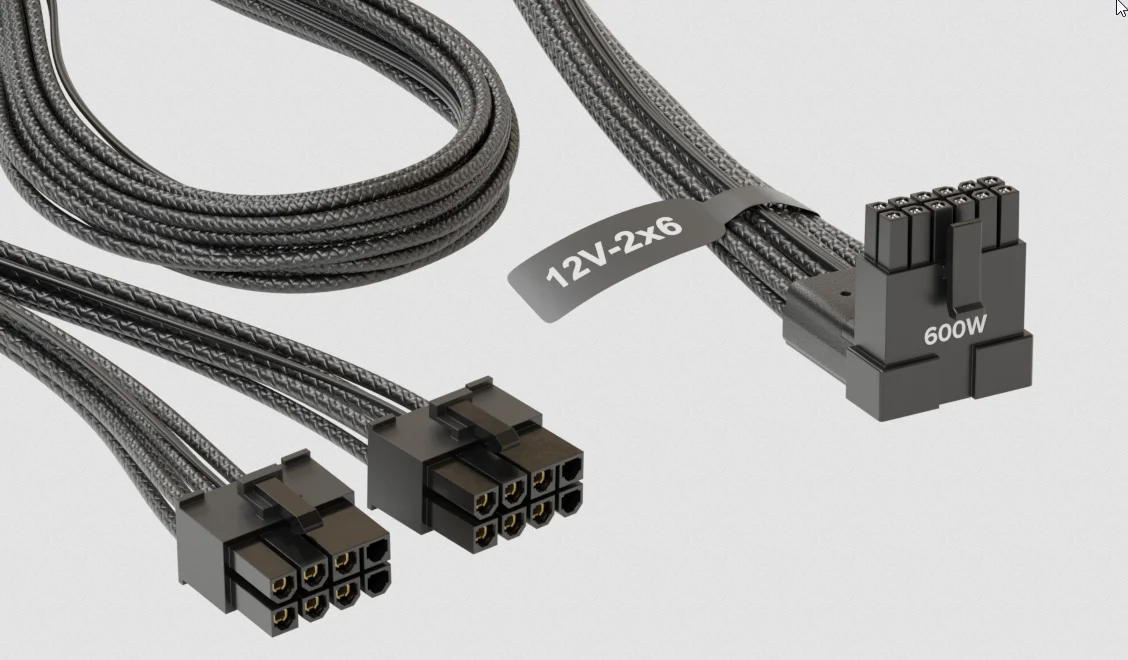

Noticed you can get Seasonic 90 degree 12VHPWR cables. Wonder if this would be better than the normal cable and if it is better than the 3rd party ones?

There is a 90 degree with dual 8 pins, but not sure if it's compatible with your PSU. (think it is) https://seasonic.com/12v-2x6-cable-90-degrees/
Was asking to make sure this is safer than the melting 3rd party ones.

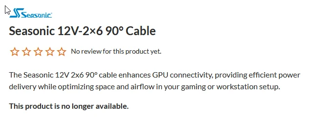

Do you mean this part:
WA2V16881BW
However:
Is that just out of stock due to demand?
Pity as the main image looks exactly what you'd want to not risk bending the cable:
I was able to find it from some 3rd party seller somewhere but unsure I'd trust that as there may be fakes or seconds.
Maybe ask OCUK CS if they are getting it back in stock?
Just had a look and you are right, can't find that cable any where.
Wonder if Seasonic will supply you with one, seeing as you paid so much for the PSU?
