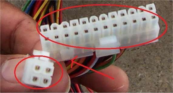

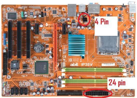

You need 24 pins connected mate, not 20. :) The 4 pin coming off it clips to the side of the 20 to make 24. See pic below.
This pic shows the CPU 4 pin (Circled left) the 24 pin ATX connector and the arrow shows where it splits to 20 pin
There should be another 4 or 8 pin for the smaller socket next to the CPU.
ill echo the previous post. 24 plus a separate 4 which you have connected already
