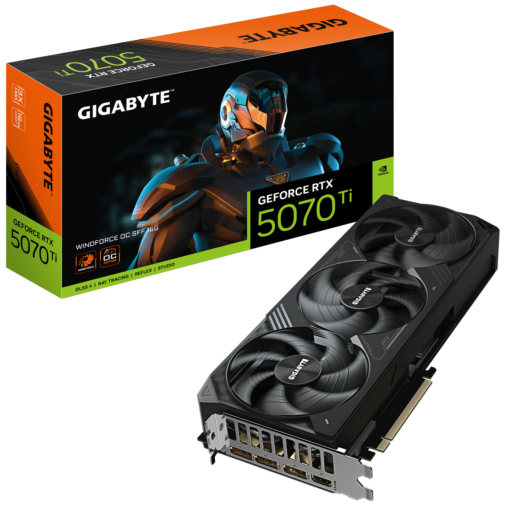

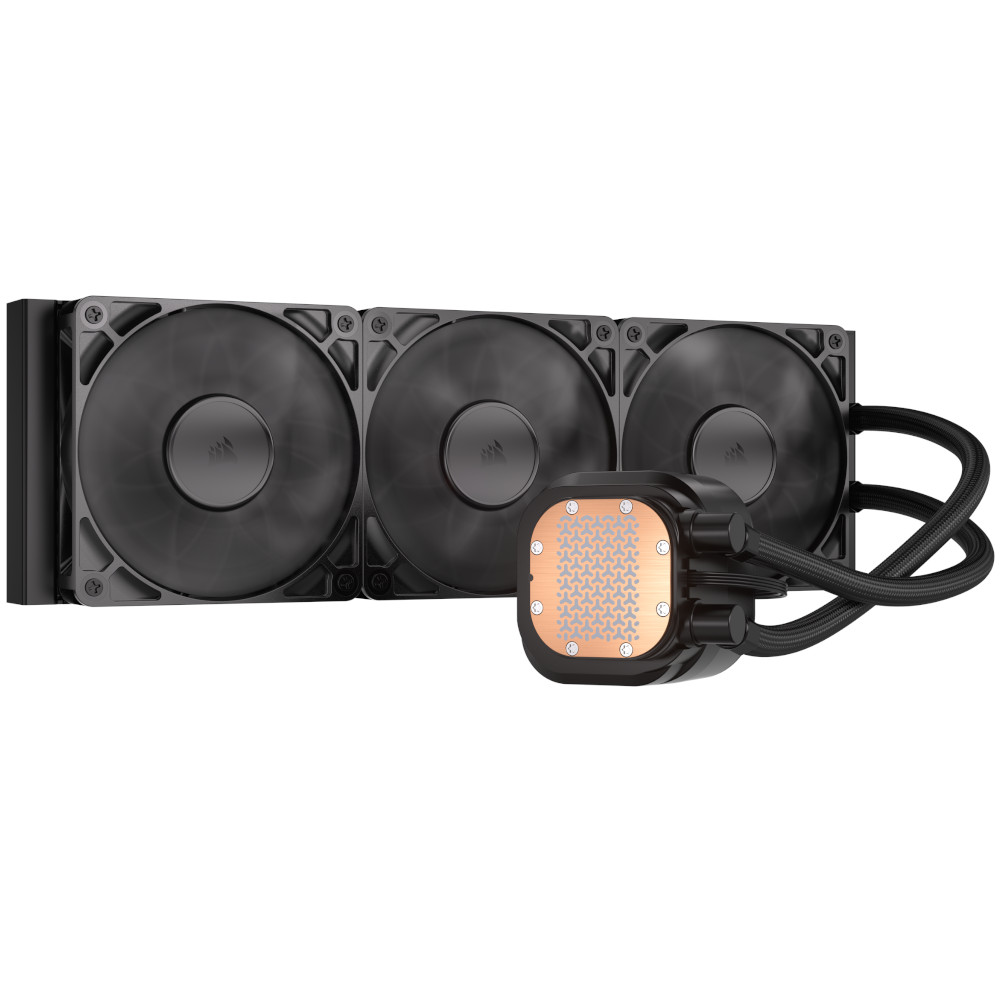

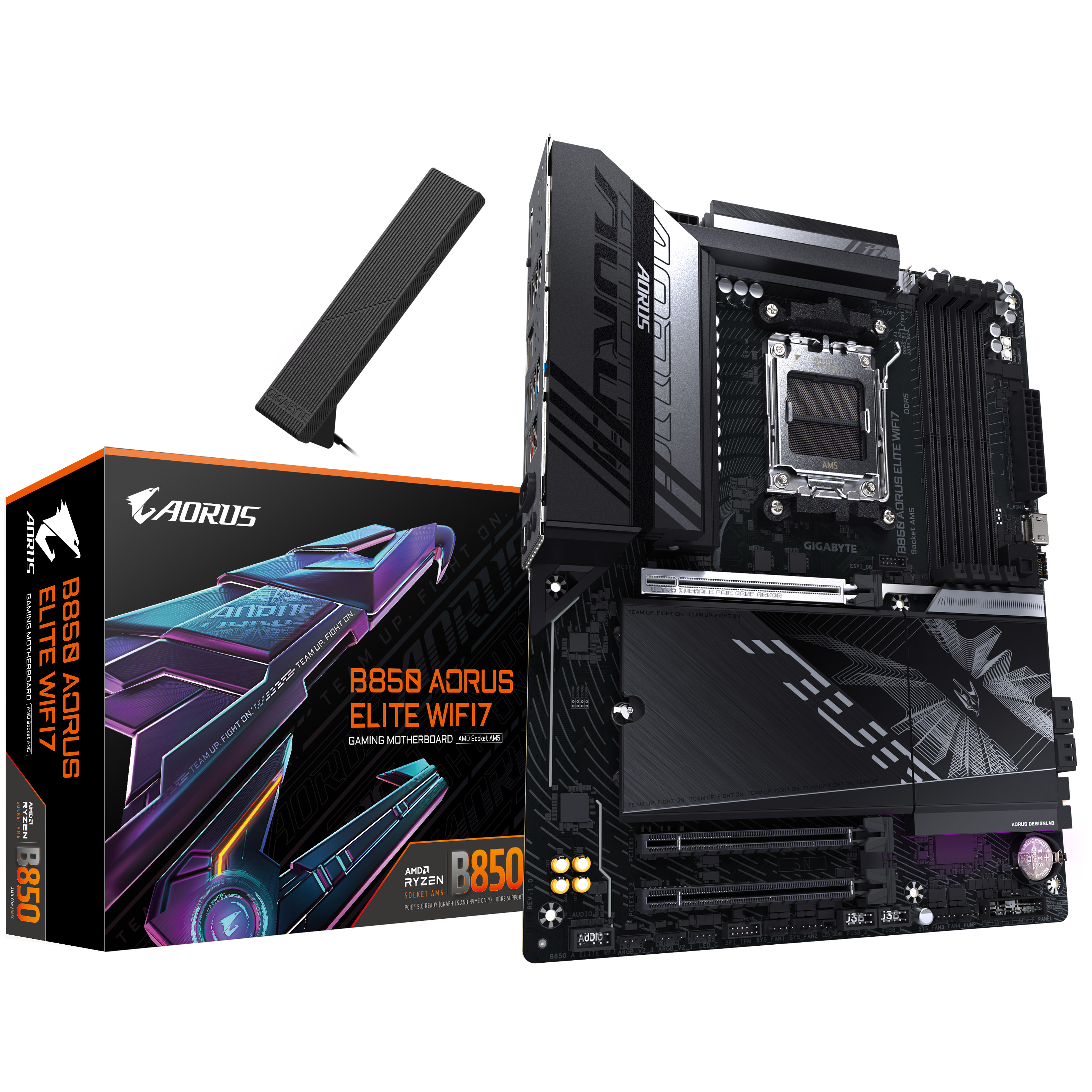

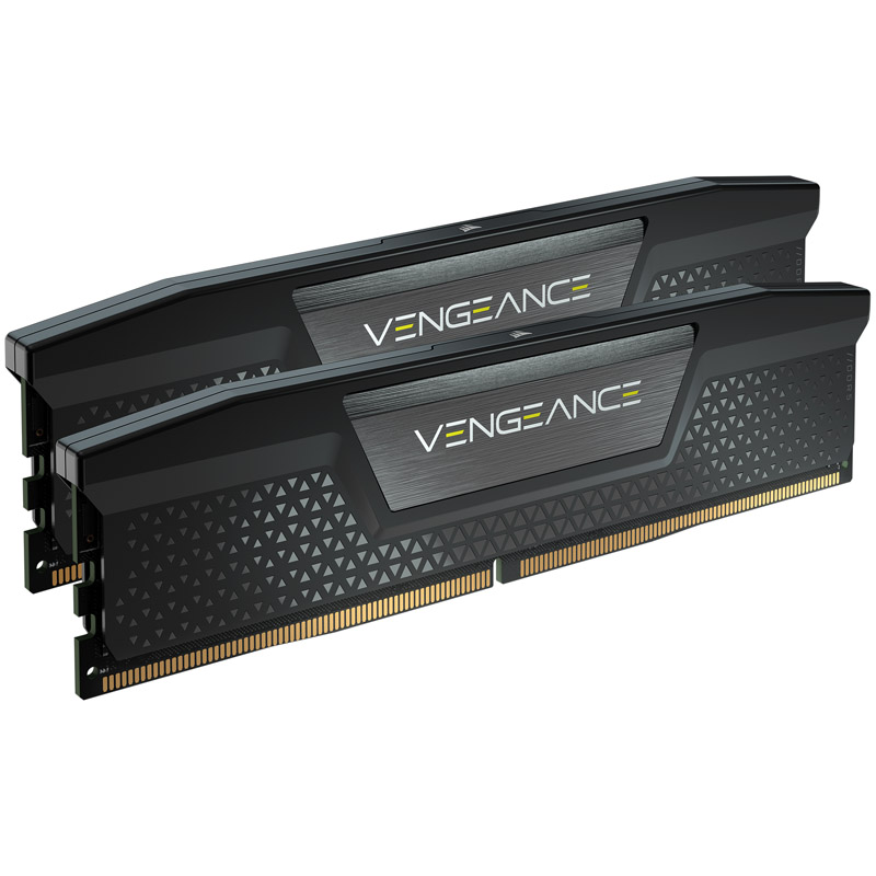

- I'm pretty set on team Blue and Green, so Intel and Nvidia. I also prefer to have as many parts as possible from the same brand, as I feel (perhaps irrationally) that they will communicate and complement each other better. That is why I have chosen both GPU and Mobo from Gigabyte as I also have Gigabyte monitor and why most of the rest is Corsair.

You don't need to match brands, also from what I read Gigabyte use lousy fans in their GPU's.
Checkout 9070XT as well, it fairs well against the 5070ti and is a couple of hundred quid less, although the Nvidia are better for video encoding.

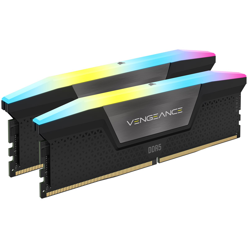

96gb ram for server/database goodness + rgb bling-bling

5080 > 5070ti (obvs)

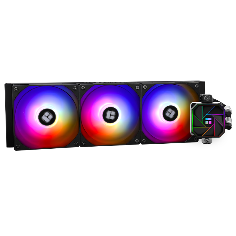

cheaper cooler and just as good, with rgb bling bling

(i've matched the case and the psu, and the mobo to the existing monitor...i hope that satisfies OP's OCD :cry: )

1) not matching the ram to the ssd - the crucial version of the ram is (a) more expensive, (b) slower timings, (c) no rgb
2) not matching the aio to the case/psu - the phanteks aio aren't great. thermalright is (a) cheaper, (b) better performance
3) not matching the 5080 - (a) heck not paying an extra £170/200 just for the brand name lol, (b) zotac have longer warranties - 5 years - if you register the card within the first 28 days of purchase
For the 3K mark you're eking into Nvidia 5090 territory without an X3D chip or 5080 with so it's a complicated budget to work with, at least with a primarily gaming focus. Database/workstation I'd go for a 9950X3D with a 5080 every day of the week.
