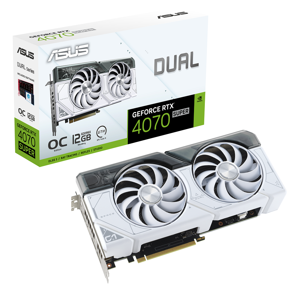

For nvidia, you could also look at Asus Dual White for the 4070 or 4070 Super, MSI have a White version of the Ventus and Gigabyte call theirs Aero. Note that the 4070 Super uses a different power connector to the 4070 and this will either require the use of an adapter (provided in the box), which can be a bit ugly to use, or you get an ATX 3.0/PCIE 5.0 PSU instead.

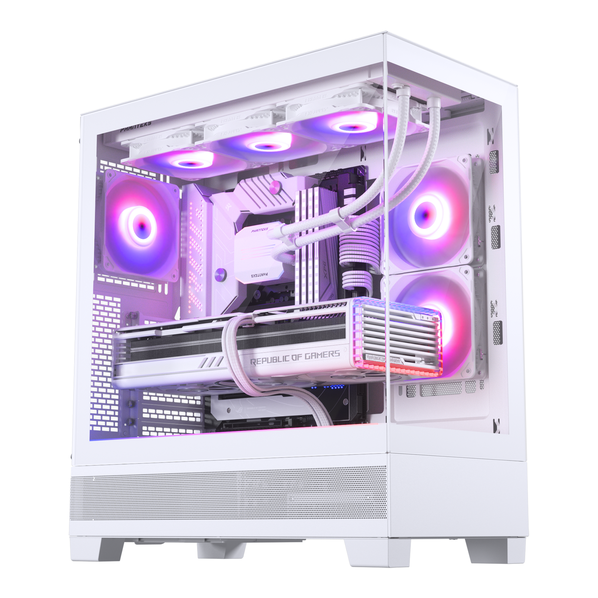

With the case in question you can't see the power supply anyway, HSF is enough for the 7800X3D but you lose the bling factor from the Arctic Freezer III AiO, the pictures of the case shows a triple fan radiator fitted up top, that would be empty space with the Freezer 36.

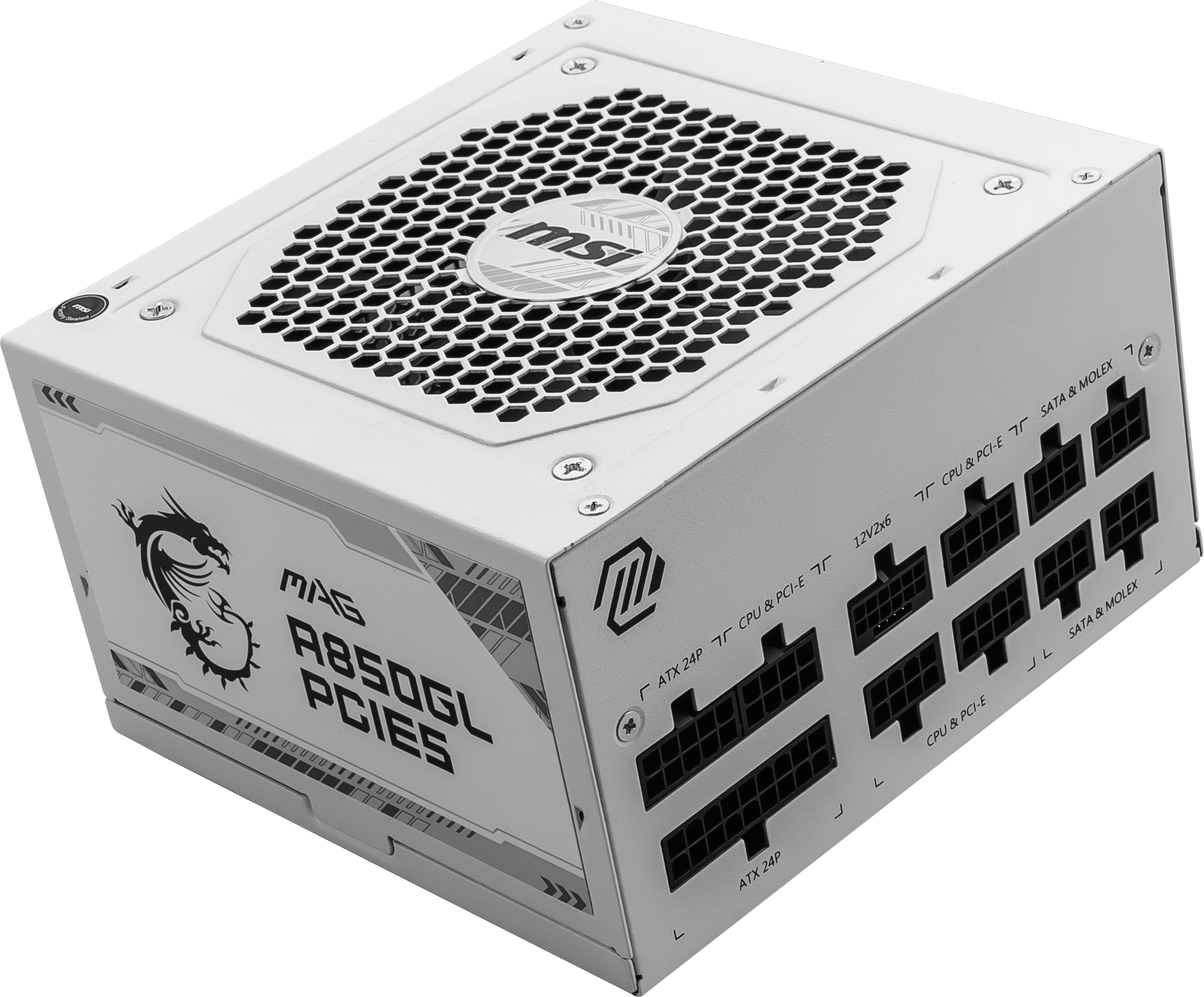

You could also add white cable extensions to the phanteks psu.

are there another black pc cases that would fir with this build (price range) that is glass most the way round.
or some extra fans for the pc case that you had listed.
My basket at OcUK:
Total: £149.98 (includes delivery: £0.00)​
You're generally going to be limited on how many fans are supplied in any case you buy, but I've listed a couple of other options.
The Phanteks is probably the easiest to match fans with however, as it uses the following:
My basket at OcUK:
Total: £16.94 (includes delivery: £3.99)​
So you could buy however many you need, just ensure that the DRGB controller you have is up to the job.
