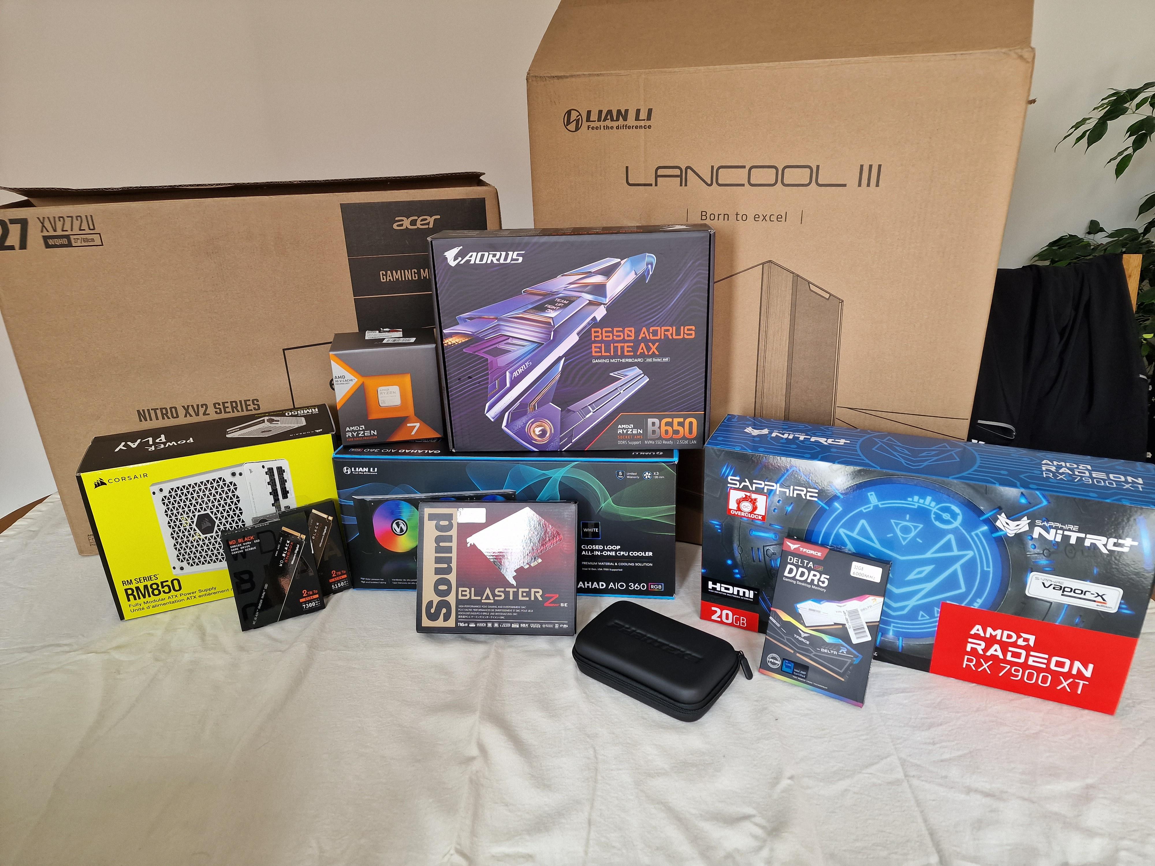

So big thanks to everyone here! You guys made the process so much more amazing with all the help and answered queries
No monitor attached yet as it took waaaay longer than I expected but powered on first go (hoping it POSTs, will find out tomorrow)
