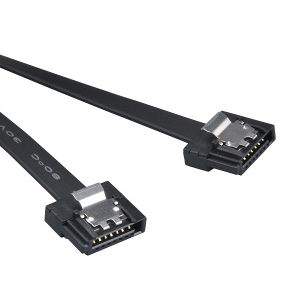

(after 3 SATA cables as my current rig is MacGyvered together as over time I've knackered up several SATAs)

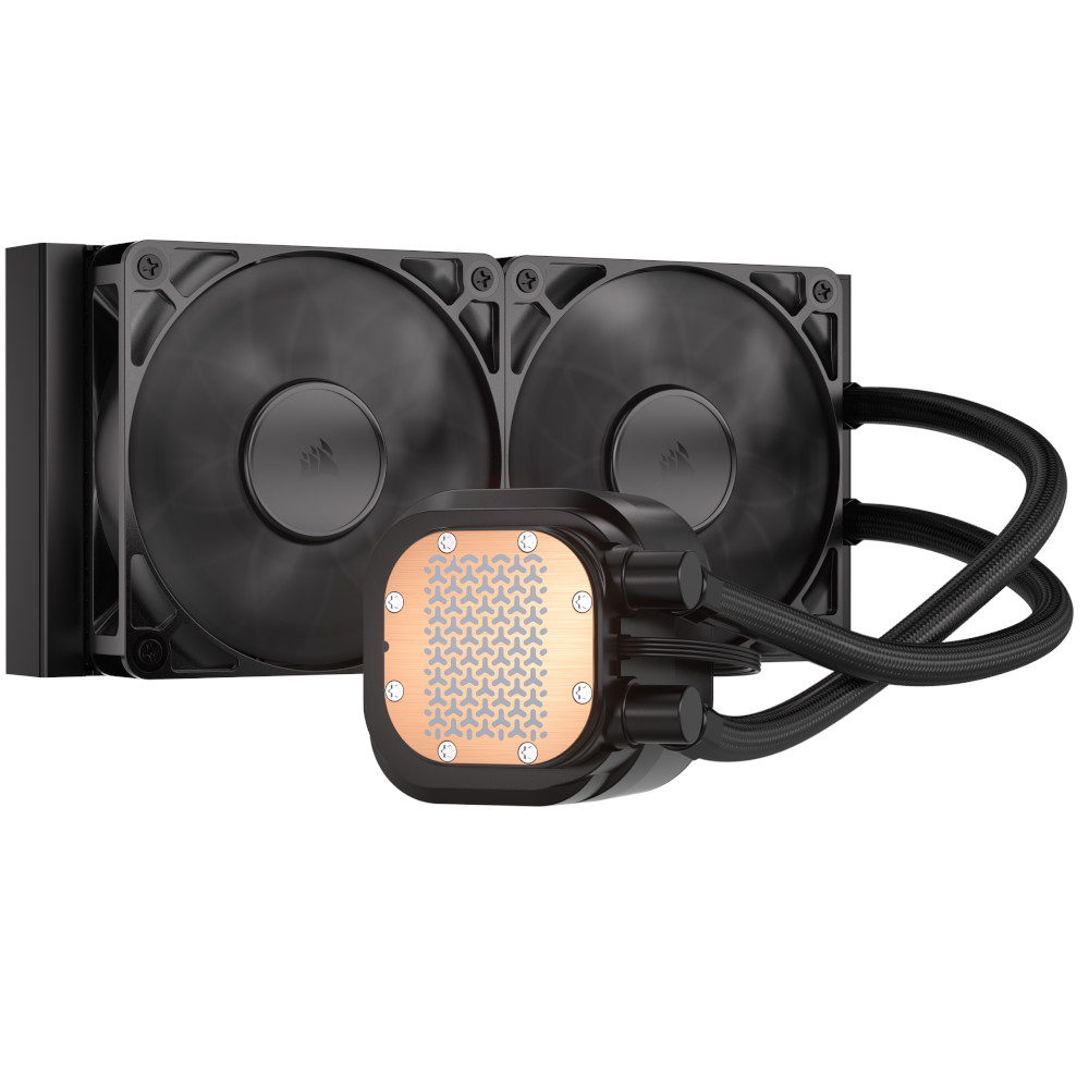

Save yourself a few quid and get yourself a Peerless Assassin for about £30. Ryzen CPUs don't consume nearly as much power as Intel ones do.

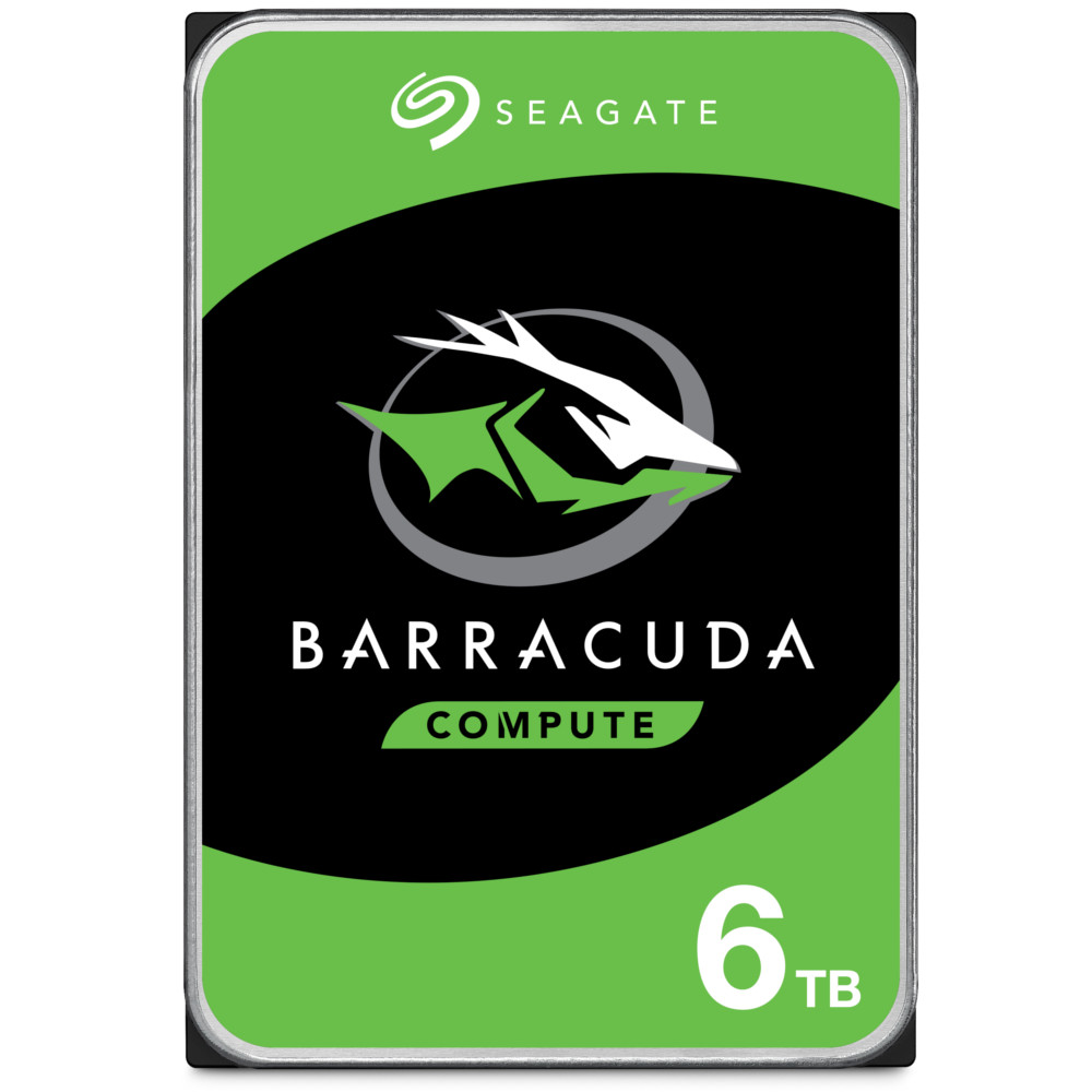

HDDs have little place in PCs these days. Unless you're going to repurpose your current PC as a server and the HDD is going in that then you're better off buying a second NVME or SSD.
I'm assuming you need the HDD for some reason so included it, the case I've listed does claim to have a 3.5 mount but I'd double check if you do opt to go for it.

Much cheaper but still ample HSF.

HDD binned - showing my age there...

Cooler - feels like a downgrade to go back to air only, but hey, ho...I'll take your word that Ryzens are not as hot

All black cooler with no RGB.
